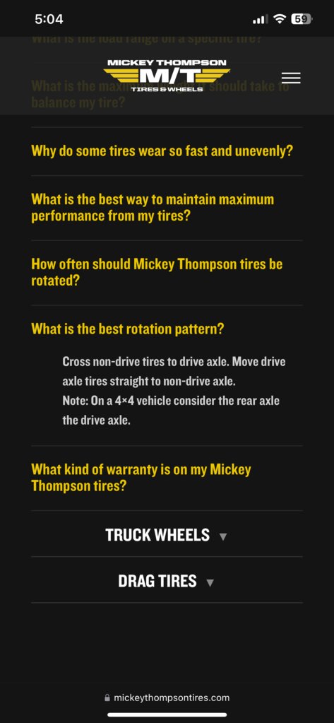

    Every other rotation criss-cross
    I have a couple 800 lb furniture dollys that my 33s sit in perfect to move around and align studs with. That's only thing with Micky Thompson Bajas, you can't criss-cross because of directional tred. I pay someone I trust now. They rotate 4 - 33s for $15 and I give them $20 because I wouldn't do it for $15.
