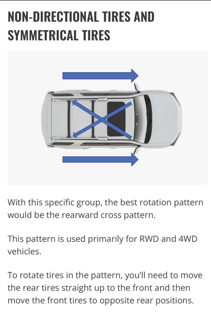

    Does the Toyota Dealer rotate the tires front to back or X pattern? If you do your own how do you do yours? Thanks
  2. Jun 4, 2025 at 6:30 PM
    3,567
    More than likely they don’t use the X method and I don’t either.
  3. Jun 4, 2025 at 6:34 PM
    2,452
    I crisscross (X) front to rear every 3-4000

    I have a tire shop I used for decades. I cross front to rear and rear straight to front. When oil change time - about 5,000 miles plus or minus. If heading out on road trip, I change oil, rotate and balance if 4,000 or so. I am rolling on AT tires so tread is not too blocky. I always ask for hand torque lug nuts . They let me walk under it on lift to look at brakes and general condition of everything.

    From 5th Gen owners manual 17in 4 tire rotation vs 20in 5 tire rotation for the Limited and TRD Sport.

    Rotating in an X pattern, i notice this requires more balancing to keep the shimmy out of the seats and the steering wheel. I can only speculate that when you drive a vehicle in ---> this direction for a set period of time the belts in the tires also splay in a direction going with the rotation of the tire and when you cross that tire to the opposite side of the vehicle now that tire is spinning in the opposite direction. My hypothesis is that the belts then start "bending" back into that opposite direction which causes the requirement for constant balancing.
    I currently do a front to back rotation and with the 4R being really close to 50/50 weight bias you get pretty even wear if you are not hard on the throttle spinning the tires. Because of this, the current set of tires on my daily driver i did not have to balance OR rotate till 40,000 miles. I did my second rotation and balance at 90,000 miles.
    I also use this same method on my pull trucks, ram 2500 and ram 3500 pulling race trailers. I use the same tires and get equally impressive wear and trips between rebalancing. Front to back and only front to back. Doing this will allow your spare tire to last you two sets of tires on the road. I dont see any need in swapping in your spare into your rotation, i never have. I normally buy a set of 5 matching tires when i get a vehicle and rotate the 4 on the ground and the spare is there in case you need it. Doing this i have never actually had to replace a spare but by the mileage and time you would have to do it about every second set of good tires or about 200,000 miles'ish. This should be 10+ years for most people and by that time the spare is starting to dry rot. My current set on my daily driver have a little over 120,000 miles and they are about to be 6 years old in August. They have been rebalanced and rotated twice.

    Is there a reason why Toyota recommends the front to back pattern? Every tire manufacturer I’ve seen recommends a cross pattern for a part time 4WD vehicle. Unless the tires are directional.
