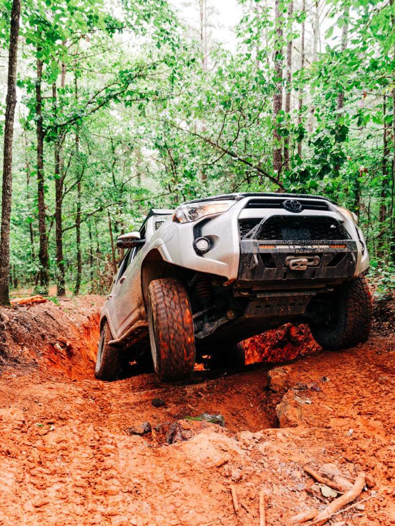

    Front Bumper: C4 Fabrication Low-Profile Bumper Warn Evo10-S Winch w/ Warn wireless adapter Extreme LED dual color light bar w/ Cali raised LED OEM style switch Bumper Cover Trimmed For Clearance Rear Bumper: 80% Off Road Rear Bash Bar (Limited rear bumper version) Armor: RCI Skid plate package C4 Gas tank skid (modified) RCI Rear diff skid RCI Shock Skids RSG Angled/ Plated Sliders Total Chaos Cam Tab Gussets Total Chaos Spindle Gussets 41.22 Hitch Slider Suspension: Dobinsons IMS long travel shocks: (Front: IMS59-50574 w/ Apache CF220 Springs) (Rear: IMS59-50575 w/ C59-677v Springs) Apex Chassis Tie Rod Assemblies (KIT410) Apache Off Road UCAs Apache Off Road HD Rear Links (Upper and Lower) Apache Off Road Rear Sway Bar Links Dobinsons Track Bar Front Sway Bar Deleted DuroBumps Rear Bump stops PerryParts Front Bump stops DRKDSS Track Bar Correction kit Dobinsons Diff Drop Wheels/ Tires: RRW 17x8.5 -12 RR6-H Wheels 285/75/17 Falken A/T4W 1.25" SpiderTrax Spacers BMC, Pinch Weld Folded. C4 High Clearance Fender Liners Performance: OTT Tuned Scan Gauge II for Temp Monitoring Yota Shop Diff Breather Storage Solutions: Sherpa Crestone Sport roof rack Aiden James Customs Gear Plate w/ Slide Out Tables Rado Designs Molle storage panels and top shelf Glove Box organizer Center Console organizer Interior: Diode Dynamics LED Interior lighting (Warm white ftw) Meso Customs Hatch lights Meso Customs Door Handle Covers Ram ball mount for Garmin In-Touch Mini II FitCamX Dash Camera Scosche phone mount Weathertech floor matts Misc: Nano Ceramic Tint (Including windshield and sunroof) Midland MXT575 and Ghost Antenna Cali Raised LED 27W Ditch Lights w/ oem style switch OVS Nomadic 6.5' Awning AVS Low Profile Vent Visors AVS Bugflector II Diode Dynamics puddle lights Lasfit LED Reverse lights LED license plate lights Ark Splash Guards Ark Mud Flap Deletes (cut for rear bumper/ bash bar) AJT Push-To-Start Button +Midland handheld GMRS radios, Baofeng UV-5R Ham radio, recovery gear, water purification system, lifeboat food rations, trauma kit, fire extinguisher and fire starting kit stay on board.
    Good tires
    Portable compressor
    GPS (I like the Garmin InTouch)
    That’s really all unless you’re really seeking out hard trails.
    IF you are seeking out the hard trails…(And you better be okay with some body damage if you are)
    - Winch and recovery gear (and the knowledge to use them safely)
    - Low profile bumpers
    - >33 AT/MT tires
    - Dobinsons extended travel suspension
    - Sliders and skids.
    Recommended:
    - Regear (for 34s or 35s)
    - Rear locker
    - Marlin Crawler cam tab gussets
    - Spindle Gussets
    - Onboard and handheld GMRS radios
    - Ditch lights if you plan on wheeling at night
    Just my recipe honestly. Everyone has different tastes though… pun intended.
    Now… past the mods, and I can’t stress this enough. Get some practice first.
    Know your limits and the vehicles limits. Bolting on a bunch of upgrades will not make you better or safer.
    A stock rig with good tires, the right driver, and patience will get through A LOT. Keep in mind every off road oriented mod you do WILL compromise some aspect of driveability. So mod carefully.
    Go to an off road park and hit some trails with some similar vehicles. The driver mod is the most important mod.
    Good luck and have fun!

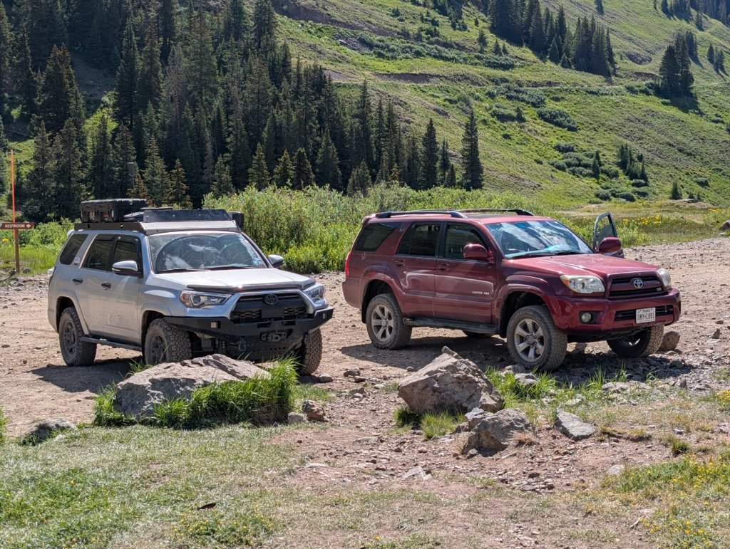

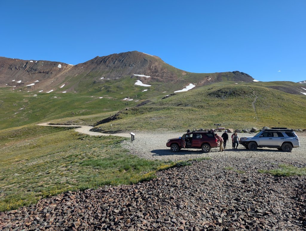

    Just as a follow up, didn't get as many runs as I was hoping this summer. Did do the full trip from Lake City, Cinnamon Pass, Animas Forks, Silverton, Animas, Engineers, Lake City. I dragged a bit on loose rocks rather than having issues rock crawling. I can see me needing something a bit taller than 31.6" tires and stock Limited clearance. I see damage on my muffler, exhaust pipe crossover, and a few structural member scrapes. I got a brief rub on one of my sliders at one point. I already had boogered up my fuel tank skid. I would have destroyed my stock Limited front bumper if I didn't already replace it. The back bumper never dragged which surprised me. I do have a handy hitch skid which dragged going up Engineers but not down on a previous trip.
