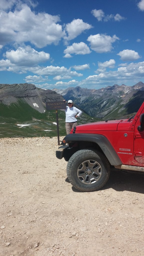

    I have done Imogene, engineer, corkscrew and black bear pass in a bone stock jeep wrangler sport. 17” wheels with Hankook Dynapro ATM tires aired down to just 20 PSI. No problems except an exhaust bump on Black Bear. I have yet to bring out the 4Runner. All of that to say I suspect your stock Rig would be just fine.
    while better tires and a lift is always better, I would say for those trials not really necessary. Just go slow, be cautious and enjoy the views. Pucker factor in effect a couple of times.

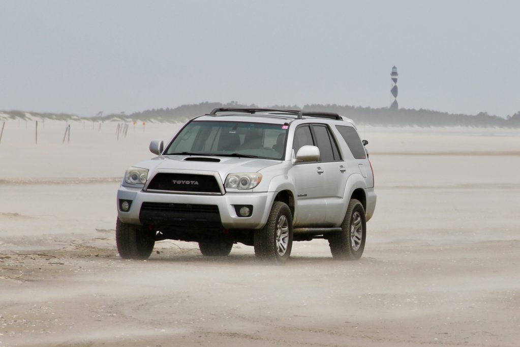

    What's inside your truck is as important as any mods - basic (at least) recovery gear and the knowledge to safely use it; plenty of water, snacks, and more substantial food (Clif Bars for example) that could replace a meal or two if necessary; first aid kit, fire extinguisher, and common sense.
    My '07 V6 4WD has a lopro winch bumper & winch; rear recovery point; sliders; upgraded skids (though I did plenty before my stock skids were too bent out of shape to use anymore); 265/70/17 Toyo ATs on a $200 set of Sequoia wheels (won't catch me worrying about trail rash); and an Eibach Stage 1 suspension setup. I would be confident on any of the trails you named—though going back to common sense, I would do my best to have someone with me the first time who has run them before. I've been on some awesome trails here in the southeast - some before I did any mods at all. After I got sliders, I did some rock gardens at Windrock Park in Tennessee, which was a first for me. I've got some pinstripes and dings but the memories more than make up for those things.
    All that to say that I 100% agree with several of the posters who said your 4R was ready for those trails, or damn close, the day it rolled off the assembly line. Experience is the best teacher, and all the better if you have an offroad park nearby where you can go out and see what you and your truck can do without worrying about overreaching and breaking something essential way out there away from cell coverage.
    Lastly, consider a group like the outstanding . Great people, super events for various build types, and as a beginner, you want an organization with a creed like theirs: Explore, educate, encourage.
