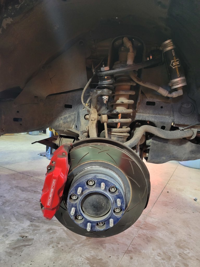

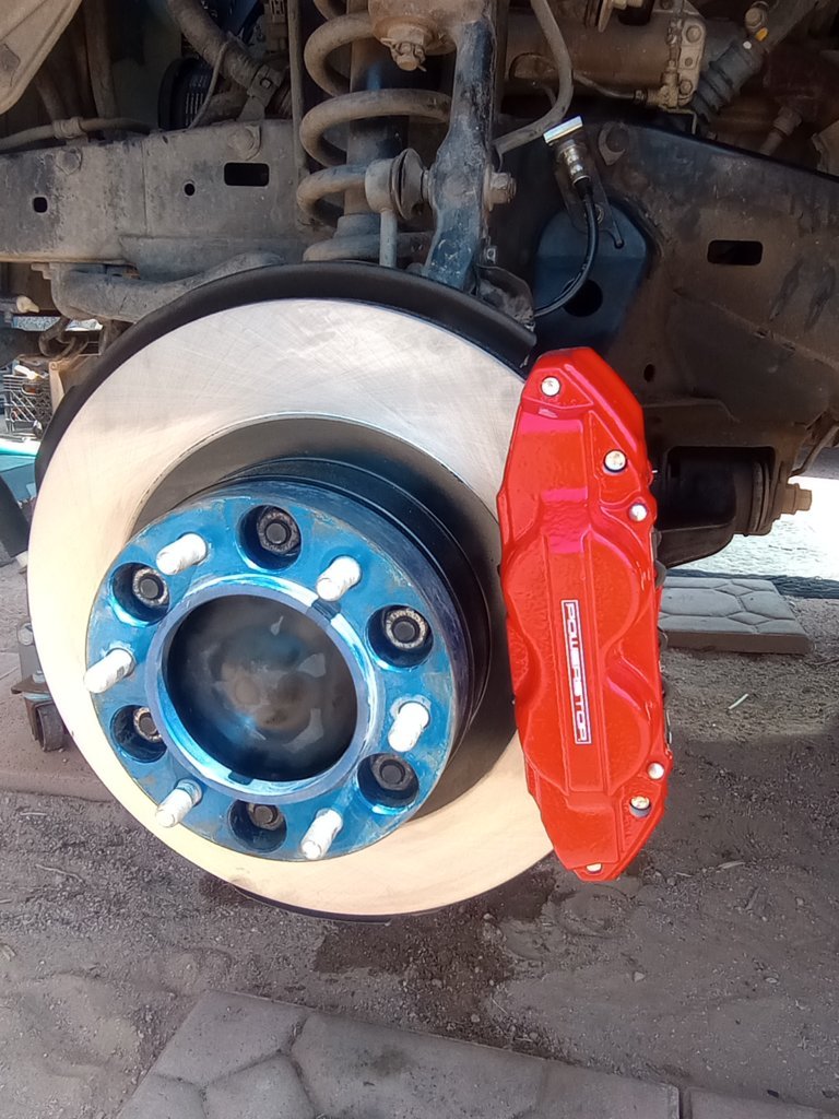

    So this is what I've got going on. Akebono pads, centric rotors and power stop calipers. On rock Auto, I didn't see power stop front calipers that specified 338mm for my 03 so I changed the year to a 2012 5th Gen and they have them. With the akebono front pads I also chose the ones listed for 5th Gen. Then I chose the centric 338mm rotors.
    It should work right? I mean, people that want to go bigger do the 5th Gen upgrade, which is essentially what my 4th gen sport has right? Is the big brake upgrade larger?

    You are correct on on your questions...the BBK is 345mm I thought, barely larger...5th gen 338mm is the same as 4th gen sport or limited with v8...centric is top notch as well as the akebono pads!

    Awesome thank you for the confirmation. Your kits pretty sweet btw. I think I'm pretty much piecing together the power stop Z36 kit only without slotted rotors.

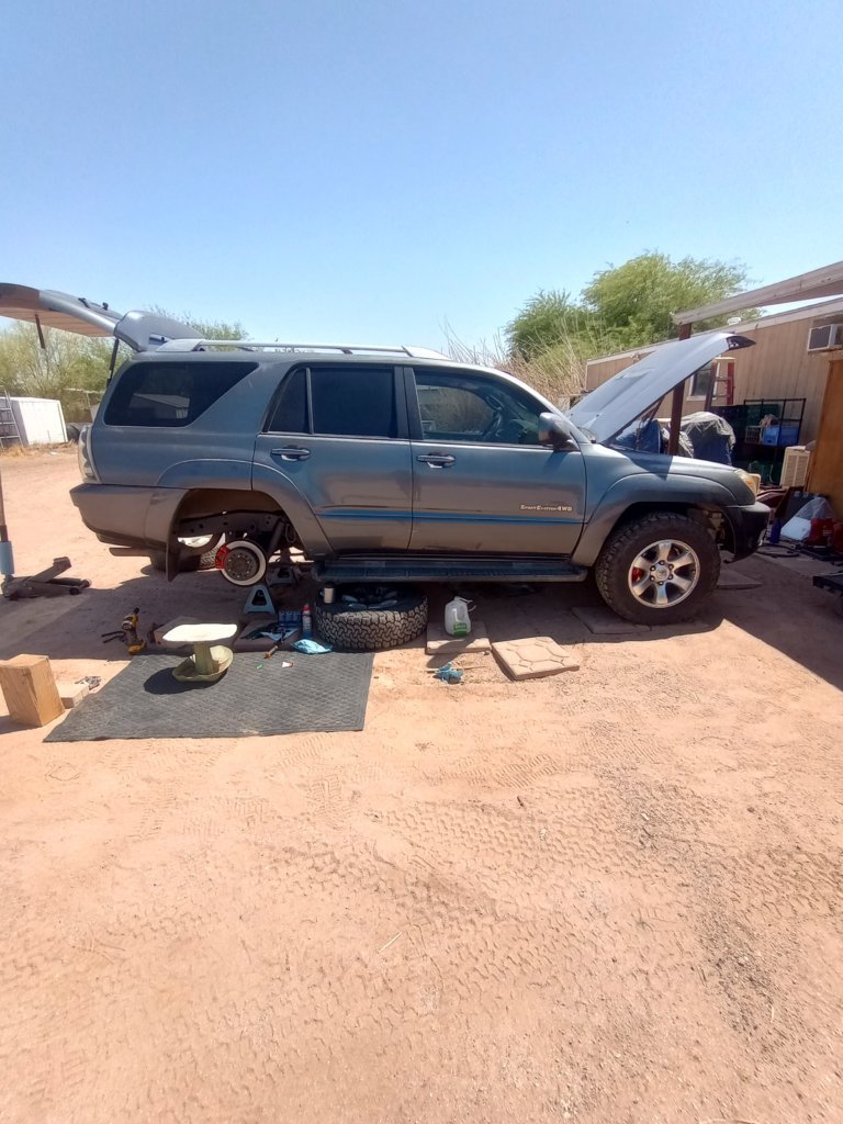

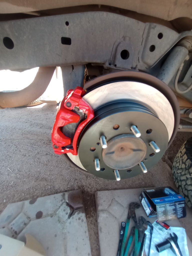

    Made progress this weekend. Couldn't wait for deals on brakes unfortunately. Could hear the metal on metal progress quickly over the past week lol. Also got in there and couldn't put it back together with those old blown open CV axles. Also in preparation for future lift I installed extended front and rear brake lines from Mudify.
    BeefSeltzer, gkomo and LOSTR4 like this.

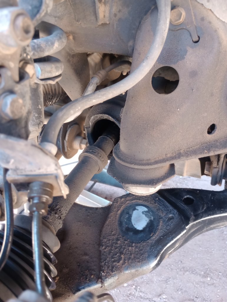

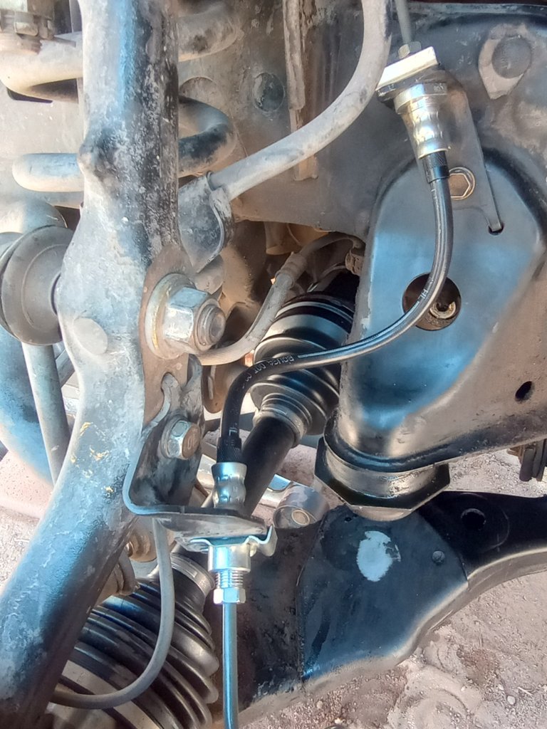

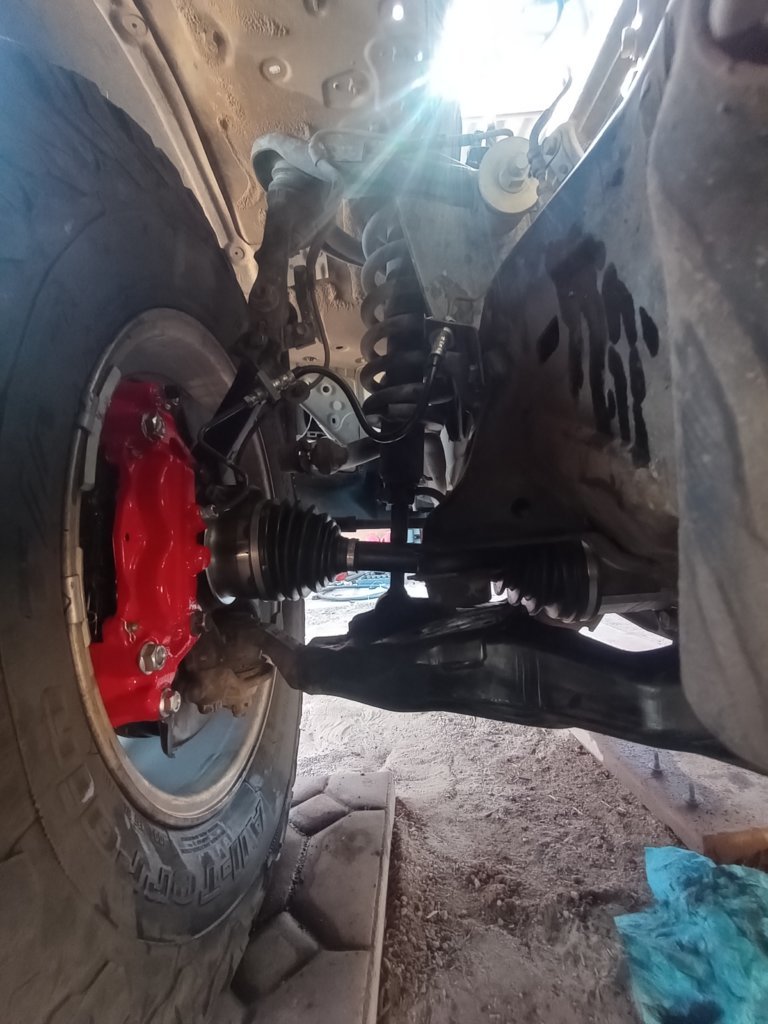

    After setting it back on the ground, you can see in the one photo my "negative" CV angle. Makes for good droop but it ain't ideal lol. UCAs obviously point up too. Can't wait to get the new suspension on but gotta save and figure out how much weight I will be adding. 80% off-road has a dual swing out that welds to factory points instead of a whole new bumper. I may go that route.
    gkomo, LOSTR4 and UFlaw98 like this.

    They were smoking a little bit but I think I bedded them ok. A few moderately aggressive stops from a fairly moderate speed.....then an increase of both lol.

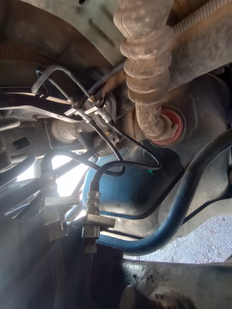

    https://youtu.be/pIQtCjfvCOA?si=b7IqIAYieTCMf58j
    Saw this video. Thought; I need to do mine since the driver side is torn. Well, didn't realize it's not recommended and Toyota only sells the whole assembly. I'm still thinking about tackling the ball joint replacement. I've been communicating with exit off road about a Dobinsons lift, I decided on 2.5" - 1.5" lift. I was planning on JBA UCAs too. Would super pro lowers be too much for the caster/camber adjustments with only 2.5 lift and are the ball joints in the super pro lowers replaceable/serviceable?

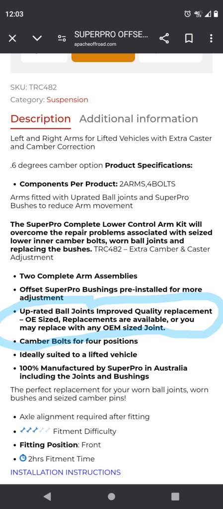

    Ok, here is the description from Apache off-road for the super pro lower control arms. If I'm comprehending correctly they are saying the ball joints are replaceable with OEM sized ball joints. Does anyone have a part # for these? All I find are moog and O'Reilly's/AutoZone. I guess they're OEM "sized" but not technically OEM?OEM would be Toyota which only sells the entire arm! Also it looks like the same process as in the video in my previous post. So what's the difference in serviceability? What am I missing? My only desire with super pros would be to try and keep the tire farther forward in the fender well in an attempt to better clear the body mount with only 2.5" of lift. However I'm sure I'll still need the bmc for 255-80/17s so is the cost of the LCA worth it vs just getting some O'Reilly's ball joints and replicating the process in the video?
    Thanks everyone.

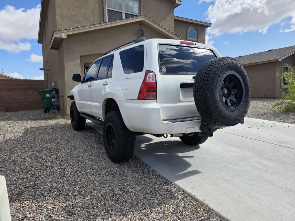

    I guess a better question is, what's the largest tire one can fit in the spare location with the tow package removed? I've searched the forums and just want a direct answer. With the V8 tow package it appears to be 265/70.
    LOSTR4 likes this.
  30. Jun 10, 2025 at 8:12 AM
    #60
    LOSTR4
    LOSTR4 New Member
    #41051
    419
    Just a couple
    If you do some cutting and deflating, you can fit a 35... it's tight but doable.
