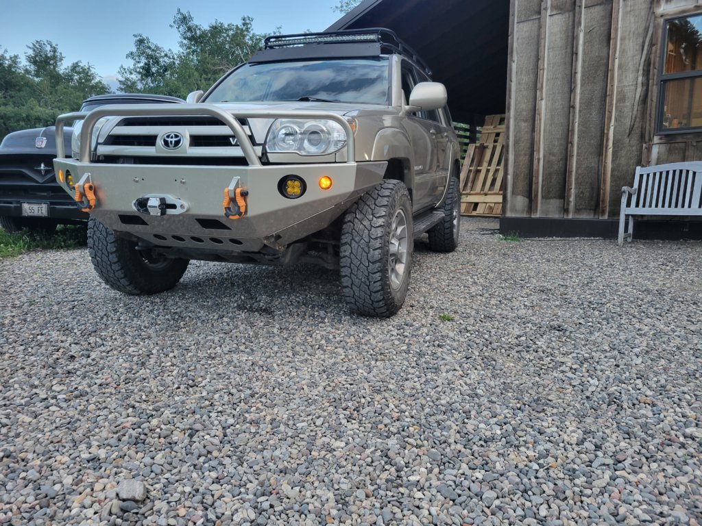

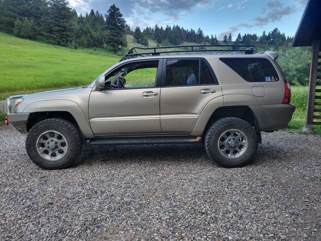

    Just a couple
    Welcome back! That is an uncommon tire size...I have the 255/80/17 for a skinny 33 and they're great...I'm on a 2.5" lift on Icons, myself...

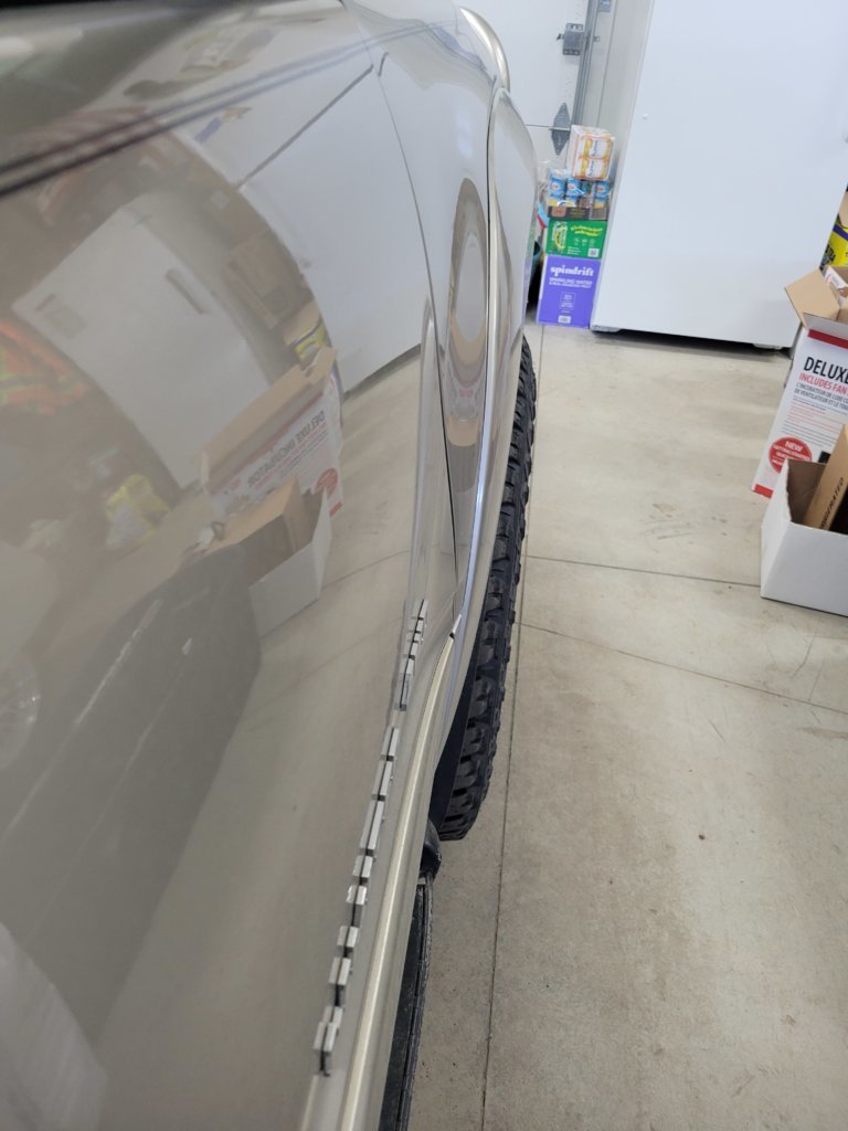

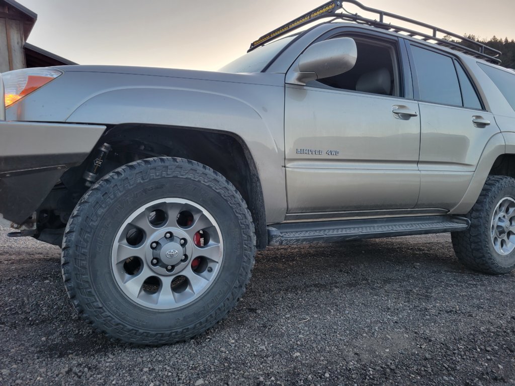

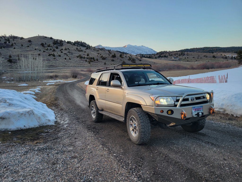

    Just a couple

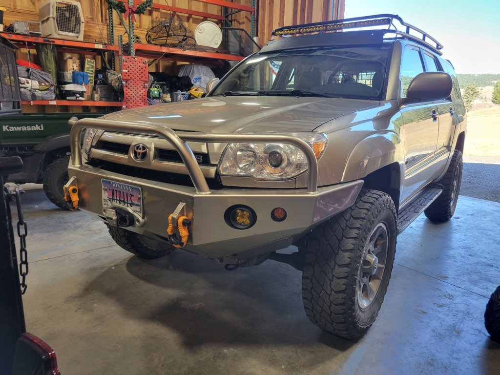

    Here are a few...
    Shoed in Cooper ST MAXX on FJ anniversary wheels...

    What offset? I had some BFG 33/10.5s on the Tacoma and they looked way skinnier. According to the tire comparison chart your 255/80s are 33/10s. My BFGs were on I think pro comp steel rims with spider tracks 1.5"s
    Good looking rig BTW. I'm pretty sure I saw it in the armor thread. Thank you for additional photos.

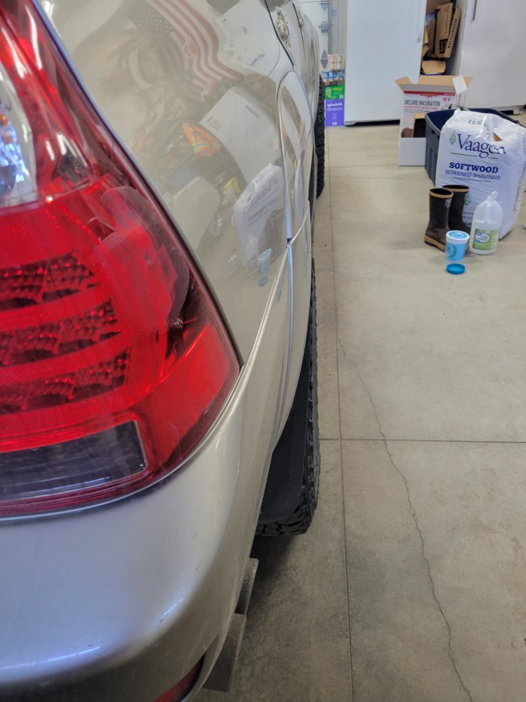

    Just a couple
    I'm not certain on the offset...the wheels are near identical to the 2013 4runner Trail Edition 6-shooter wheels (I use those for winter wheels) I'll look tomorrow what the offset is. I do have 1.25" spidertrax spacers on the front...took them off the back and like it better. Zero issues. I did use a heat gun and massaged the inner fenders so now no rubbing...

    Heat gun, that's a great idea. Did you have the spider tax on in these photos? The back looks like they stick out a little. If that's the case you don't need to worry about finding the offset. I'm trying to figure out what offset will net some skinnies flush with the fenders.

    Just a couple
    Spidertrax on the front in the photos, not all photos with on back...they barely slip past fenders...1" or .75" would be ideal for true flush. For the rear, without spacers, they're flush, now. I'll get more photos tomorrow for ya...best tire size IMHO!

    Just a couple
    17x7-1/2" - 15mm offset wheels

    It's my ideal setup...set it and forget it. Skinny 33s in summer on the FJ anniversary wheels (anthracite colored) and 265/60/17 studded Nokian Hakkas on trail edition 6-shooters in the winter. Zero issues and steroidal traction!
    The ST MAXX are 10ply tires (33s) and because of that, are heavy...having a tall and skinny offroad tire in this size and weight helps reduce wear on my steering and suspension bits more. One size up in tires adds 7-10lbs per tire in 10ply, so you feel that everywhere...I love it and it is unstoppable offroad, too. I live on gravel roads and c load tires enjoy being repaired more than my e loads.

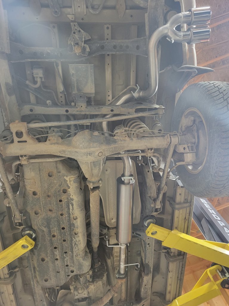

    What exhaust mods have you made? I see the side exit duals.

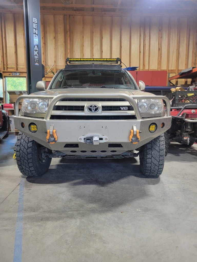

    Just a couple

    OEM is fine for break stuff. Looking good there. I like the tip on the Gibson. I got that too on mine.
