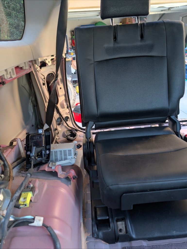

    I'm around, just don't log in much. Recent thingy completed earlier this year was adding a third row. I documented everything, just haven't had time to write it up and format. It's on the list.

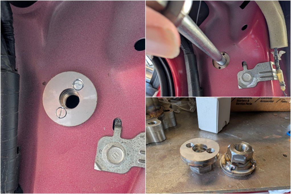

    Did you swap the second row too? I found that to be the more difficult part. Also curious what your solution was for the top seatbelt mounts. I ended up having my dad make some thick threaded cylindrical nuts and welded tabs to them which then got welded to the sheet metal after drilling some holes next to the correct hole

    Did not swap the second row, my reasoning was that I'd barely use the third row and I prefer the tip/fold seats against the slide/tumble.
    Did something similar to you for shoulder anchors, just used a sandwich method to secure them instead of welding to the sheetmetal.
