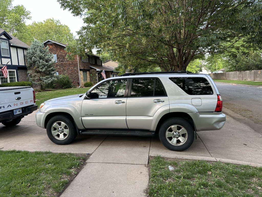

    cheap, but how difficult to install? and then an alignment after id assume
  2. May 13, 2025 at 11:43 AM
    Schlappesepple
    Schlappesepple New Member
    May 1, 2021
    #21226
    734
    2020 ORP
    If they're OEM take-offs (assembled coil and shock), then install is as easy as it gets.
    For aftermarket stuff: best case you get assembled coilovers, which would be the same as the above, worst case you need to assemble them yourself, which involves some kind of spring compression.
    Technically, yes, you should get an alignment after any suspension replacement. The aftermarket lift will need more adjustment than the tacoma take-offs.

    are struts off of a 2020 4runner TRD Pro going to get a 2008 4runner to level or does it have to be off the tacoma
  6. May 14, 2025 at 10:06 AM
    1,259
    The 4R geometry is the same I believe. So the TRD Pro 4R stuff would likely give about +1.5” if I’m correct.

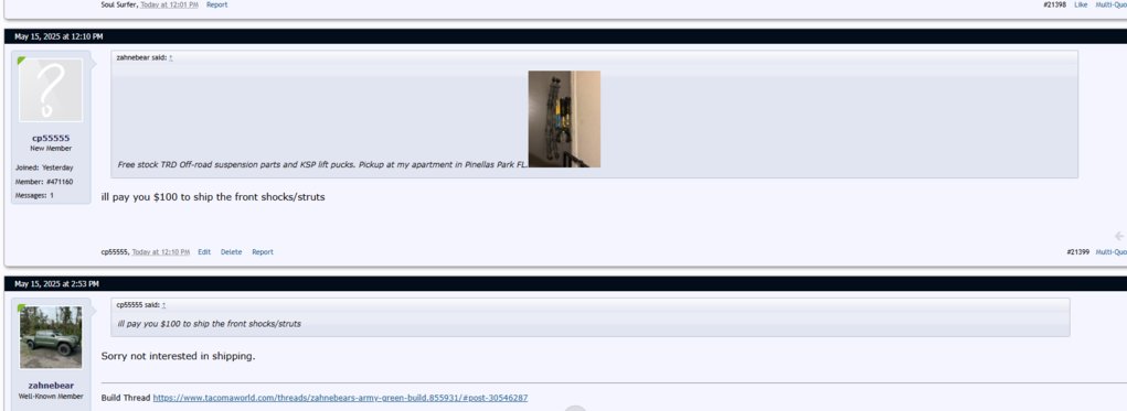

    well its only been 2-3 days looking but no luck on a set of Tacoma Struts/shocks yet. if anyone has a set, id pay to ship them to 67208

    Go to the tacoma forums and look in the for sale category there are plenty listed
    Go to ebay and type in toyota tacoma trd offroad shocks
    There was a guy who sold his on the tacoma forum a few weeks ago for $30 for the front set, yes both front shock and spring assemblies for $30. You might not find the deal of a lifetime TODAY but if you look for a few days you might find a deal like that. There are multiple active listings on TW for shock and spring assemblies including one in SoCal right now and that guy wants $75 for both front shock and spring assemblies. You are not looking hard enough there are over 300 listings on Ebay when you type in "toyota tacoma trd offroad shocks"

    Congrats, and you should definitely be able to push that rear bumper dent out with some heat. May not look 100%, but much better than it currently does.

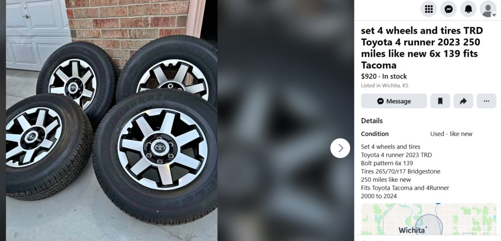

    does anyone have these rims and what did they pay? ive talked the person down to $800. they are highway terrain tires.. i watned an all terrain but for nearly brand new tires and rims, $800 feels like a steal

    Those are trail edition wheels...sharp wheels, for sure...but as long as the condition is mint, I wouldn't pay more than $100/each...the tires are something I'd take off and sell, so perhaps you could make a few dollars back... Trail edition wheels are sought after so maybe that's a great price...?

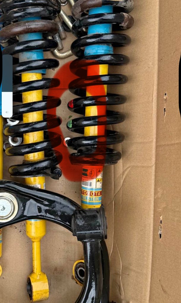

    @cp5555 Something I forgot to mention is that the Tacoma coilovers are color keyed for which side they go on.
    Of course I can’t remember now which is which, but I’m sure someone here knows and will chime in.

    Just got a set on eBay for $200. It was from a reputable parts supplier with tons of reviews so I believe the mileage they were listing which was about 10,000 They also offer a product guarantee so I was comfortable paying that price

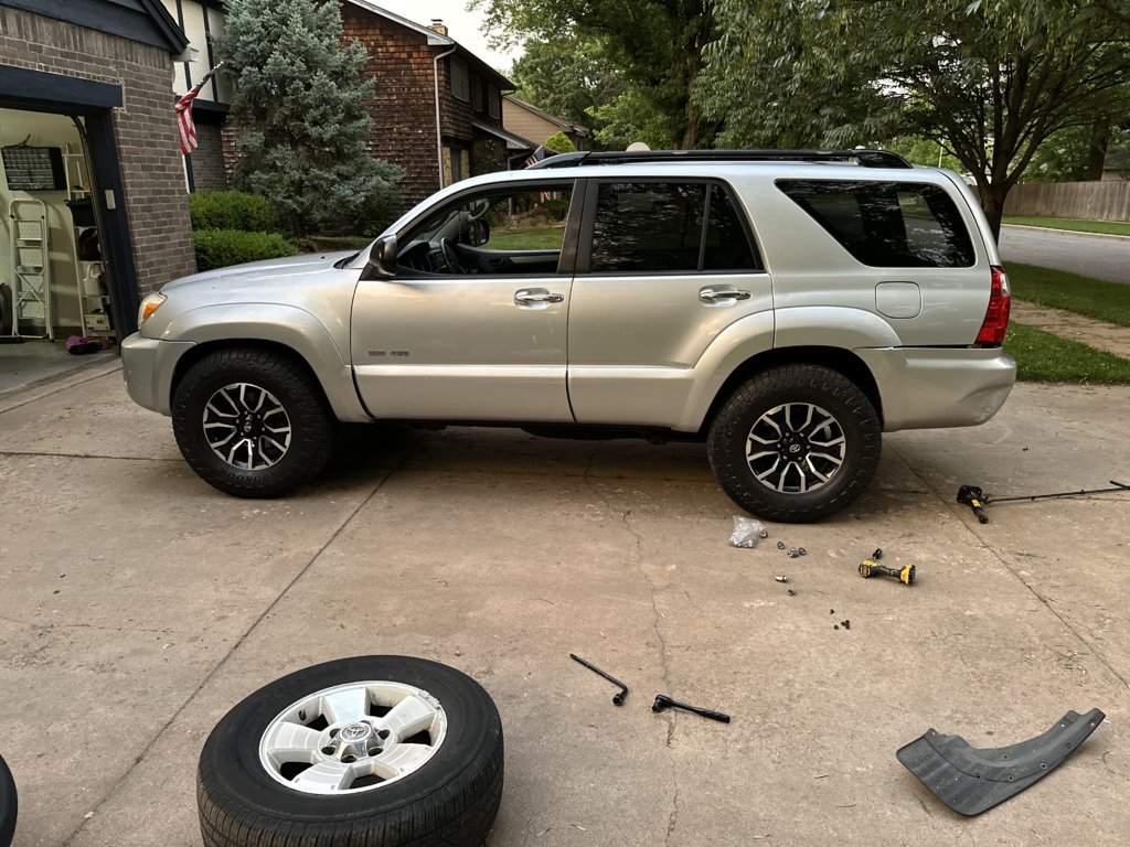

    Fit some 33s minimum rub but leveling kit gets here Tuesday

    Turn your wheel and get a heat gun or hair dryer to massage the wheel liners some... looking good!!
