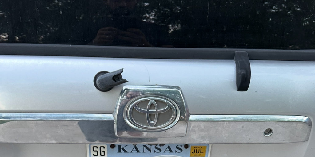

    Well. Absolutely zero rust. Body wasnt great but its really just two new bumpers is all. The rest just needs a little touch up. Needs new wheels. the truck is going to cost me $2000
    The sunroof worries me but he has a quote to fix it for $1000 so if worst comes to worst i know it can be repaired

    Pictures or it's just a dream! :yes::anonymous:
  16. May 12, 2025 at 7:25 PM
    1,259
    We need pix
    You took pix right?
    Whats up with the sunroof, just leaks? Drains are easy to stop up, dirt dobbers get mine during the summer all the time. You gotta run a piece of cable or something thru them at least once a year to punch the gunk out of them so they will drain.

    If you dont need the roof rack, you can get the roof rack delete kits on Amazon and ebay for like $30 and it makes it a slick top.
    The front and rear bumpers are no real big deal, honestly that rear one you can probably take it off and set it in the summer sun and push that dent out, replace the clips and put the rear back on. Albeit if you want it to look nice you probably should just have both front and rears replaced and painted to match. If you're gonna go that far and mix the paint may as well get a limited grille off ebay and have it painted to match and swap the chrome grille out.
    I actually have a rear window wiper i'll ship you for free if you pay the shipping cost. You might can find them cheap on ebay too though.
    Other than that it doesnt look super bad from the limited pictures we have. $2,000 is dirt cheap though. If it runs, get it.
