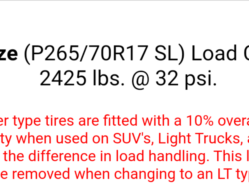

    This picture explains what I'm talking about. Same size. Same vehicle. One SL, one LT. Massive increase in pressure for the LT.
    I don't believe anyone has suggested that we should drive around at max inflation.

    12 Psi difference between an SL & LT tire, this not out of the extraordinary for an LT tire 44 Psi on the 4R. Like I said the structural characteristics are different. Btw. this is not max inflation.

    I understand that. That doesn't explain why the different pressure is required.
    Just saying that it's different because the tires are built differently doesn't explain anything. I would like to understand why the exact same size tire would require different pressure to support the exact same vehicle just because it is built differently. What I'm saying is I would like to understand the difference is and what causes it. I know that there are differences. I would like to understand them
