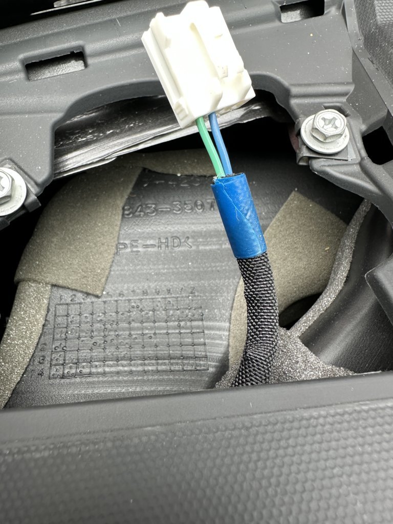

    Just bought a used '18 Limited with JBL. Thought the left dash speaker was blown but in fact it's actually missing completely along with the bracket and the one side of the harness that I need to reuse to wire with the Pioneer 2.75" speakers I bought.
    My question is can I bypass the harness completely and just wire these two green and blue wires directly to the new speaker? If not, is there's an aftermarket adapter like a Metra one so that I don't have to try and chase down a junkyard dash speaker just to take the harness from? Thanks.

    You can bypass or use the Metra.
