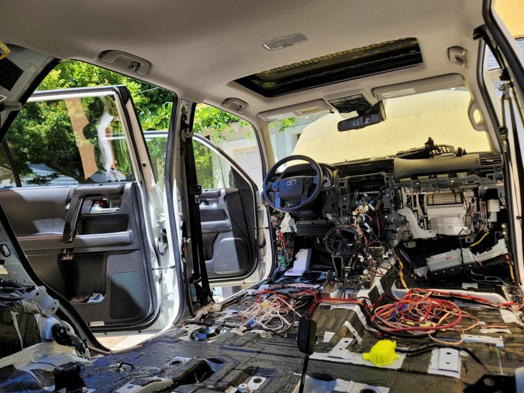

    I was gunna tag @Thacrow maybe for pics I think he has stripped his interior, like a madman

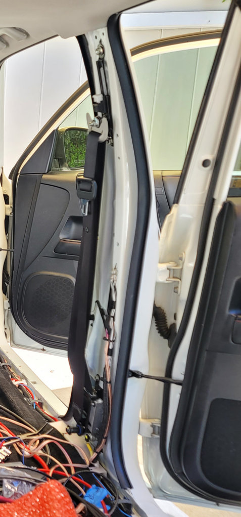

    Lol yeah thats my car. Ill check later if theres a better pic of that B pilar but I wasnt ever trying to get pics of that. If its important to you guys its fairly easy to take off.....however its easy to lose the yellow plastic clips inside the bpilar and then your shit rattles. Stay tuned.

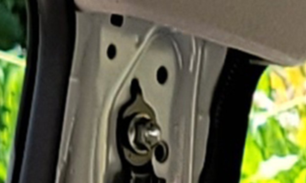

  7. Jun 20, 2025 at 8:30 PM
    Thacrow
    Thacrow New Member
    May 30, 2021
    #21719
    1,883
    2021 ORP
    Speed holes

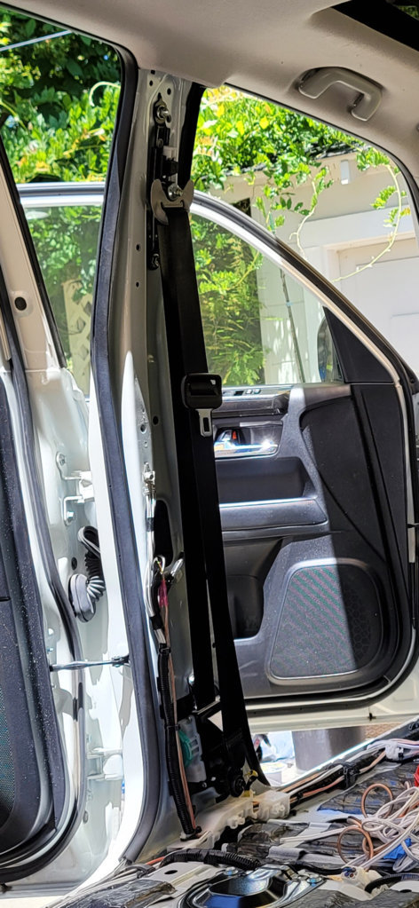

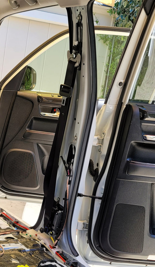

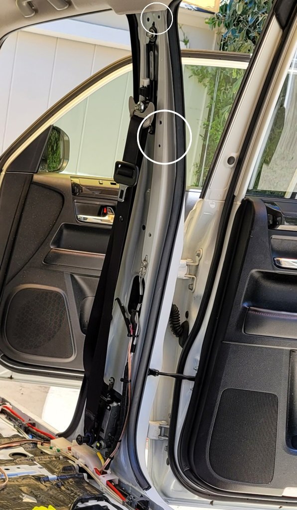

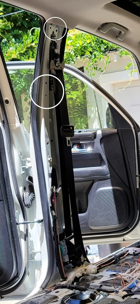

    here's some pics cropped and zoomed in. Let me know if you need better.
  8. Jun 20, 2025 at 10:42 PM
    3,350

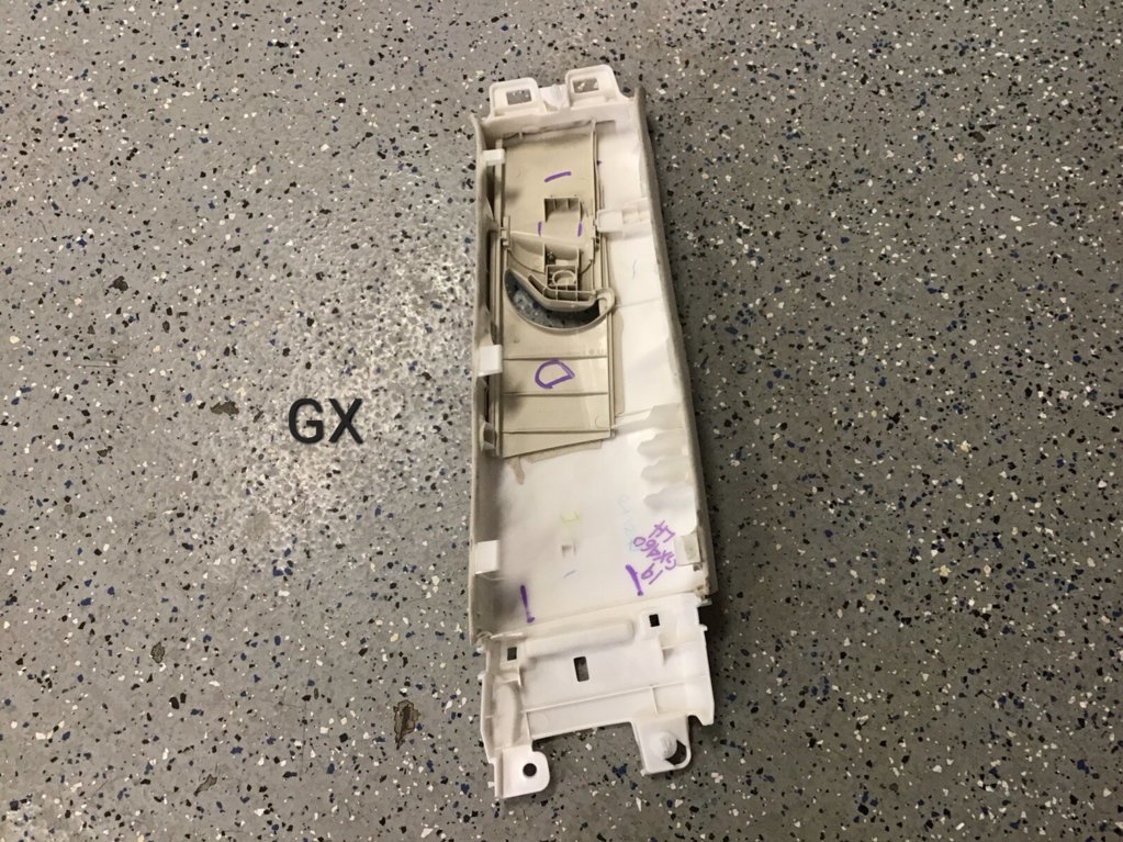

    There's no grab handle provision on this piece?

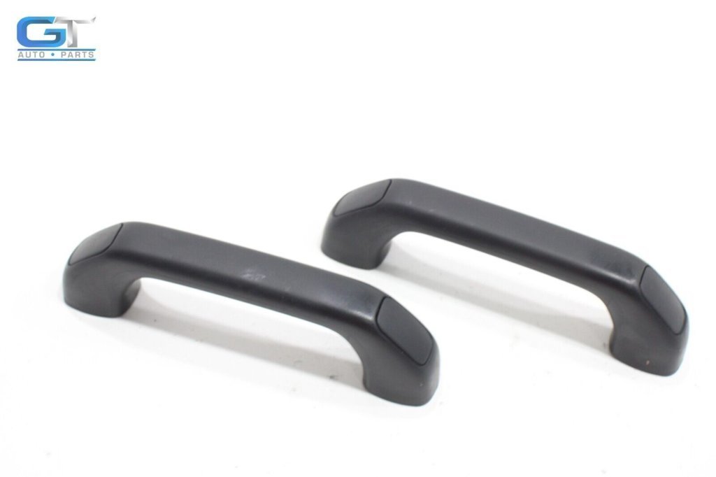

  9. Jun 23, 2025 at 10:05 AM
    Emmantik
    Emmantik New Member
    Dec 11, 2018
    #8016
    555
    Coquitlam, British Columbia
    2015 Magnetic Grey SR5P

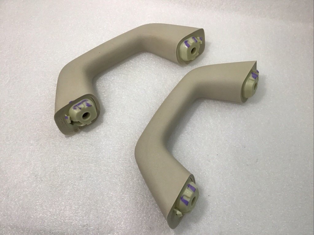

    In the Ebay ad I got the pic from, the trim is sold without the handles. If you look closely at the pic, there are indents where the handles would sit.
    So the question is, are these handles just mounted to the B-pillar trim on the GX, or are there actual mounting holes on the body??? Tried to search for pics but no real luck.

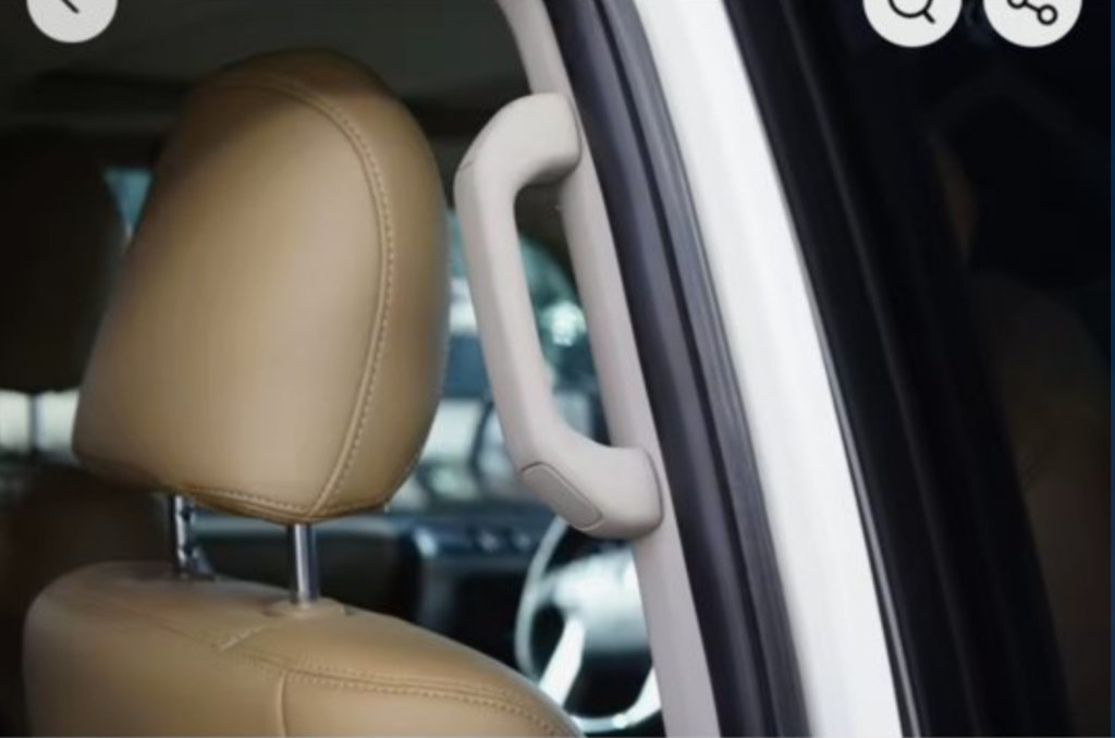

    Pic of handles from a GX.

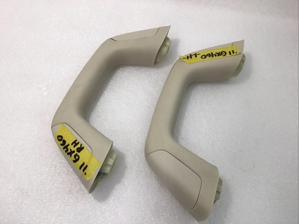

    So apparently the GX has C pillar grab handles as well which look to have different mounting than the B pillar handles. They actually look like the FJ Cruiser A pillar grab handles.

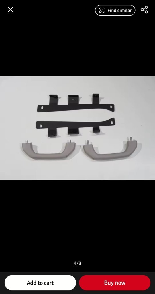

    So in my continued research looking into how we can have a B-pillar grand handle on our 5th gen 4Runners, I found that Aliexpress already has an option. They use a mounting bracket as well but unsure if you would have to drill holes or they use existing mounting points. No install instructions in the ad.

    Here is a link but the screenshots are from the app;
    https://www.aliexpress.com/item/1005005612210551.html
    I am actually willing to try this as well if it utilizes existing mounts so I don't have to drill through the body.

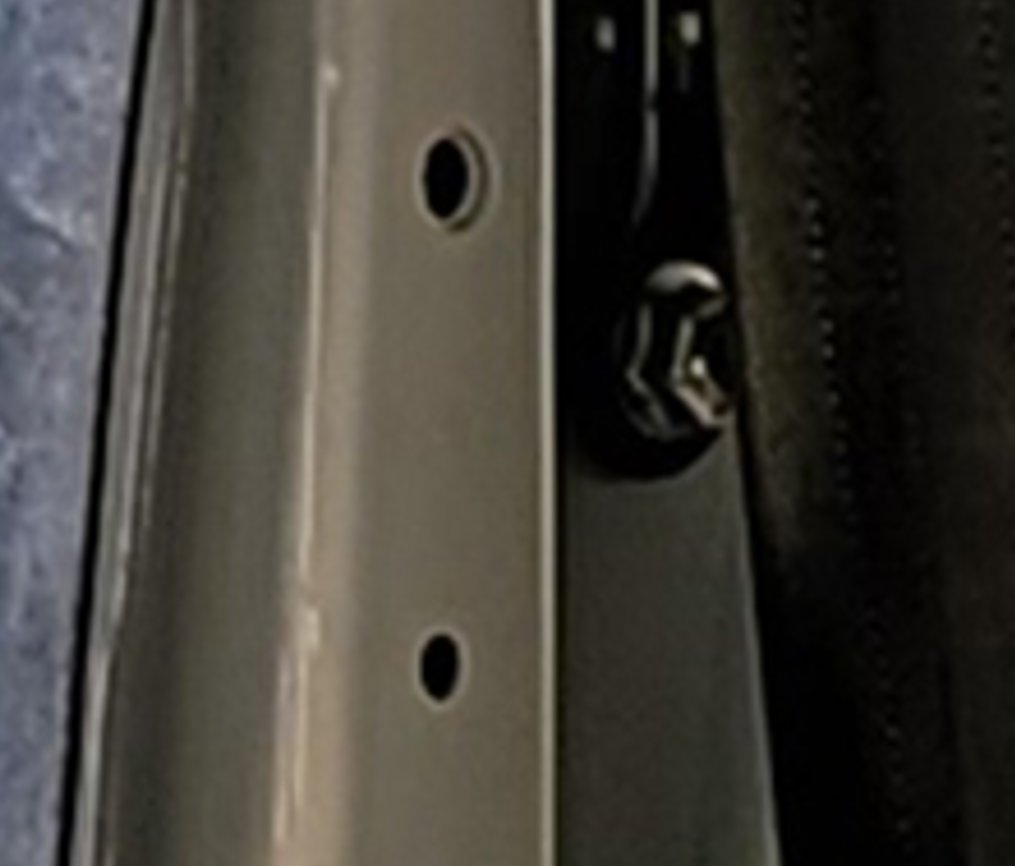

    Great shots without the trim!
    Question, are these holes threaded or just holes? (specifically the holes towards the rear of the vehicle)
  17. Jun 23, 2025 at 1:07 PM
    Thacrow
    Thacrow New Member
    May 30, 2021
    #21719
    1,883
    2021 ORP
    Speed holes
    Nah. Nah Dawg. Negative Ghost Rider. The Pattern is full.
  18. Jun 23, 2025 at 5:26 PM
    3,350
    Easy enough to open them up to larger size if needed and put in a rivnut. The KTJO4X4 B-pillar handle for Tacomas does just that.

  19. Jun 23, 2025 at 5:40 PM
    #49
    2,566
    … or drill new holes wherever is appropriate. The hard part will be to transfer the holes to the garnish.
  20. Jun 23, 2025 at 7:14 PM
    #50
    859
    Looks like this mod will more than likely need Rivnuts. I think T-Nuts will fall in the backside of B pillar.
    Once one nails down where they want the handles, then install the rivnuts, and one can insert a sharpened stud or bolt in said rivnut and place the panel in place and press slightly to transfer your drill hole.
    Hope that makes sense!
