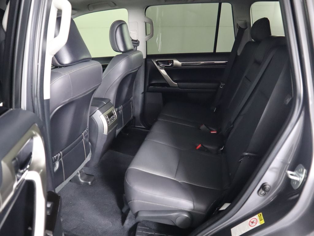

    Has anyone added rear grab handles like the GX's have?

  20. Jun 18, 2025 at 5:25 PM
    3,220
    Wouldn't be surprised if the GX parts are plug & play.

  22. Jun 18, 2025 at 6:13 PM
    3,220
    ^I doubt it, since the 5th gen cab is a couple inches taller than the 3rd gen Tacoma cab.
  23. Jun 18, 2025 at 10:47 PM
    7,370
    Not to mention a completely different body style.

    I have a set, but to be fair I have a GX. They actually have three sets of handles on each rear door - the grab handle you showed, a handle above the door, and a handle down low on the back side of the door frame which is used for 3rd row passengers to climb in and out. It's glorious. Plus of course two for each front door, above and on the A pillar. The GX has as many handles in it as the 2nd gen Tacoma has cupholders!
    To your point, the bodies are different, but a lot of stuff does bolt up between them. Peel back that B pillar cladding and see what you are working with under there!

    This got me thinking. I was wondering if the B pillar trim from a GX was the same for the 4R. So I jumped onto Ebay to see if I can find pics to compare. Here is the backside of the trim. Looks very similar but not exact. Does anyone have any pics of what it looks like behind the B pillar of our 4Runners?

    This is from the "What have you done to your 5th Gen 4Runner today?" thread. Probably the best we can get until someone takes the time to remove their B pillar trim.
