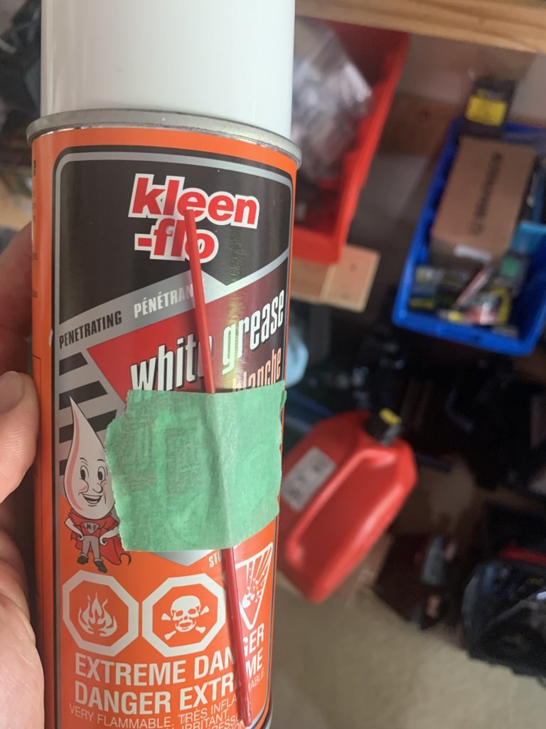

    No sweat, glad to help. You and others helped me. Users are almost all inherently good on this forum, often going above and beyond to help ppl.
    So I used different varieties of WD40 only, on the NSS. Get someone (who doesn’t want to kill you) to sit in driver’s seat and shift gears while you’re under there spraying. And run of the mill kleen-flo white lithium grease spray on linkage (and white grease my gear shifter inner mechanism, but that’s another thread and takes commitment!)
