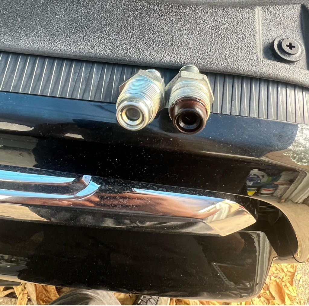

    1,441
    Often overlooked with general maintenance. An OEM costs $11 and takes 5 minutes to change. A clogged one can cause oil leaks, increased sludge and damaged gaskets

    I was a tech for 14 years. Most car leaks start with a failed pcv. Most never change the pcv, only the gasket. Once they replace a few gaskets, seals, etc… they will finally take it to a tech to replace that $11 part and charge them a minimum 1 hour labor fee.
    I change mine every 50k. Best to not have to worry about it. You may get lucky and never get leaks, you only get a valve cover gasket leak, or you may build enough pressure to blow the rear main seal. It is not the only cause of these failures but very common.

    Can you not clean PCV instead of replacing?
    Not familiar with the design of PCV valve on 4Runner, but I always cleaned out PCV with alcohol-based solvent (e.g., brake cleaner, electric connector cleaner) when necessary. Long time ago had a BMW that had to get it cleaned every oil change, but that is extreme example.
    Generally, cleaning PCV is very important on any engine that has a bit of blow-by as this is how they end up getting clogged. I do not think 1GR-FE is prone to blow-by.
