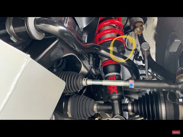

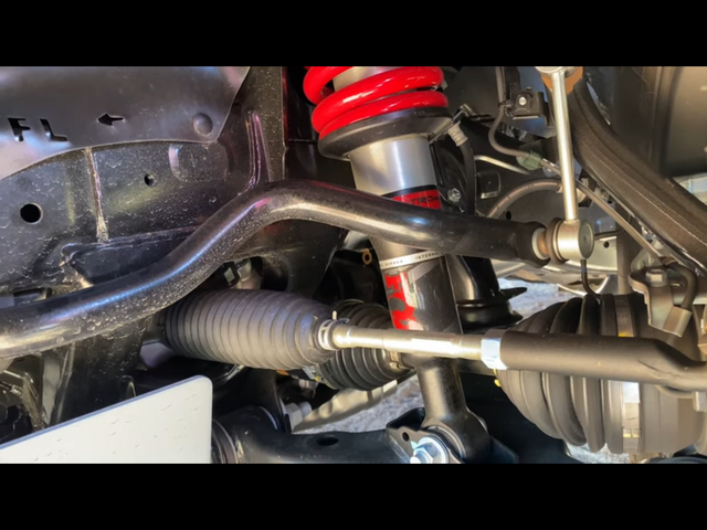

    You sure the dealer is using the new 2021 shock/strut assemblies as there is a TSB about this issue and the solution is to replace with new 2021 part numbers?
    It is easy to to tell as the bottom spring perch on the 2021 assemblies have a jog or offset to seat the coil where the bottom spring perch on the 2019-2020 assemblies are flat/level.

    Just thought I show pics
    2021 assembly showing the offset spring perch, circled.
    2019-2020 assembly with flat perch without offset.
