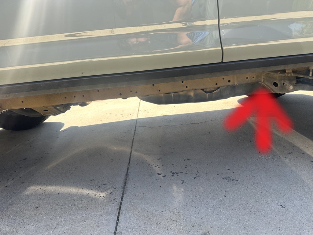

    So I guess this is as good a place as any to ask.
    I just put some armor on the frame attachment point for the rear lower links. This doesn't seem to be a big topic here or least I didn't get much with a quickie search.
    Is there no interest in this? For me it is a bigger priority than the stock skid plates or the low position of the gas tank. If they get damaged, it's a project to repair, or potentially so depending on the amount of damage. Skids can just be replaced.
    Just wondering. Any thoughts?

    For the most part, people hit things at less than 5mph, usually slower. You're not "damaging" things by scratching them. Armor hangs down, it decreases ground clearance. Do you need it, maybe. Do you do trails with rocks and can't take a good line, then ok. Most of the time you drop onto your frame, or something, and it makes a big noise with no (appreciable) damage.
    I'm going to say, 90% of what we buy is an answer in search of a question. The last few times you went out with your 4Runner, what part did you hit? The answer is put armor on that part(s), if it was damaged. Otherwise, you're adding weight and reducing clearance; two stupid answers to a question you never asked.
    Generally, if you become a better driver, you hit fewer obstacles.

    The control arm pivot is a jacking point. It can survive hitting rocks without damage to the point of affecting function. The fuel tank skid on the other hand can't support the weight of the vehicle.

    I'm not talking about scratching.
    Yes I do rocks. Yes I know how to pick a line.
    Where you go awry is with "most of the time". The problem is your "line" doesn't always stay your line. Sometimes you slip sideways from your chosen line and end up somewhere you never intended to be. Additionally, the speed doesn't really matter if you come down on something with full (or significant amount) of the weight of the truck and you really can't always foresee that. By then the damage may be done. What part did you hit? Sure if its a skid or tie rod or knuckle, those are replaceable parts. Replacing a link mount is a much more technical job. The skids are maybe 5 pounds and 3/16 inch clearance reduction.
    I guess the good question in there is "Do you need it, maybe". And I suppose that is for each owner to decide for themselves

    I've seen some pretty mangled. Beyond the point of functioning? Hard to say. Jacking in a controlled fashion and getting caught up on rocks are different things.

    Hey I've got C4 fuel tank skid. I was disappointed in how the skid connects to the 4runner in that I don't think it could support weight. It's brackets look like they would bend and the weight would be on rhe fuel tank....but in almost no situation would the entire weight of the vehicle be on the gas tank skid.
    Curious if you've seen good gas tank skid brackets that you think could take the weight.

    ^Yes typically this is how the stock fuel tank skid fails - it caves in. The fuel tank then caves in as well. Typically the fuel tank isn't punctured, but capacity is reduced and the level sensor becomes inaccurate.

    I’ve dragged that particular drag link mount with a little side pressure on one occasion. It removed some material, but no bending that I can tell. I just cleaned it up and painted it.
    Picking good lines and not worrying about it is a legitimate
    approach, but things don’t always go to plan. If it happens a lot, I’d be concerned about loss of material after a while, but it’s probably me worrying over nothing.
    The thing with armor, is considering unintended side effects. Does it create a moisture trap? Will it reduce clearance in annoying ways? Does the armor mounting method cause the possibility of other damage? Considering if any drawbacks outweigh additional protection is a pretty individual decision.
    Case in point: I slipped off of rocks and onto my LCA frame mounting tabs on a couple occasions. It got me paranoid about bending them, so it became a priority for me to find armor that protected them. The other concern was the exhaust crossover. The only skids that covered both those areas well was the 4xinnovations skidset. Freaking stout and well designed, but they are more of a belly pan system that have caused me to high center in situations where I wouldn’t have before. Removing them for maintainance is also another thing that adds time. But the protection they give definitely outweighs the drawbacks. At least for now. If somebody else was doing my maintainance, it wouldn be a different story.
    The rear diff housing is another spot. I’ve been told you’ll never wear through a toyota housing, but I’d like to armor it anyway. I just haven’t found a an option that has benefits that outweigh the drawbacks yet.
