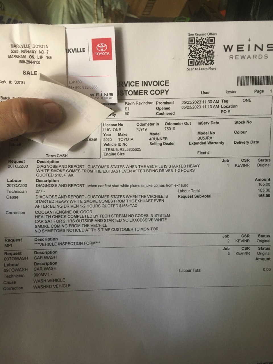

    Funny thing these dealers.. the particular one I went to didn't even look at my videos, charged me the 160 diagnose fee and said they didn't find anything. Of course they didn't, since the car has to be driven for a while then left for a few hours to cool down.

    Expensive car wash.

    Warranty is 100km / 5 years for engine issues. White smoke is engine issue, I am not out

    I saw you were in Canada.....

    That's right, canadian warranty is 100km / 5 years for power train
