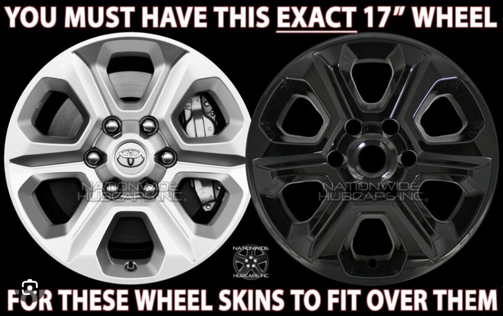

    Ok so they are called wheels not rims. Got it.. I don’t think spacers are good option for me then. Some of the wheels I’ve liked are 8-8.5 ( -6 ) I’m guessing that it wouldn’t cause rubbing issues? I understand that more negative offset pushes the wheel out. What above wheels that are bigger than my stock 7”? As I understand it this would push the wheel/tire out more?
    Or my 4Runner currently has black wheel skins ( just covers up the chrome) it’s not bad looking, but I kind of think they are cheesy ( leaving them would save me a ton) any thoughts? My other option I like is TRD wheels?
    What’s the consensus? New wheels, TRD wheels or skins?

    What on earth is a wheel "skin"?

    It’s like a hub cap but it goes over the actual chrome wheel. I bought the 4Runner used from the dealer and they were on the vehicle at time of purchase. I liked them as they cover up the actual silver wheels.

    Do you have a photo of this?
