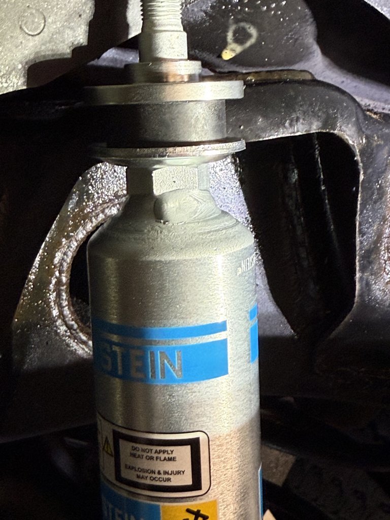

  7. Aug 27, 2025 at 5:01 PM
    6,471
    Bought brand new 2016 After May 2021: -Approx 3" lift/level: Bilstein 5100's, OME 2884 590lb 3" front lift springs, SPC UCA's, ICON 158506 2" lift rear coils, diff drop -Mickey Thompson Baja ATZ LT285/70R17 Load E -Mickey Thompson Sidebiter ll 17x9, 0 offset, 5 backspace -Pro Comp black spline lugs ^installed by 4WheelParts^ -New brakes and rotors by brake shop -4-piece ARB skid kit -Smittybilt 2" nerf steps -MBRP black exhaust tip, chopped OEM -Drivers side OEM FJ oh shit handle -All blacked out emblems -Blacked out roof rails -4x WeatherTech window rain guards -OEM custom rear mud flap deletes -KICK BACK MUD FLAPS 12" WIDE - BLACK TOP AND BLACK WEIGHT -FRAM EXTRA GUARD CA10835 engine air filter -1797 LED tricolor fog bulbs Yellow 3000K White 6000K Blue 15000K 28W 4000LM -Armour paint lower rear bumper -Front bumper high stage high clearance cut -Fenders cut straight across, pink reservoir sprayed black -4Runner Lifestyle sequential fog fangs -4Runner Lifestyle smoked taillight decals -Pedal Commander -Rear passenger cargo mounted 120v truck tire pump -4x Spidertrax 1.25" black aluminum wheel spacers -Yota Twins Paracord Hatch Strap sand camo -Teton Workshop hard anodized matte black aluminum shift knob -Ditch flood lights 4 LED 20w 1400lm w/ OEM hood mounts on OEM style dash switch -Backup flood lights under bumper 6 LED 18w 1500lm on OEM style dash switch -Body Mount Chop; cut, weld, paint -Fender mount chop, re-weld, paint -Fender Liner cut behind wheel (I cut liner in front of wheel clean off at top of viper cut) -Wheel well firewall hammering, painting ^done by Arc One Industries^ -valance cap trim -Agency6 Black Shackle Block 2" US Certified 6061 T6 CNC machined aluminum -DRT fab universal hitch skid -ACDelco inner tie rods, outer tie rods, bellows -Full Dr. KDSS switch kit -March 31 Behind grille 13-1/4" 32 LED light bar + wide-angle, eagle-eye lens 6000lm on OEM style dash switch -RAA Powder coated steel roof rack cargo basket, 1" side rails, 64" x 39" x 6", 250lb limit -roof gas can, water can, shovel -PEAKTOW PTT0063 Hitch Mount Cargo Carrier 51-1/2 x 17-1/2 x 4 inches 500 lbs. Capacity (trips only) -July/2023: purchased first needed SPC balljoint replacement kit - newly released, upgraded non-zerk sealed joints 25002 -July 15/2023: The Original Universal EZ Flares, 1". All four corners -Dec. 2023: removed bumper cover and crash bar, drilled frame, installed Apex Overland KDSS Recovery Points -Jan. 2024: SPC balljoint replacement kit - upgraded non-zerk sealed joint design 25002 -Jan. 2024: custom installed 2lb fire extinguisher between drivers seat and door -Feb. 2024: swapped interior lighting to diode dynamics led’s -Feb. 3/ 2024: 4x KC Wire Hiders, for roof rack lighting -Feb. 13/2024: double ditch lights, on new Rago Fabrication Extension brackets. -3inch Quad Row Amber Pods from LED-Club. 32W 3200Lm 16-LED Spot Beam. Existing: 3inch EVERGEAR clear lens LED pods -May 2024: custom black aluminum grille mesh installed in front of factory plastic -June 2024: custom built powder coated dom sliders -Nov. 2024: thermo-plastic rear mudflaps -Dec. 2024: rear bumper cover clearance cut, sprayed newly exposed parts black -Jan. 2025: trailer hitch removal, relocation of rear led pods to crossmember New: -Exhaust pipe chop after axle -March 2025: new SPC upper control arms, bushings, balljoints. Raised front end 0.75” via Bilstein 5100 spring seat. -April 2025: Evergear bezel-less cube ditch lights 4 LEDs 40W 3.33A 4800Lm 328’ beam distance 30° 6000k beam angle shatter & crack resistant lens -April 2025: Evergear Ultra Series light bar 27-3/4” flood spot combo 60 LEDs 60W 5A 6000Lm 1227’ beam distance Dual row, dual beam angle 30°/60° April 2025: BULLY Rock Crawler Hi-Intensity LED Utility Lights, Pair 1260 lumens @ 15w (3 x 5w CREE) each 120° flood beam waterproof, dustproof. Under hood: -Blue Fire 6-Circuit Fuse Block w/ LED Indicator & Protection Cover -Blue Sea 100A Circuit Breaker w/ reset lever In progress/in the garage queue: ~ Wanted - 80% OFFROAD Hitch Replacement Recovery Point, PerryParts or Wheelers bump stops, 1" body lift, custom dom front bumper, winch, rear dom bumper with side hoops, kdss angle correction, C or D load 35’s, bolt on cat shields
    Any specific tips for me, I’m doing pads myself for the first time this month
  8. Aug 27, 2025 at 5:11 PM
    2,645
    Probably showing off how he stacked up the mounting hardware. Bilstein's instructions can be a little less-than-clear.

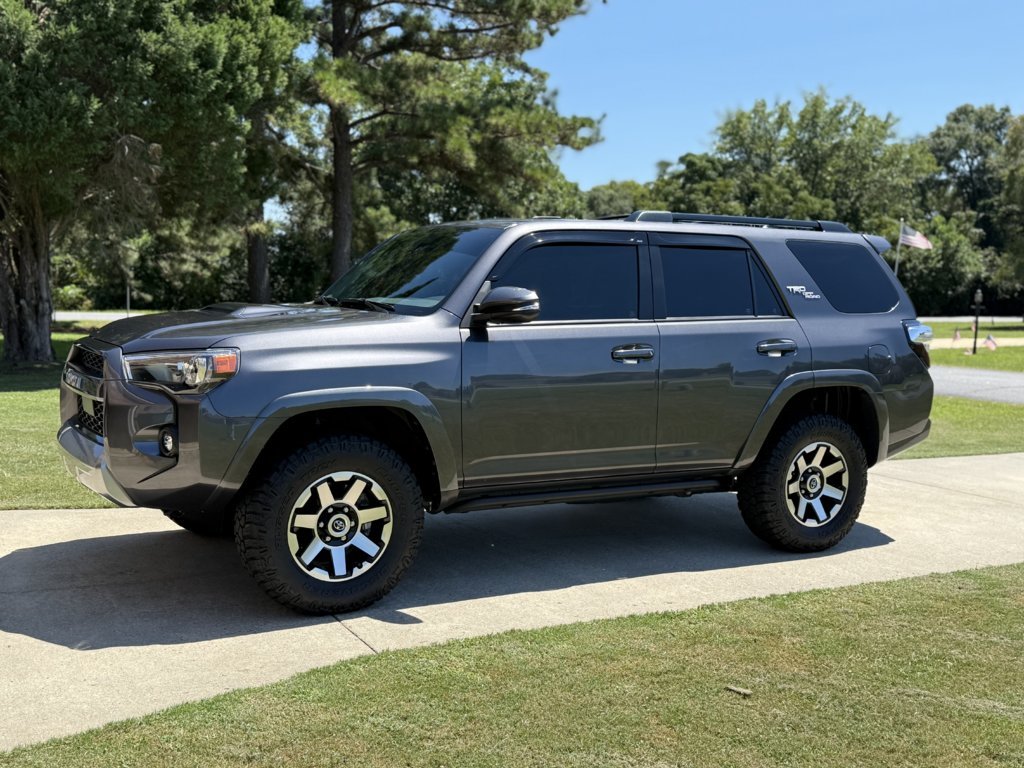

    2 years later….finally updated my wheels…..Method 703 in Gloss Titanium
    IG @oldmanyago8541

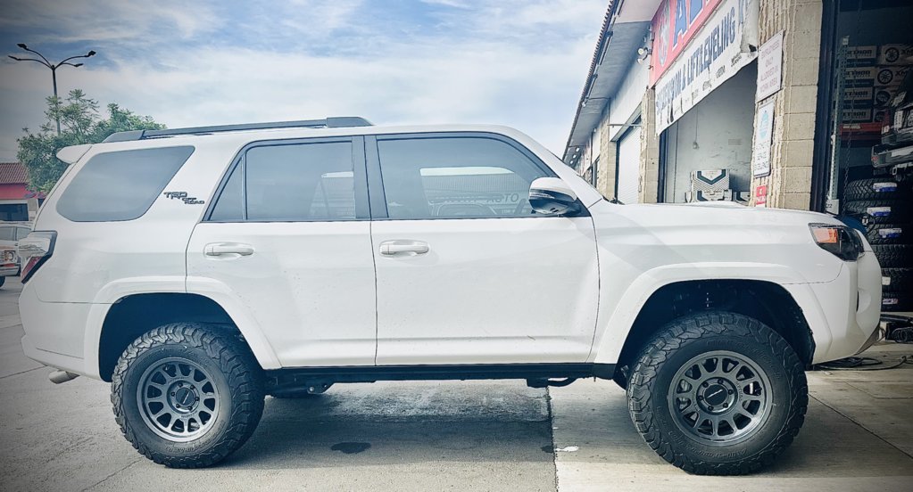

  10. Aug 27, 2025 at 8:31 PM
    Tahoe
    Tahoe New Member
    Jul 10, 2025
    #47993
    95
    2024 TRD PRO
    Westcott Designs lift/level 285/70r17 Nitto RSG rails
    I just got done re-seasoning my cast iron skillet. The process sounds eerily similar. I did fluid film last month… maybe I’ll get some wool wax and do step 2. I really like how nothing sticks to my skillet… could be the same thing with my truck. It’s really satisfying when you do a good job of it.
    nimby likes this.

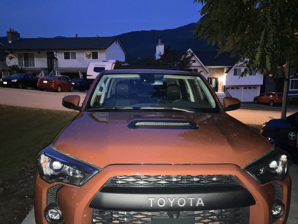

  11. Aug 27, 2025 at 8:31 PM
    BC Hunter
    BC Hunter New Member
    Jan 27, 2024
    #38149
    110
    Paul and Jane
    Kootenays BC Canada
    2024 TRD Pro-Terra
    Stock so far…..except better tires.

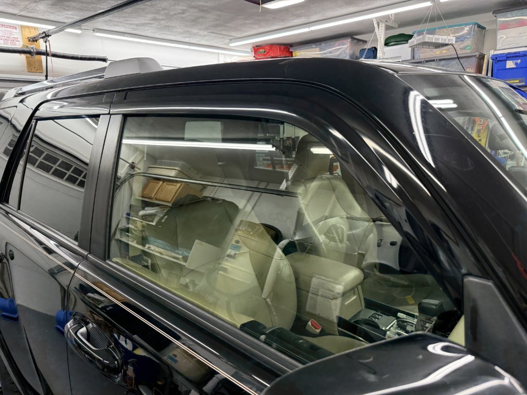

    IMG_1057.jpg After a trip through the Rockies, and some bushwhacking, and some long-ish highway commutes...all on roads that haven't seen rainfall for weeks...it was time to seriously clean the windshield.
    I assume they also have something similar in the states, but we use Allen's cleaning vinegar. 10% strength, and gets the glass squeaky clean. Have to rinse thoroughly to make sure none stays on the vehicle, but I was washing it anyway.
    Photographing clean glass.....now that's a trick....

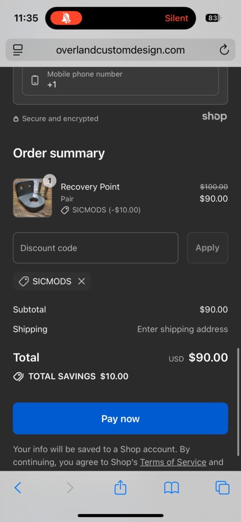

    ya bud
    https://overlandcustomdesign.com/products/copy-of-recovery-point
    *bolt thread is M12 x 1.25

    Ordered a pair. For anyone interested, use “sicmods” for a discount :)
