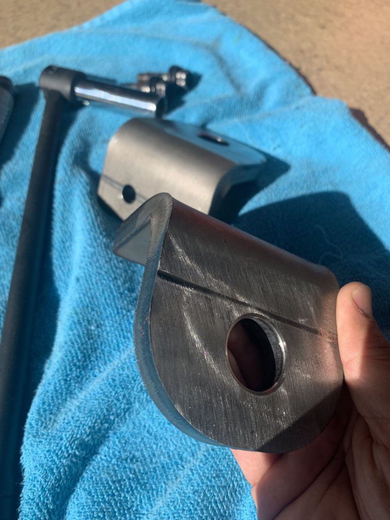

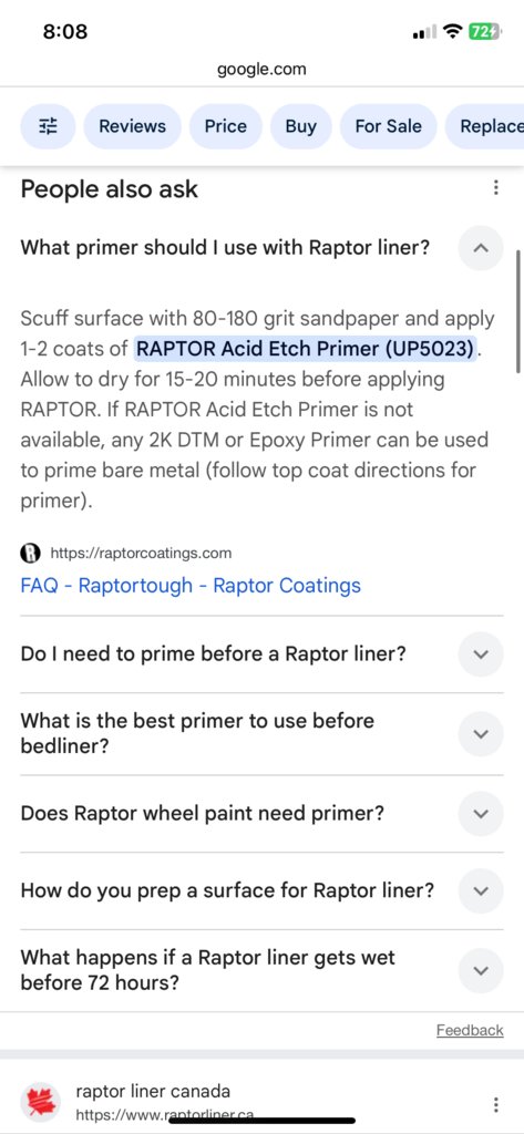

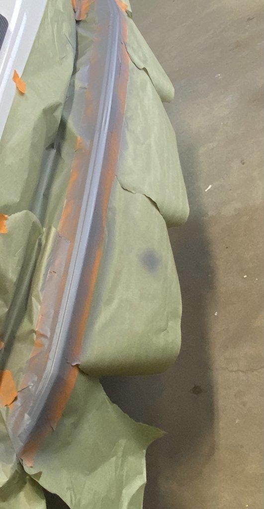

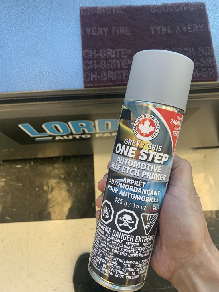

    What sandpaper grit and sanding method do I use (by hand or tool) for raw steel that will be getting mild degreaser and then Raptor etch primer? Thanks
    photo for attn:

    I feel for you for all you have to do in BC to protect steel...I don't know what prep @water used on the one he used, and/or the one he didn't, that I bought from him, but here in NM I could mount them bare steel and call it done.

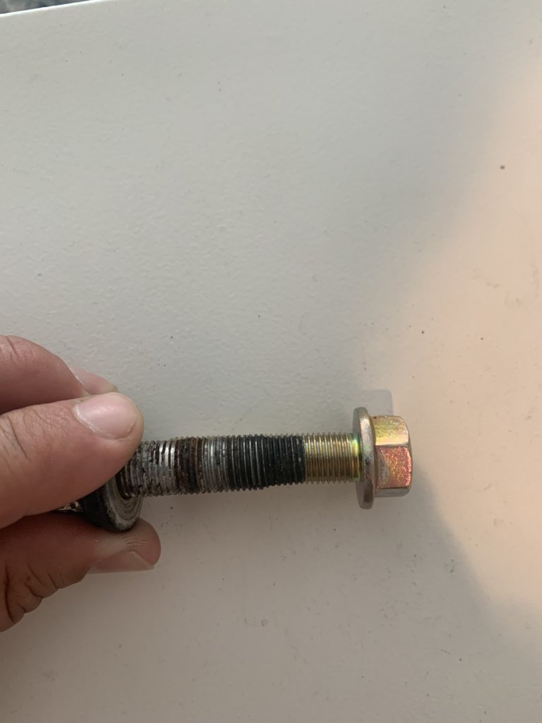

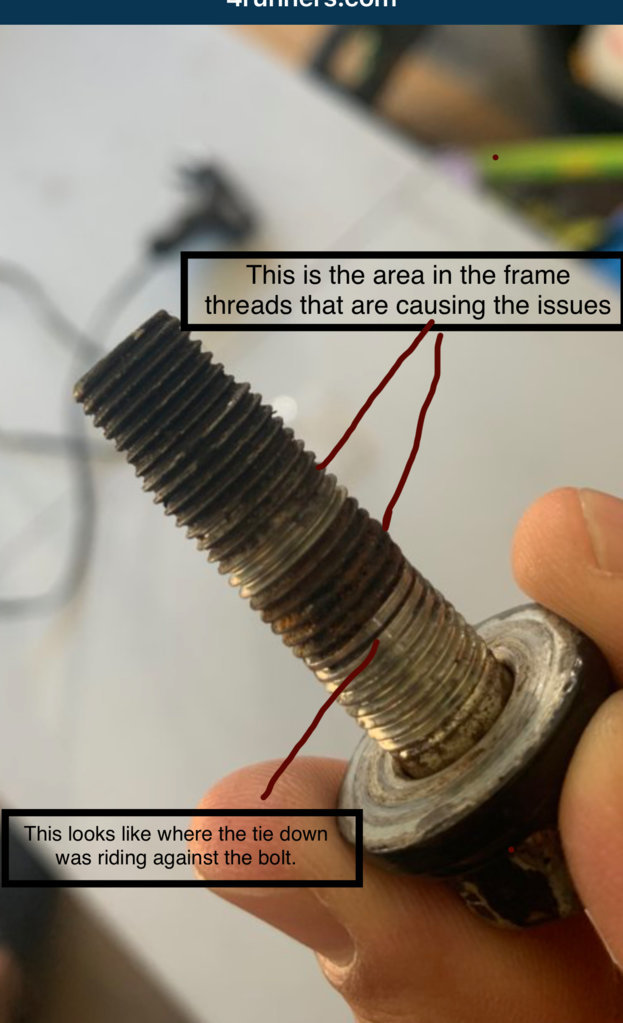

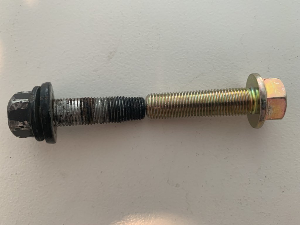

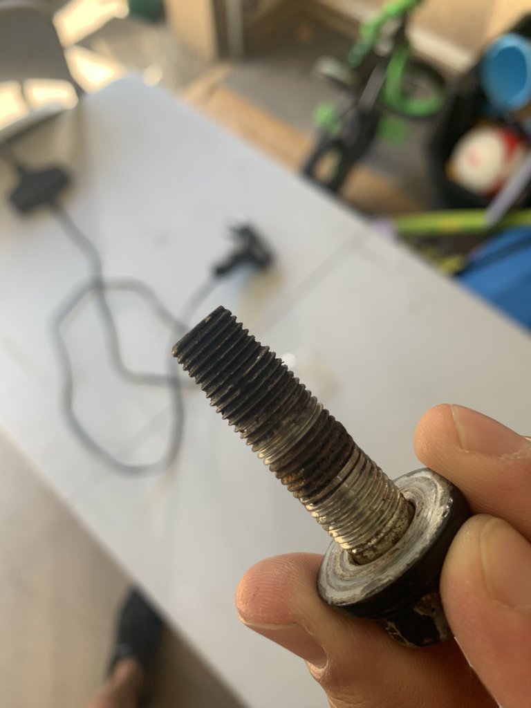

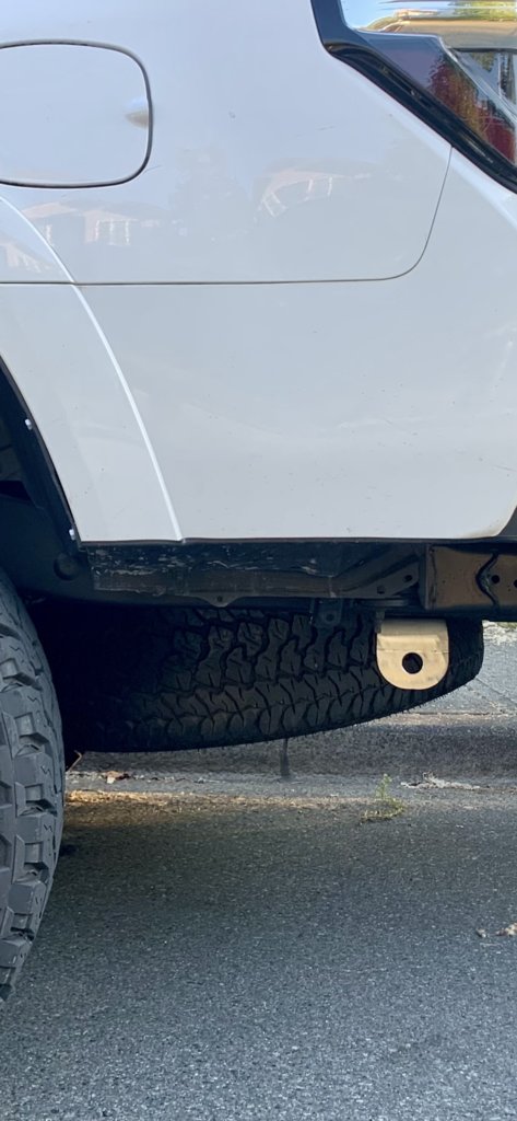

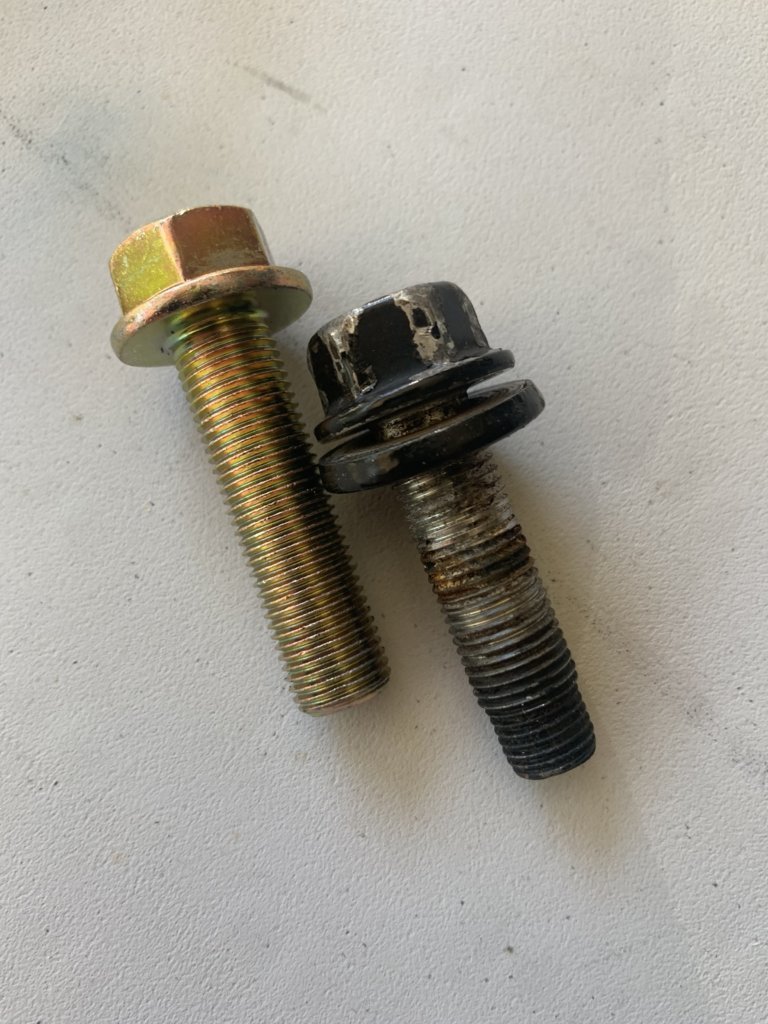

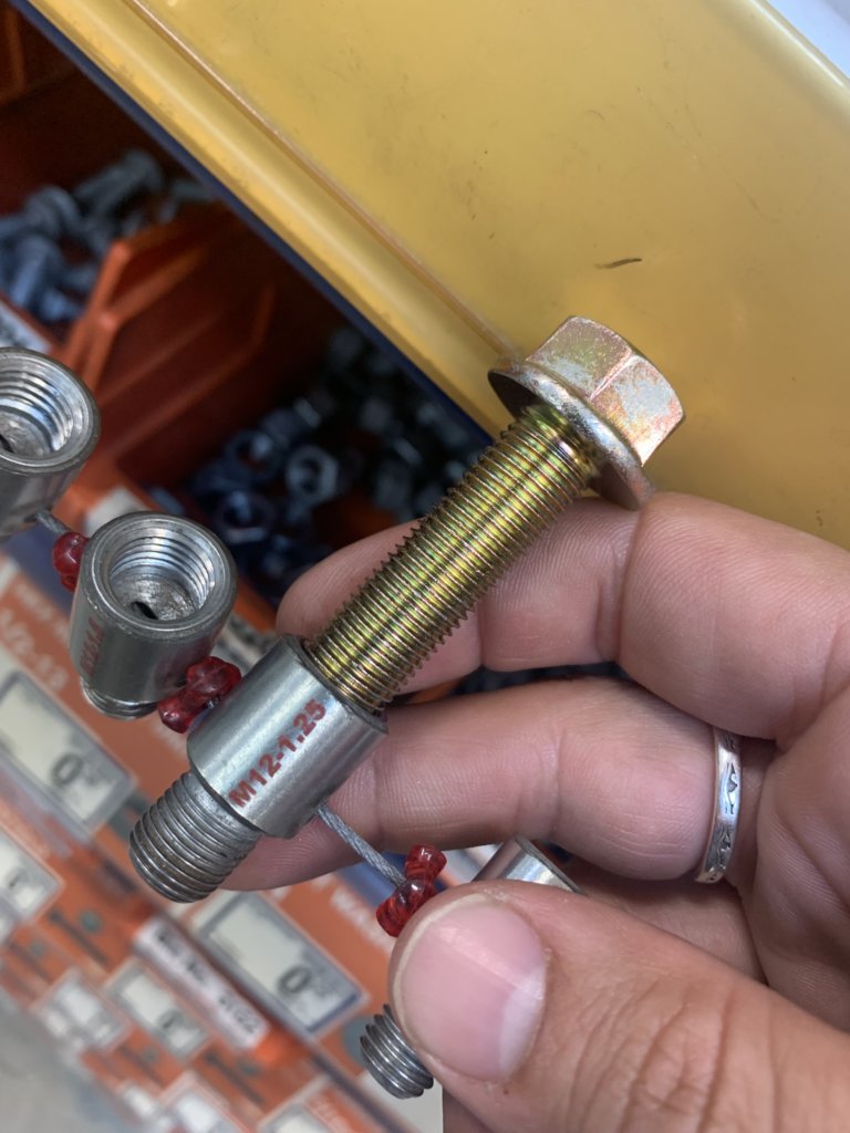

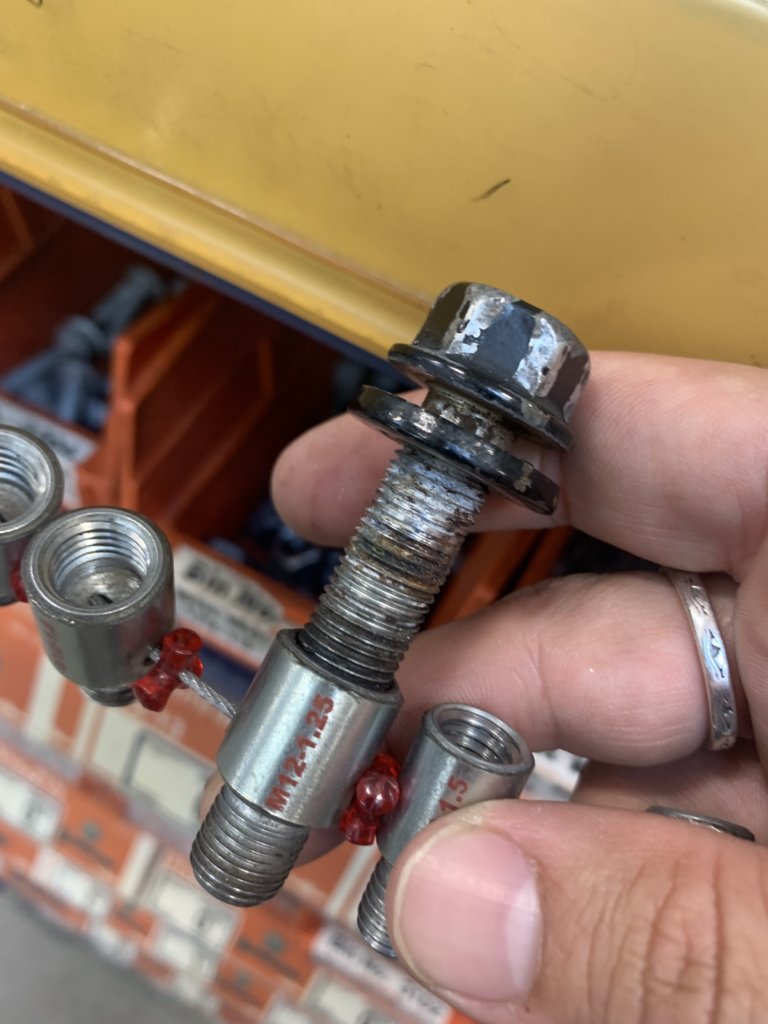

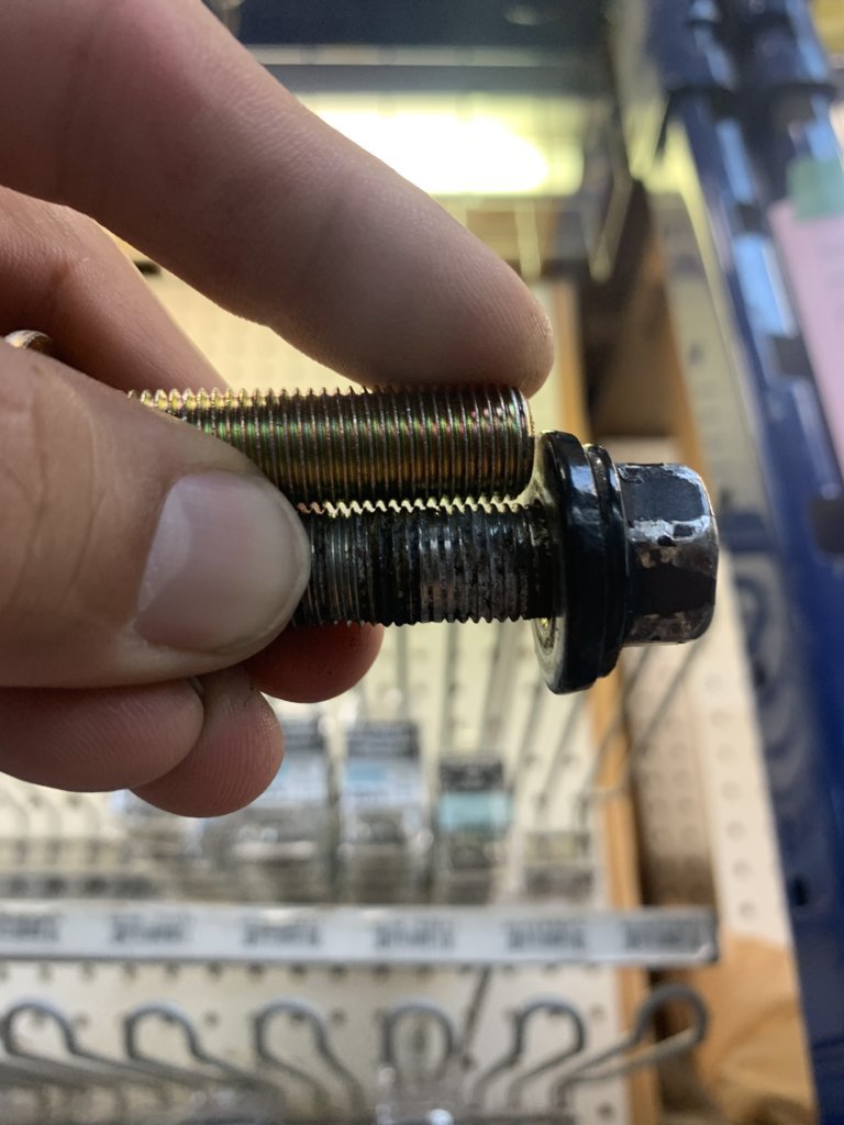

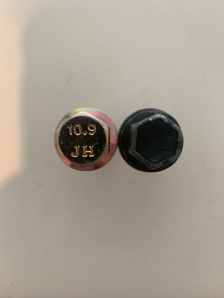

    Both factory bolts look like this first time removing rear frame tie down hook.
    Is this a certain type of tapered bolt or what am I looking at, it doesn’t necessarily look like thread strippage?? The new fasteners don’t have this and don’t seem to fit (easily)..

  7. Aug 2, 2025 at 12:40 PM
    836
    I don’t know what that OEM style bolt is called. As long as the threads match new bolt to OEM, you may need a thread chaser to clean up the frame threads so your new bolt goes in clean.
