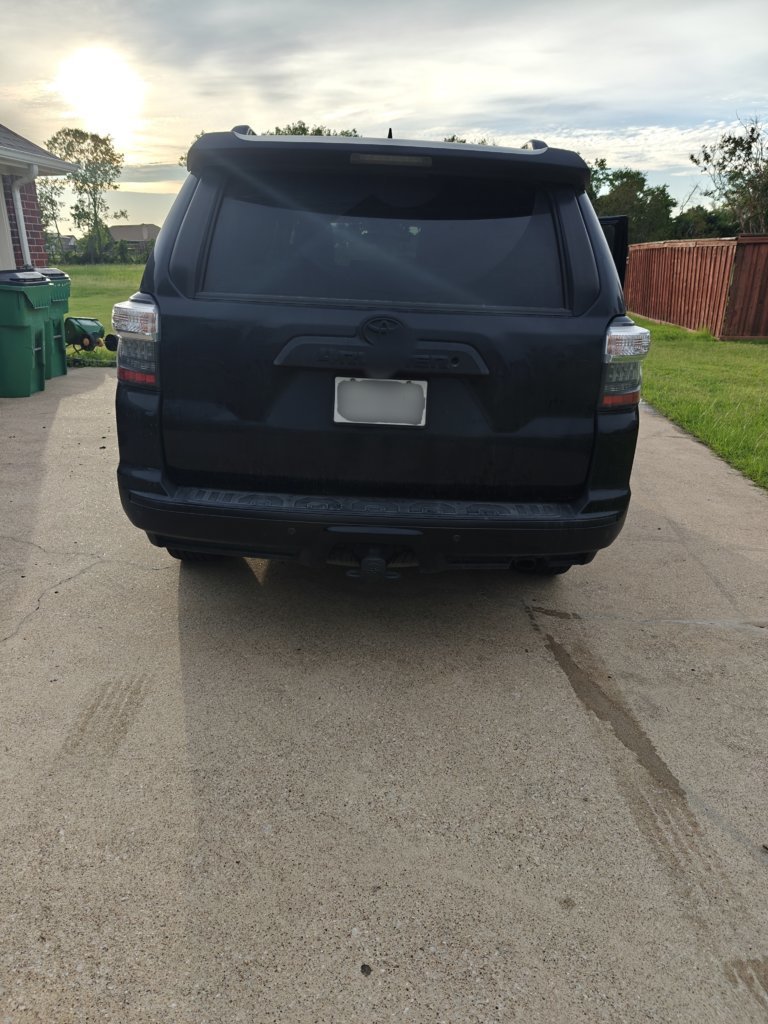

  19. Jun 15, 2025 at 5:56 PM
    Lc200
    Lc200 New Member
    Jun 16, 2023
    #33430
    1,227
    Pre Facelift SR5P
    Re installed the original taillights with the older design. With a million of these on roads, the pre facelift 4runner is still a little rare.
    NeverTooLate71, playdixie and Henry J like this.

  23. Jun 15, 2025 at 7:09 PM
    4runningMan
    4runningMan New Member
    Sep 23, 2018
    #7255
    2,860
    New Mexico
    Those old ones are my fave! Do you know if they'd be plug and play on a 2022? Or do the 2022 LED's make that not possible?
    djwantke likes this.
  24. Jun 15, 2025 at 7:12 PM
    Lc200
    Lc200 New Member
    Jun 16, 2023
    #33430
    1,227
    Pre Facelift SR5P
    They should be plug and play. The size, clips and connectors are all the same. There is only 1 plug that connects to the lights so it should be a direct swap unless they changed the plug type in 2020+ models.
    djwantke and 4runningMan[QUOTED] like this.
  25. Jun 15, 2025 at 8:39 PM
    4runningMan
    Sep 23, 2018
    #7255
    2,860
    New Mexico
    The 2022 has a separate bulb for reverse. Are you suggesting there's one for reverse and one for everything else?
  26. Jun 15, 2025 at 8:43 PM
    Lc200
    Lc200 New Member
    Jun 16, 2023
    #33430
    1,227
    Pre Facelift SR5P
    I am saying that there is only 1 connector that connects to the back of the light that lights everything up.
    The light has 3 bulbs, one each for brake, reverse and indicator but all three work through just that 1 connection.

    Not certain but I don't think that's plug and play for a 2022, due to the separate connection for the reverse bulb.
