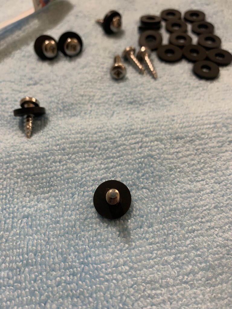

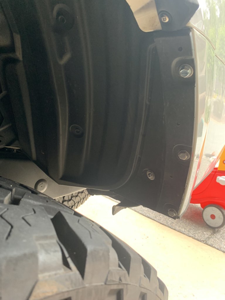

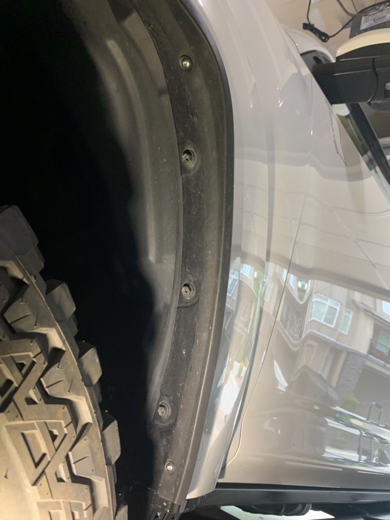

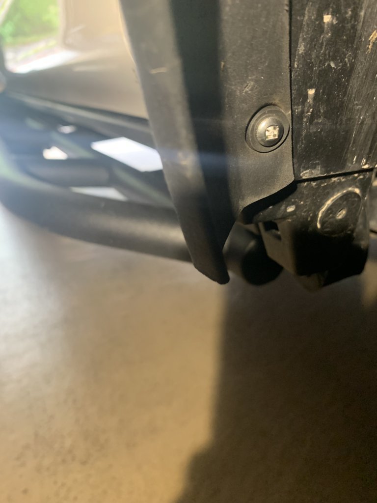

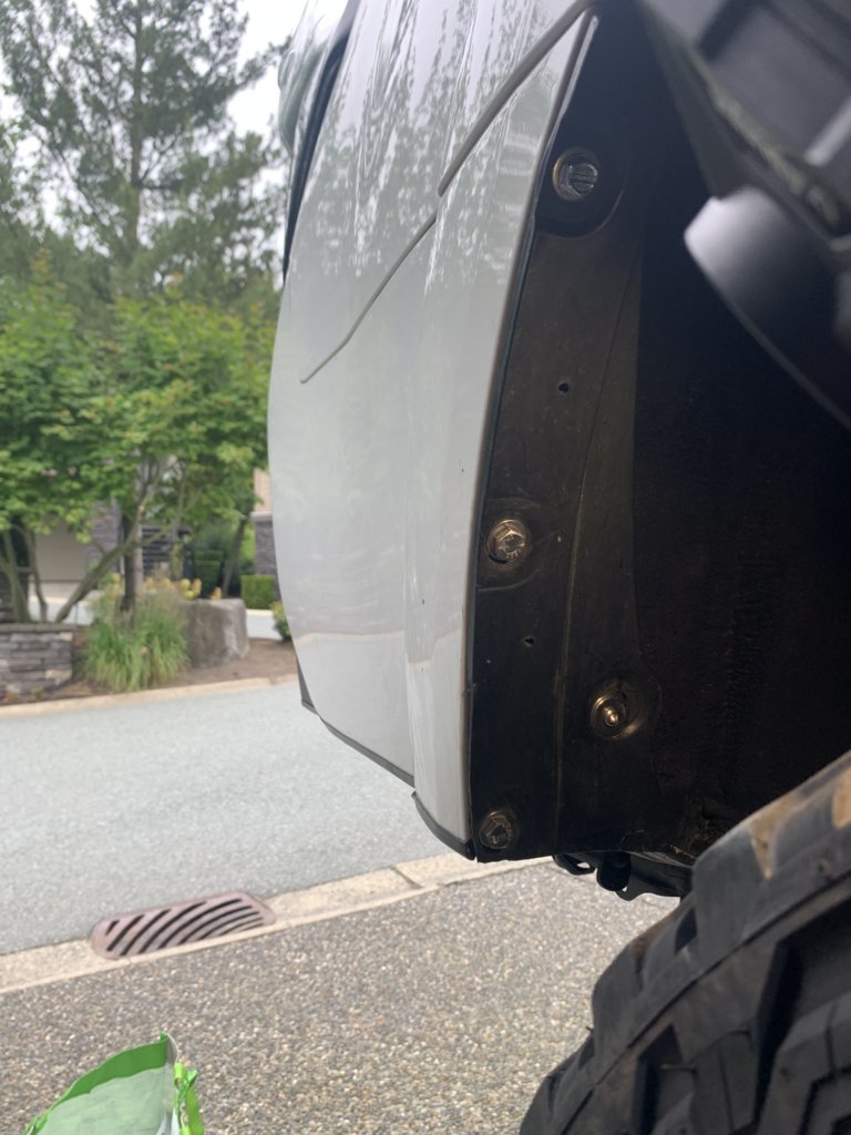

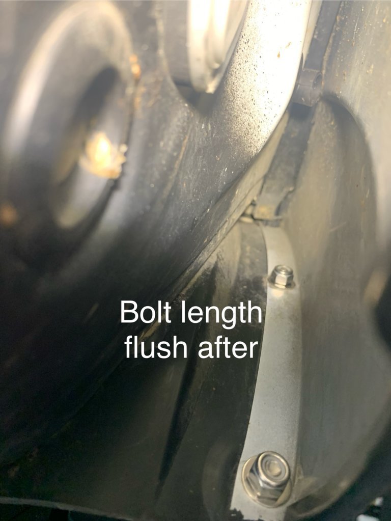

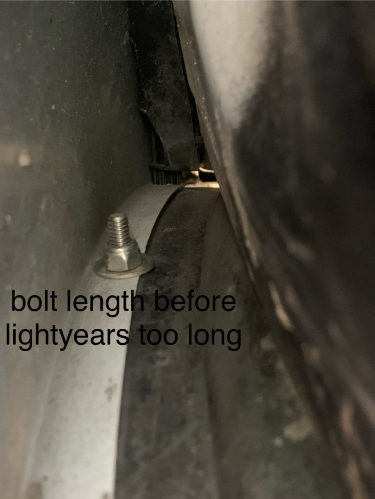

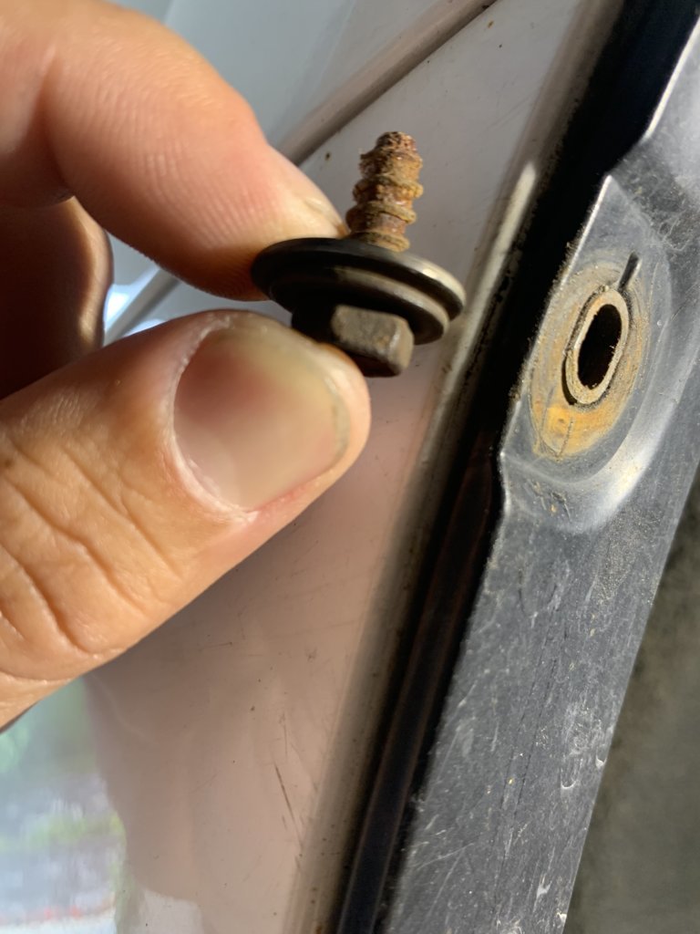

    my 4 yr old helped me complete the inner fender SS hardware swap on all four corners. stainless is so satisfying
    EZ Flares (in addition to the 3M):
    18x #8 x 5/8” SS pan head metal screw
    18x 3/16” black rubber washers
    Brand: Reliable Fasteners
    Rear fender liners:
    *2x 1/4” diameter x 5/8” 18.8 SS hex lag bolt
    10x 1/4” U.S.S. flat washer
    4x 1/4” x 5/8” 18.8 SS hex bolt
    4x 1/4” 18.8 SS nylon lock nut
    Haney Builder Supply

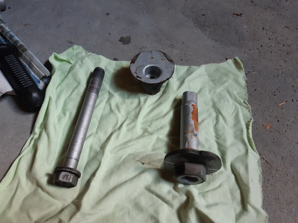

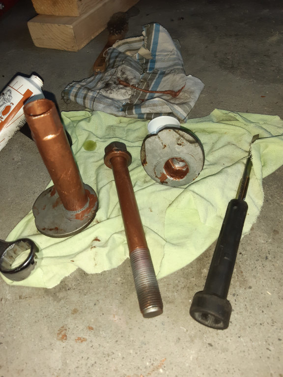

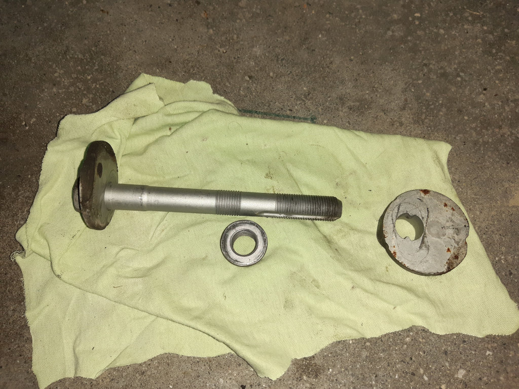

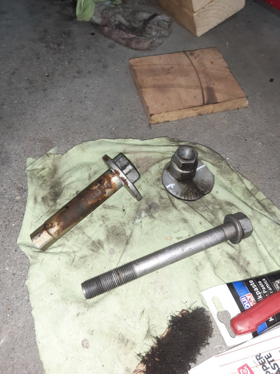

    Anti-seized the cam bolts and sleeves on the lower control arms.
    How the parts are preserved with age can be seen in the pictures. 2019er 4-Runner, last two winters in heavy road salt.
    The problem are less the bolts but the sleeves which rust in the rubber bearings of the LCAs.
    On the passenger side the sleeve was already rusted tight. Let rust penetrant work overnight,
    heat up a few times cool down, a few hammer blows later, suddenly it came loose after all.
    That was probably the last chance to get them apart.
    Driver's side still came apart without any effort
    Passenger side already frozen
    Anti-seized, also coated the sleeves in the rubber bearings
    Don't forget: mark the position of the cams before disassembly. Finally the car with the wheels on the ground to tighten the bolts to torque (as the rubber bearings are clamped and cannot rotate).

    Nice write up on predictive/preventative maintenance !
    Question: Did you sand the rust off of the inside of the sleeve before reinstalling?
    Seems like that would have been one of your steps, but you never mentioned that.

    I just scraped out the rust in the sleeve of the rubber bearing with a screwdriver, then pushed a cloth through it a few times. Finally lubricated the inside with copper paste.
    Outside of the cam sleeve i cleaned with a steelbrush, before lubing.

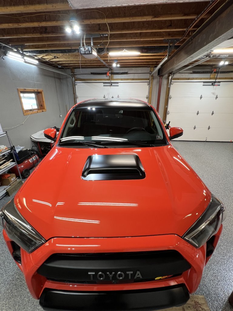

    Got the ceramic coating done. Omgosh, the reflections!

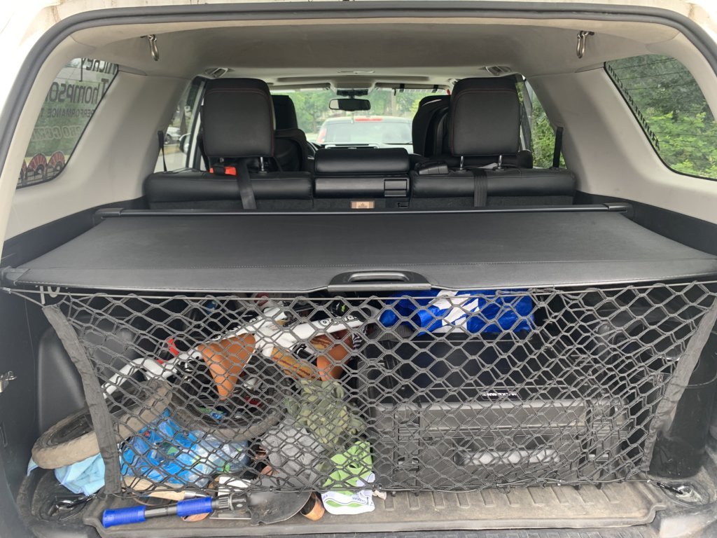

    pulled the retractable cover out of the archives circa 2017, kinda missed it actually

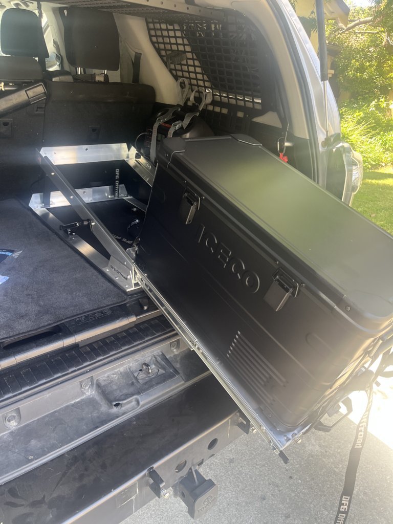

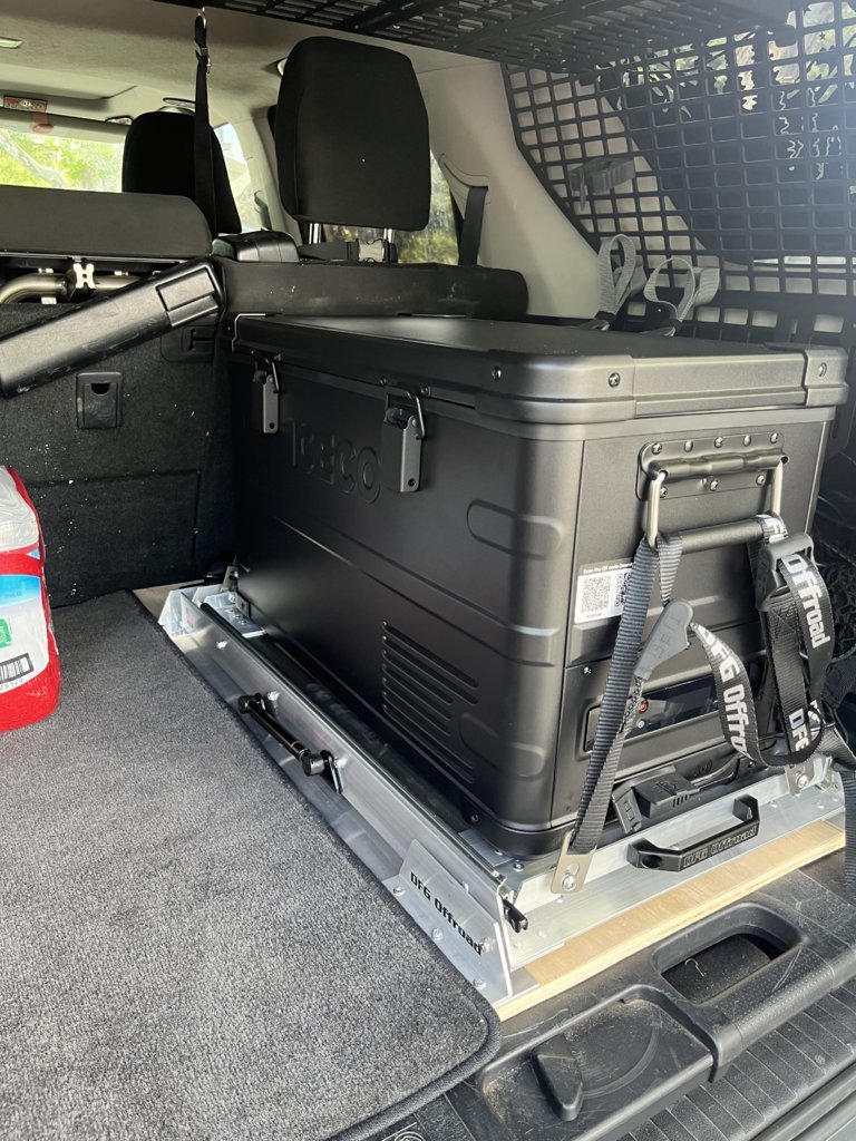

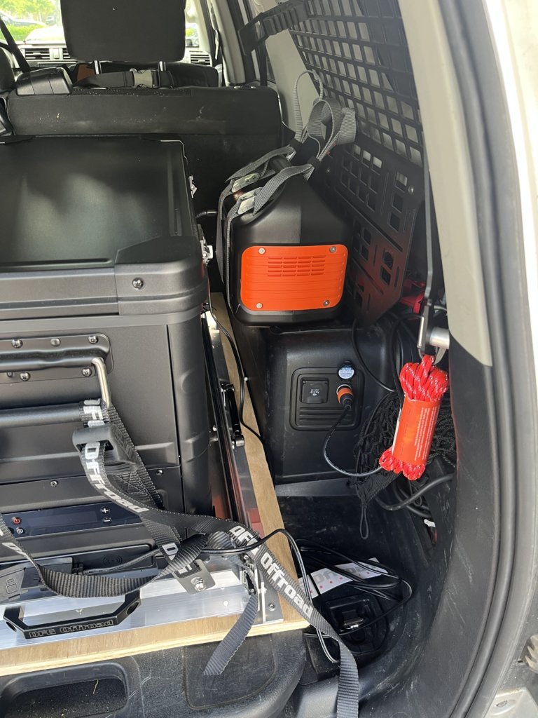

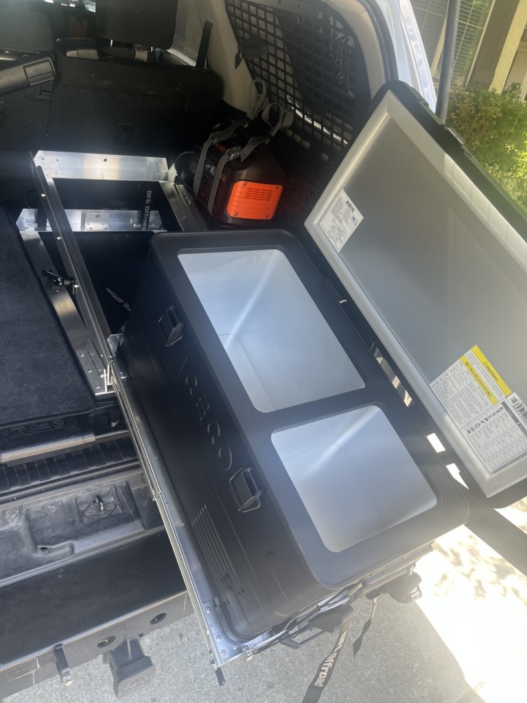

    Got the Iceco loaded up on a my new tilting slide and pulled the Jackery into the solution.
  14. Jun 14, 2025 at 4:12 PM
    5,008
    So you connected the slide to some plywood. Did you connect the plywood to that sliding platform under it?
    If so, how?
  15. Jun 14, 2025 at 4:59 PM
    Henry J
    Aug 8, 2020
    #15986
    875
    Sacramento Ca
    Yup!
    I popped the panel off of the slide and removed 3 m12 bolts. I went to Ace and got 3 more bolts that are longer and drilled holes through the plywood to align with the holes in the slide.
    I’ve done this 1 time before because Aiden James SUCKS and never sent my platform. So I made my own. Tomorrow I’ll sand it down one more time and then paint it black.

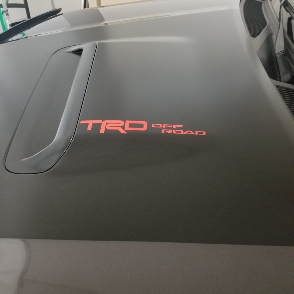

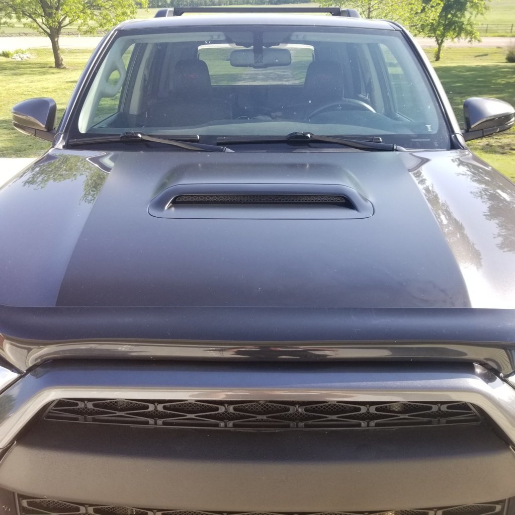

    Wait until the sun beams off the pretend hood scoop. I wrapped half my hood in satin. It adds a bit of contrast but eliminates the glare.
  17. Jun 15, 2025 at 4:46 AM
    850
    Yessir, that glare is going to be fierce.

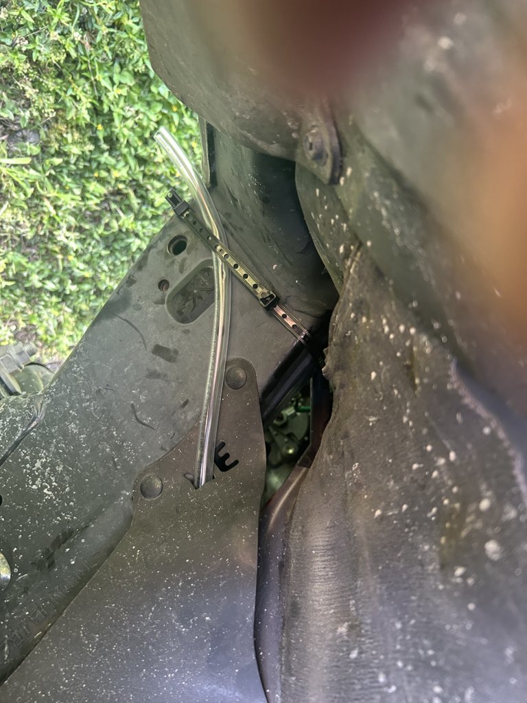

    Mission accomplished on the condenser line! Went EA on things (extra anal) and did hose clamps on both ends and zip tied the line to the frame.

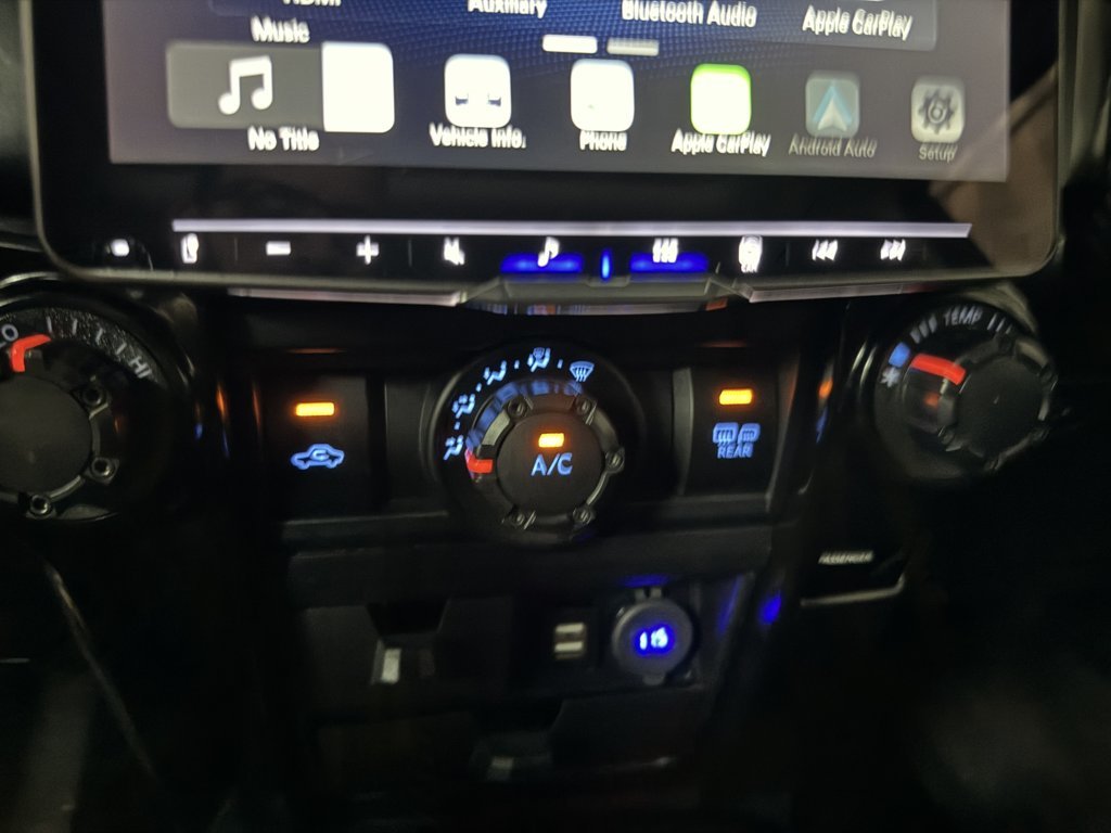

    Got my AC control overlays to complete the dash blackout.

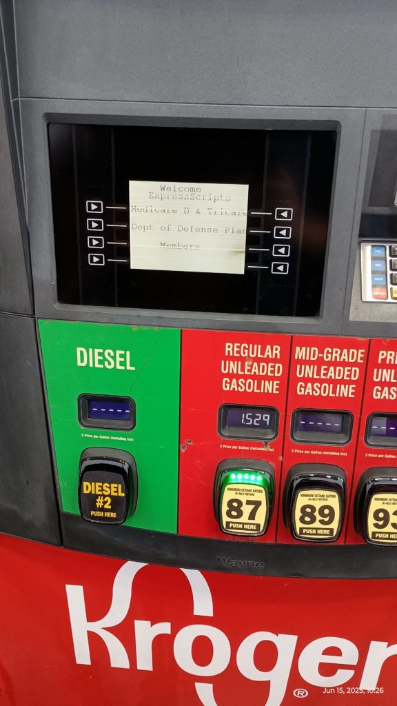

    Welcome to the Sunday round of "Why Borracho Loco is awesome".

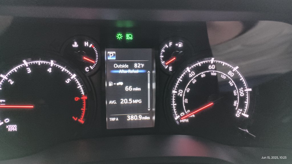

    I averaged 20.5MPG for the tank average (I got higher MPG's for trip averages) and then got gas for $1.52/Gallon - 87 Octane. I had 66Miles until empty and I had driven 380.9 miles.
    Getting 446 out of a tank is really impressive (if I went the distance and emptied the tank, that is).

    All set now

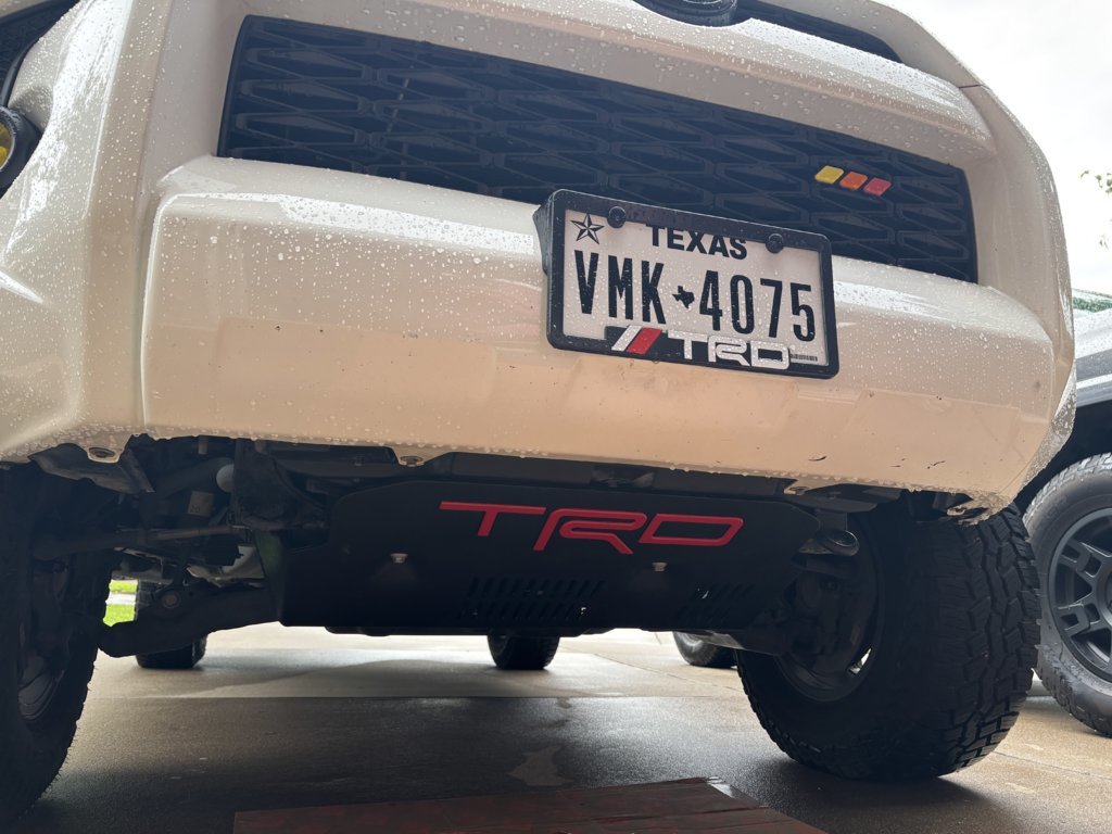

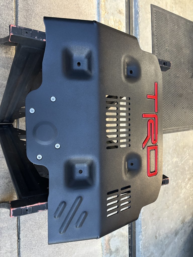

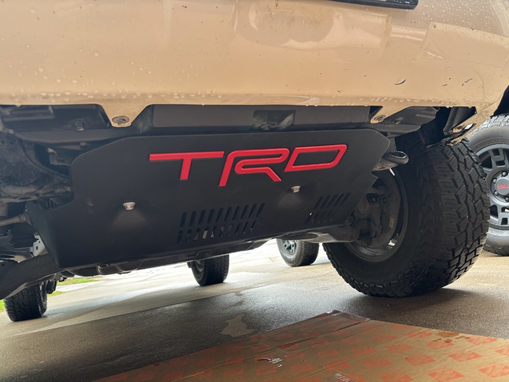

    Picked up this TDR skid plate of Facebook marketplace and painted it black. Got it installed today between rain showers. I ended up reusing the factory bolts for the two rear locations as they seemed to work just fine and weren’t as long as the bolts that came with the skid.
    I also reused a portion of the plastic air dam as I didn’t like the big gap that was left when it was removed. I trimmed it off so the posts from the back of the TRD letters had clearance then installed it before the skid plate.

    Looks good but why didn’t you use the factory bolts that came with the skid ?

    Do you hand calculate your gas mileage too? My wife does when we take trips in my truck, the wish-o-meter is usually spot on.

    I had read that the bolts are too long and can create an issue long term with the threads stripping. I just reused the bolts that came off the support bracket on the 4Runner. I’ll make sure they stay torqued and swap them if needed.
