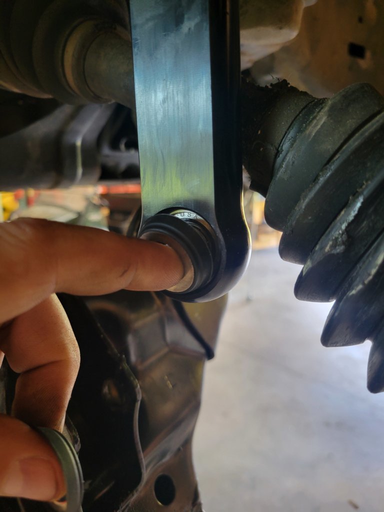

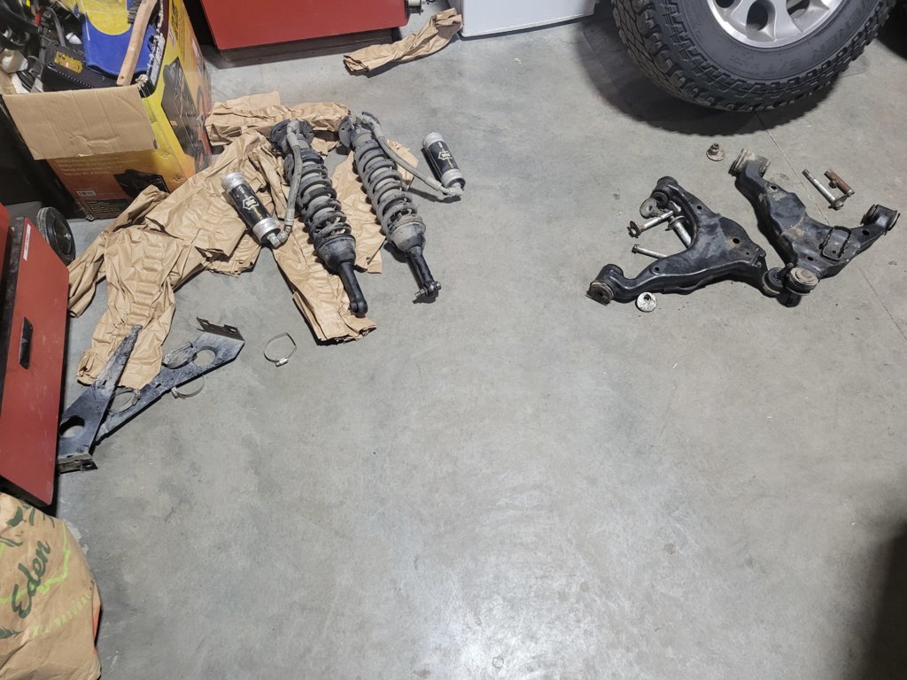

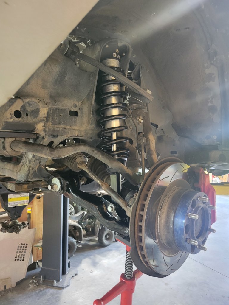

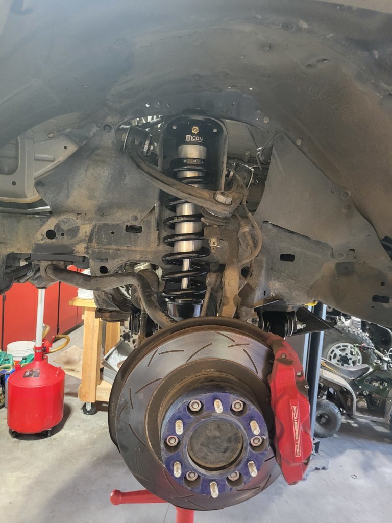

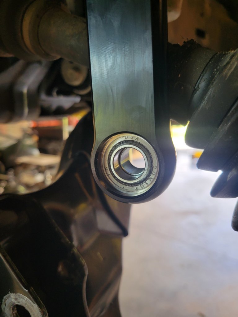

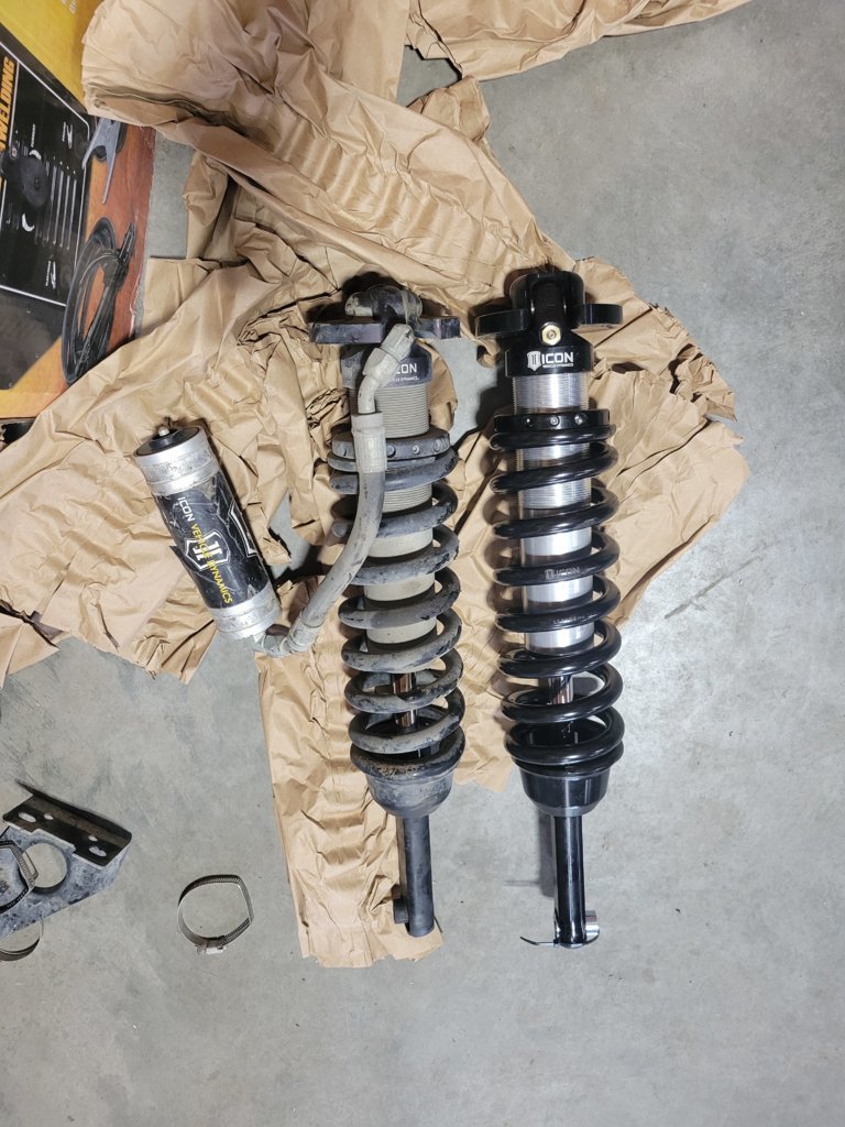

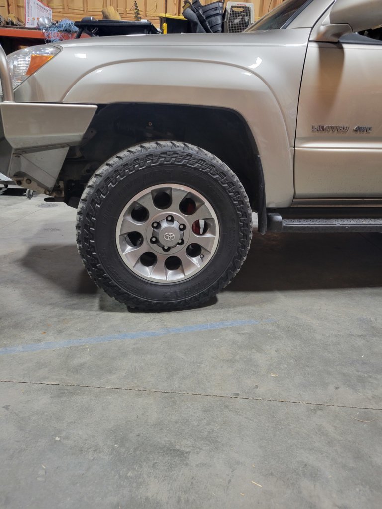

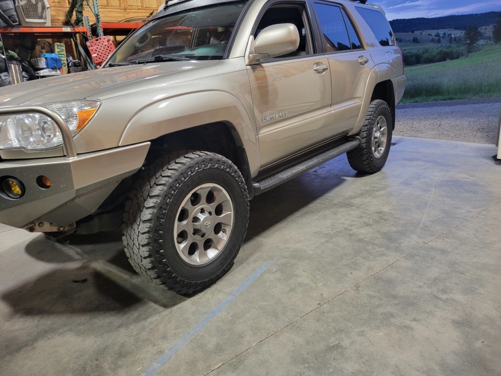

    The coilovers came in and I threw them in and torqued everything down. I think they're a bit better for my use-case. I also attempted to throw the seal kit on the rod ends and the tolerance was a bit tighter than I wanted so I left it nakedness I'll rebuild the lower rod ends on the 2.0s and post them up...my alignment is 5 weeks out...yowza!

    She's driving better now and straight! My pseudo alignment will work until the pros take it. The tire gap is awee bir lower on the front then previous, but we'll within my tolerance. The previous setup had a 3" space newfound to collar and spring ring, this is at 2.5"...

    Looks great to me. I like it at 2.5” of lift

    Thanks! I too like it...if it drops much after settling, I might crank it up a couple rotations...right now, she's clunk free and tight!

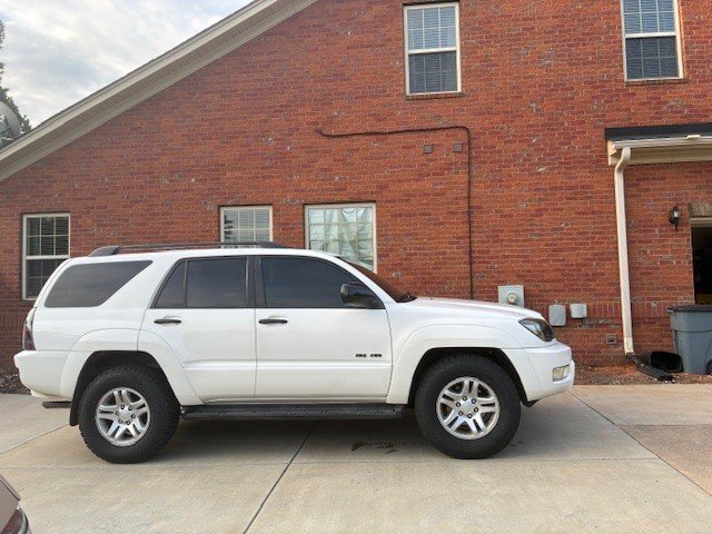

    Slacking, but here's the 265/70/17 A/T III's on Tundra wheels from Saturday.

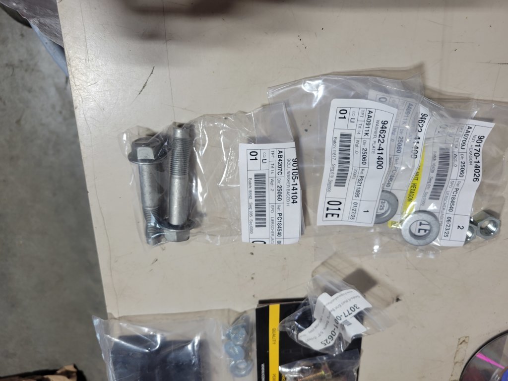

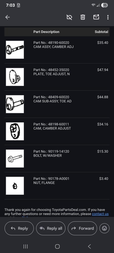

    Are these the LCA bolt PN's? I've got a torn boot and considering replacing with a Freedom Offroad upper/lower kit and wanted the OEM bolts for alignment purposes.

    Yes sir those were ordered from ToyotaPartsDeal.com as they had the best pricing o could find:

    Presumably two of each? Apologies, I'm not super mechanically inclined but logic would lead me to believe two of each as one for each side?

    Oh, you're good! Yes, x2 each...the total shipped was $191.xx - ugh! I had no extra things i didn't need, though and am happy with the results!

    Thanks so much for that! Looks like I can get them all from Partsouq.com for $124 shipped.... Score!

    Badass! Good luck and use antisieze or Vaseline on the threads and you'll never have any issues with them getting locked up!

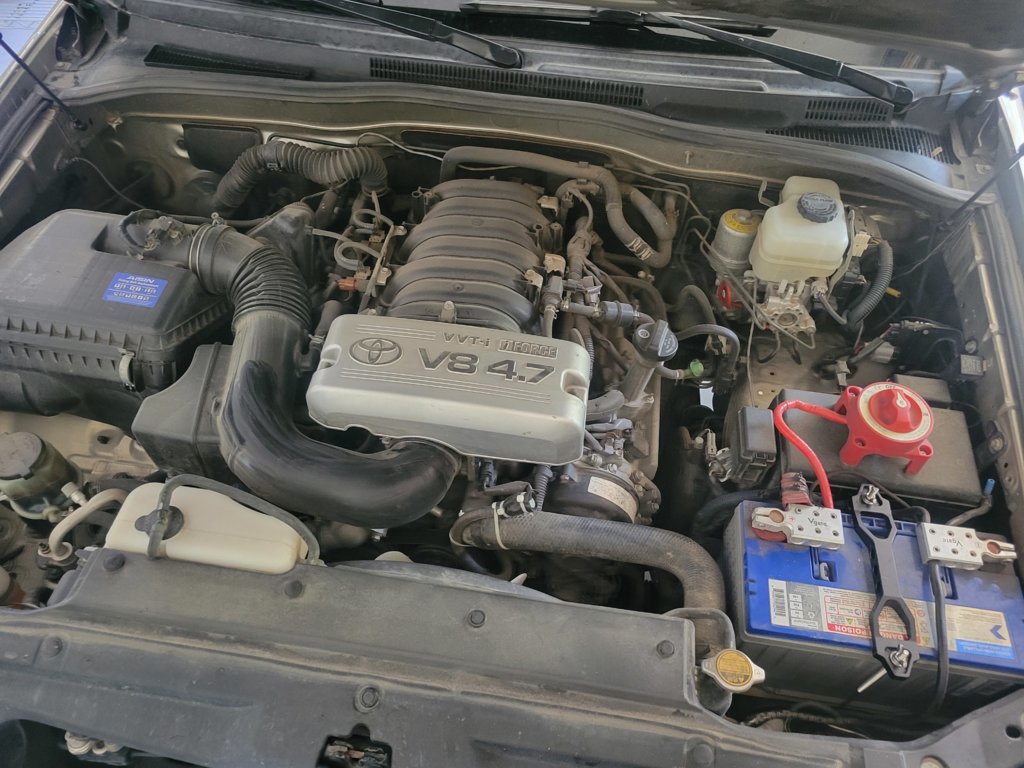

    Nothing too special...I retired the OEM battery hold down...$11 makes me holla'!

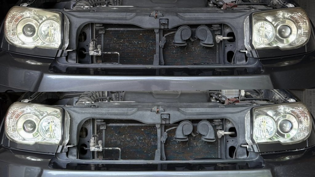

    Used the Cerakote Kit again just this morning, current headlights are from FB Marketplace & OEM. I will probably bite the bullet next year and get a new OEM pair + clear PPF for longevity.
    Just tried to get most of the yellowing gone around the edges due to age & Texas sun.

    That kit only lasted a few months for me. I bought a cheap drill sanding kit from Amazon and it worked wonders. Need to apply 2k clear coat though after sanding or else they stay really dull and cloudy.
