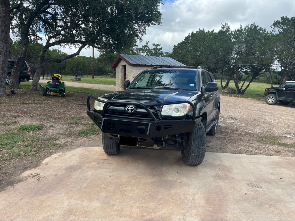

    I trimmed mine and on one end I had a weird squeak/rubbing sound so I put some bilaterally cut pipe insulation on it and it's pressure fit into the wings of the bumper and now look more factory and helps protect the front end goodies akin to the intent of the OEM bumper...I'd trim it or fold it under for best results.

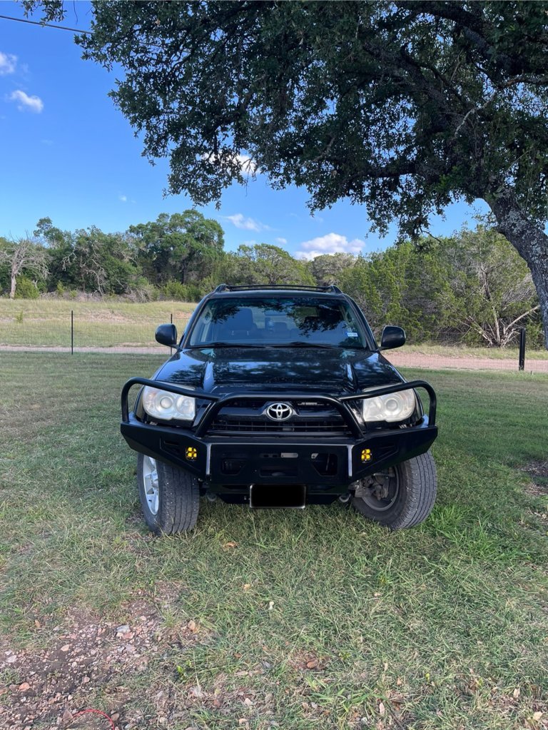

    Got the new bumper on. I ordered some baja designs lights last night. I might also add a pair of piaa 510s in the middle

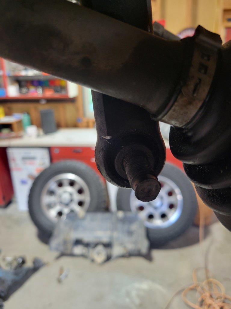

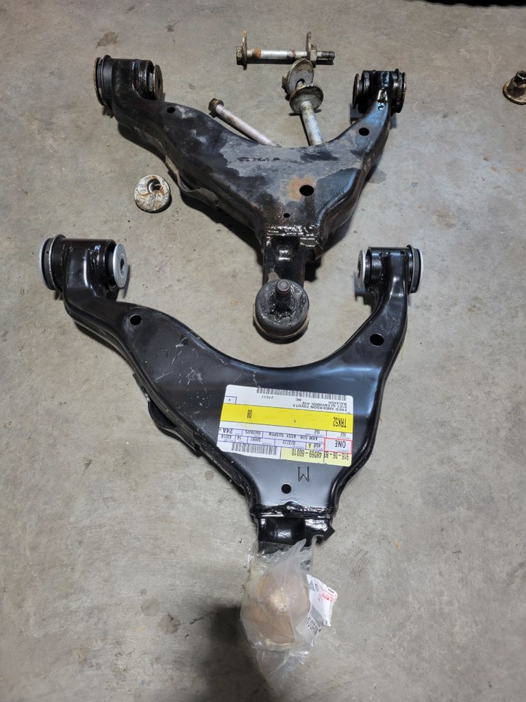

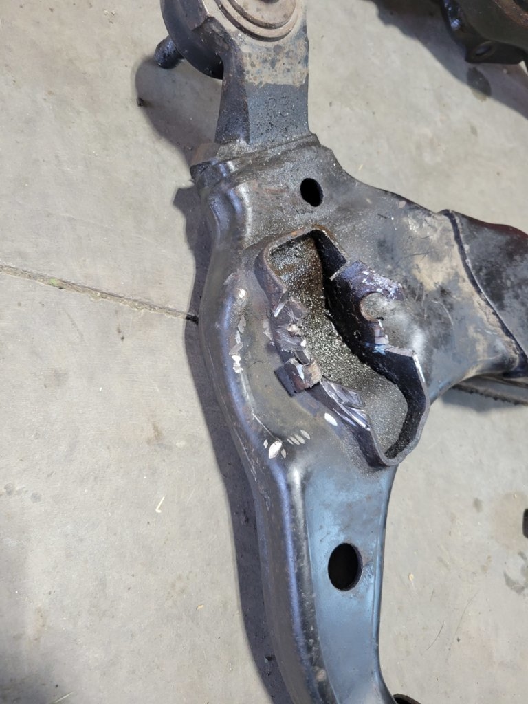

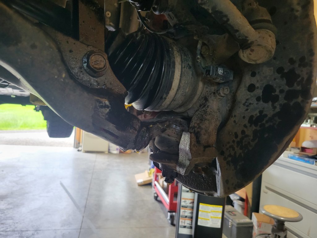

    I started the process of LCA removal...only one sleeve that didn't slide out...OEM and salt free for the win! However, my lower Icon shock connection on both shocks are siezed...what a f'n disaster! I had to cut one of them out and refuse to wait for a rebuild on the remote resi Icons...the one bilt ive never had any issues with on any car, rust ladened or brand new, the shock bolt into the LCA! I was prepared for the LCA bolts to be the tough ones and they came out easy and still looked fresh! What can I buy, potentially local, that will work? Taco suspension? Do they lift a 4th gen a couple inches up front? Awwwe! Unexpected challenges make you, right?! :annoyed:

    Well, I tried everything to get this bolt, that's supposed to slide out, to come outta the shock mount...air hammers, pipe wrench and impact to push it through, nothing has worked...I'm SO annoyed at that but what can I do...Ha! I have, however, supplied a fair amount of anti-seize on all metal on metal instances on the LCAs and will be doing the same on the new Icon 2.5 VS coilover I was forced to order...WAAAY more money than I wanted to spend...I was going to try the Ironman FC 2.4 coilovers but I'd rather keep the FSB for onroad driving my wife will be using the 4runner for...Oh well, prices sure have gone up since just last year, even! There's a 25% sale going on with Icon and I've been happy with the 2.5 IR VS coilovers on my Tundra, so I figured I'd try them for the 4runner...I hope to get this this week to throw them in, but that too, is outta my hands...more to come!

    Another option is to remove the entire bearing and replace new bearing, clip and misalignment spacers.
    LOSTR4[QUOTED] likes this.

    True on the bearing replacement...one thing I've learned with remote reservoir suspension is they require WAY more rebuilds and money than I have time and value to do so on...I went with a new set of Icon 2.5 VS coilovers...I'm REALLY hoping they show up this week so I'm not down and relying on others for rides! :p Either way warranted waiting...so I opted to spend more with "less time" for installation...We'll see how she shakes up!

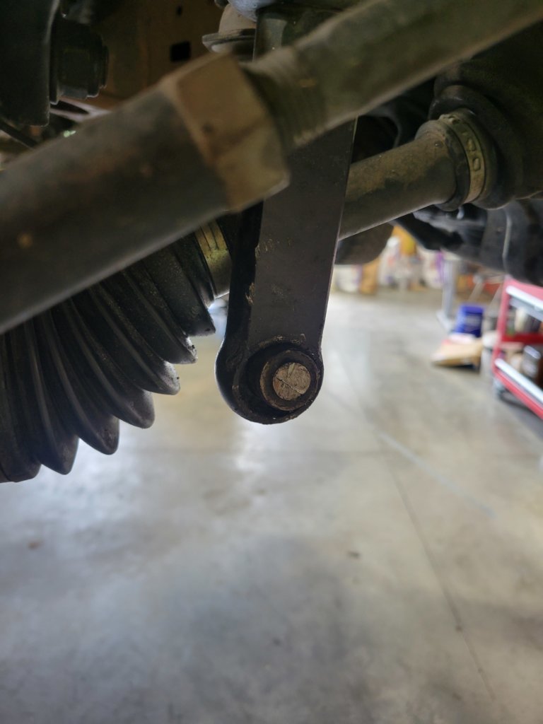

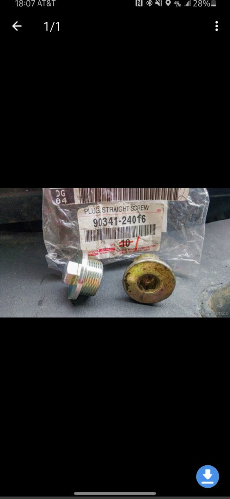

    Did my 260k oil change and driveshaft(s) greasing. TRIED to change my front diff fluid, but could not get the drain plug off. Sprayed with PB Blaster, used a breaker bar with a jack handle as extra leverage, wouldn't budge. I had her up on ramps and didn't have enough room to keep 'bending' the bar until it hit the ground. Need to buy a handheld torch or something and try again.

    Wack the bolt with a ball peen hammer a few times, sometimes the shock is enough. Make sure the fill plug comes out first though!
    Replace drain plug with this when done.

    Ok good to know... i'll try that next time i'm under there. I already have the new Hex nut'd bolt ready to go... was hoping to have installed it yesterday, lol. And yes, the fill plug comes out no problem.

    You could also try heating it up with a small propane torch or some map gas. Be careful of things around it that could be damaged, but I’ve found a little heat goes a long way on stubborn bolts

    After you hit the case W/heat, hit the plug W/Quick Freeze too.
