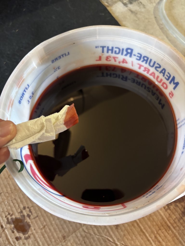

    Finally finished the transmission drain and fill from hell and need some advice. For anyone unfamiliar, there's an overflow plug you remove and as the manual puts it in these scientifically precise terms, "...wait until the overflow slows to a trickle..." then reinstall the overflow plug. It's annoying that they use such a subjective word but anyway, I waited until it was my idea of a trickle - still a solid stream about the diameter of a phone charging cord or a little less. But my glove was slick from the ATF (yes, WS) and I couldn't get the overflow plug seated. It was in but the threads weren't engaged if that makes sense. This went on for about 30 seconds and more ATF was coming out but obviously I couldn't see the stream any more. My take is that it's good b/c it can't have to be that precise or transmissions would be blowing up all over the place. At the same time, it's the transmission and I don't want any issues. Thoughts?
    Also, FWIW, I did complete drain and fills at 114K and 218K. This is my first partial and I'm at 261K so it's been 53K miles since the fluid was new. I thought it looked pretty good. I may raise my interval to 60K or 70K.
    Edit: Someone on another forum suggests changing the filter but I’m not too enthusiastic about dropping the pan, and people who have done it often say there’s not much there. Thoughts on that?

    I just measure the amount of fluid that comes out and put that same amount back in.

    Your idea of a "trickle" is still a stream to me, I think you're good to go.
    The "filter" is not a filter, it's a metal screen, even if I were to drop the pan all I would do is clean it if needed, and all who I have read that did remove the screen said it looked fine, I wouldn't be concerned with leaving it as it is.

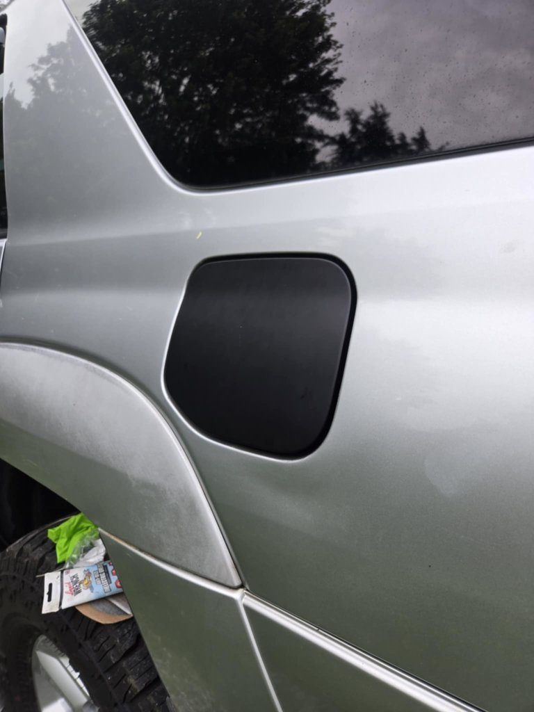

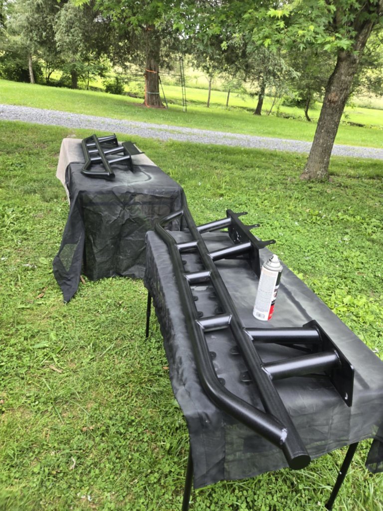

    Not really today but the past few days I painted my CA raised sliders, installed a new fuel door, and installed a prinsu rack.
    I opted for the truck bed coating spray paint from Harbor Freight. Seems like everything I've owned that was powder coated started chipping within 2 years so itll be an easy touch up.
    CygnusX-4, djwantke, UFlaw98 and 3 others like this.

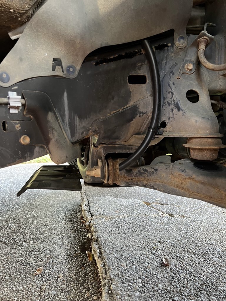

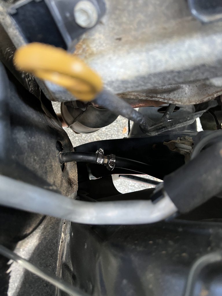

    I finally got around to extending the A/C condensation drain hose. IMG_4621.jpg IMG_4623.jpg

    Nice call!

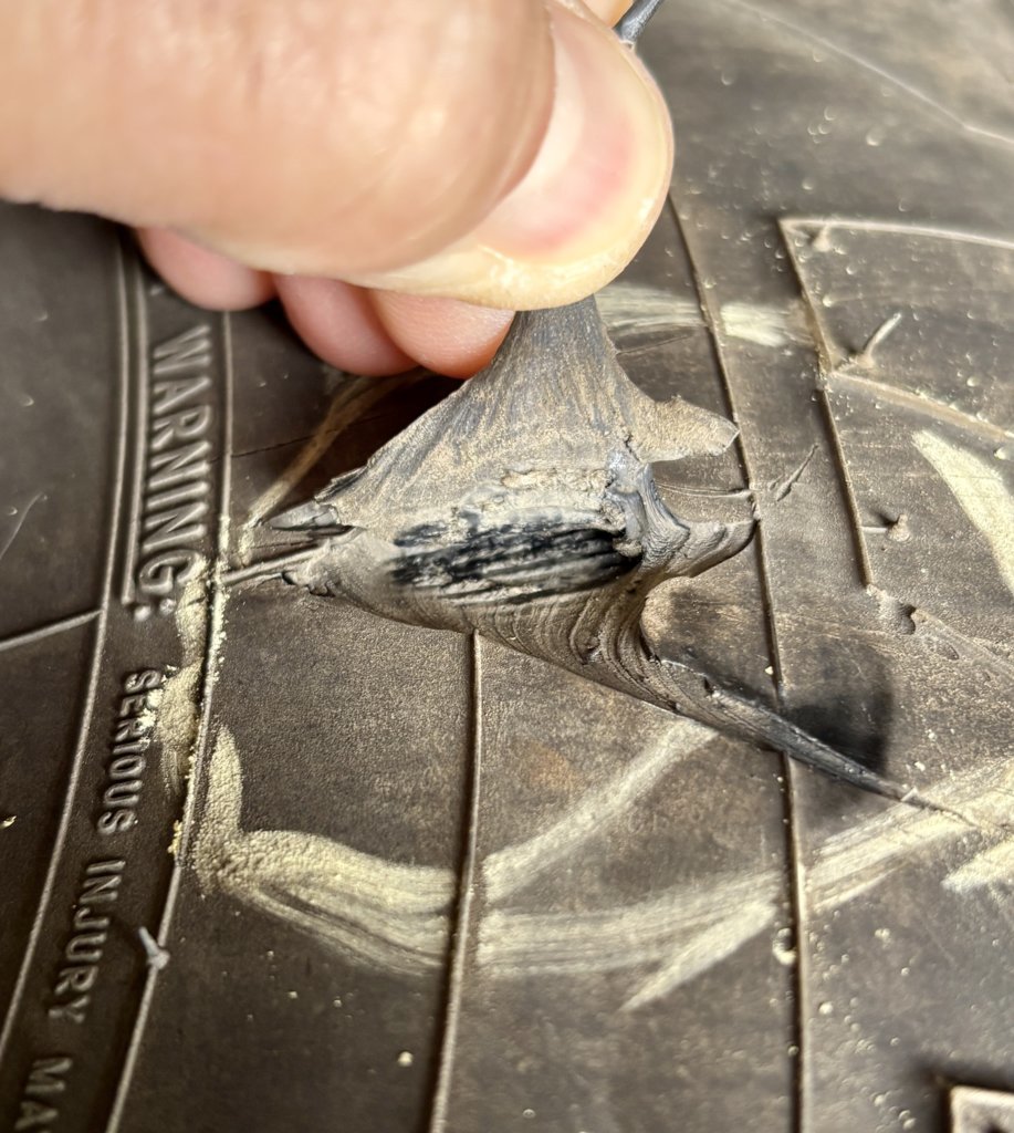

    Discount Tire replaced my damaged passenger side front tire. Had the certificates so new tire was free except $44 to cover it against damage.
    Didn’t really have a choice once I looked at it.
    Scariest thing is that I have no idea how long I drove it like that. Lesson learned to inspect back of tires after offroading. I can’t imagine that happened on the street.

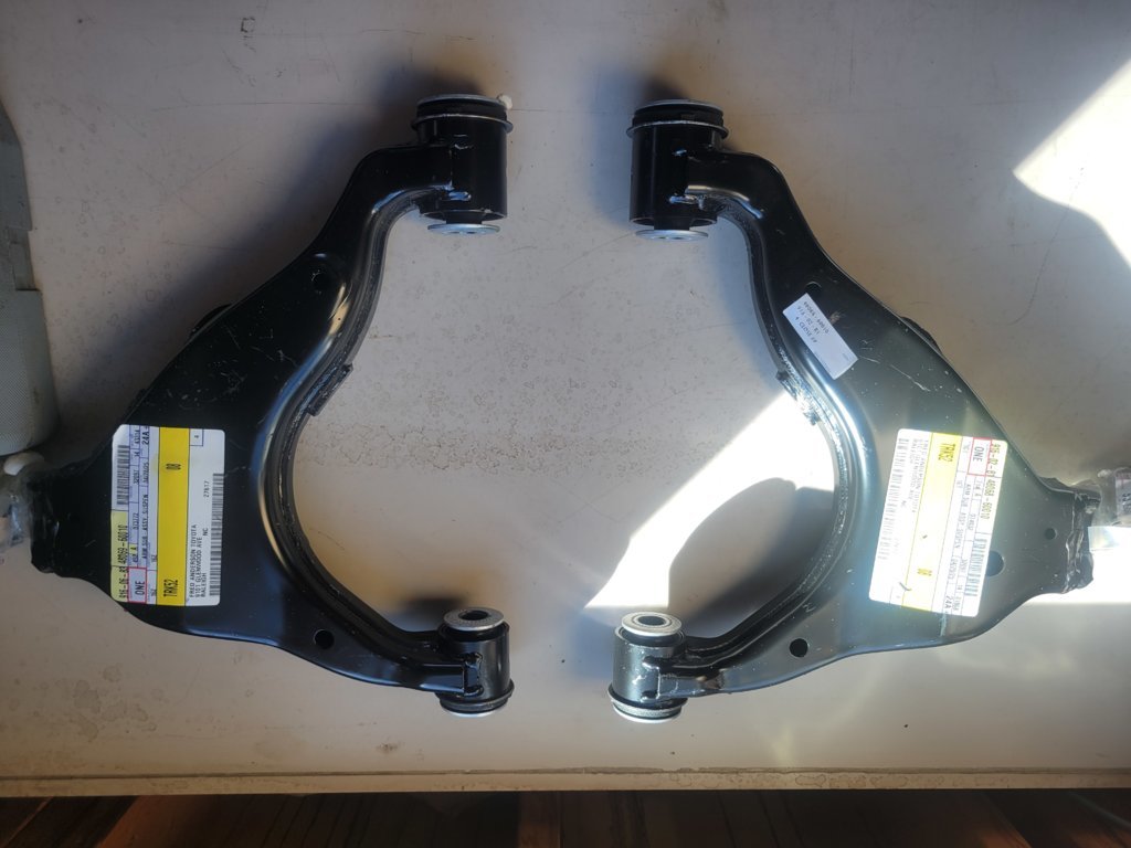

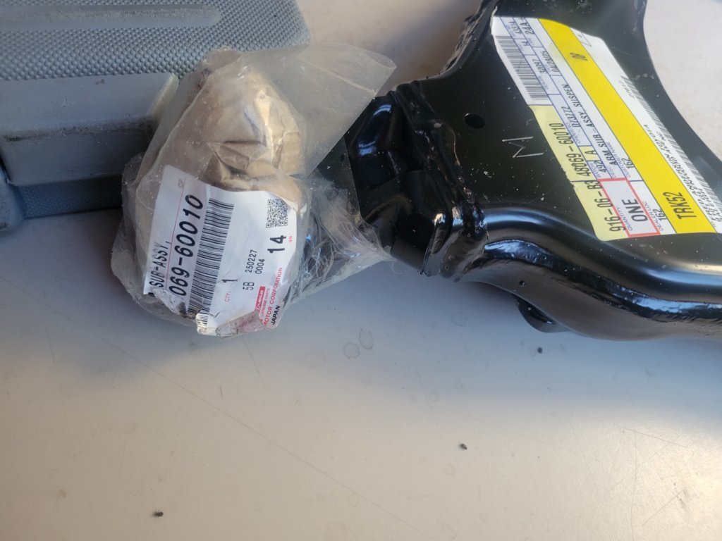

    I just received my new OEM lower control arms WITH lower valley joints, from the Fred Anderson Memorial Day sale...to my door, these cost $623...worth it with the sale

    118
    Good deal. Penetrating oil a for a few days before, say a few prayers and have plenty of motivational beverages nearby in a cooler.

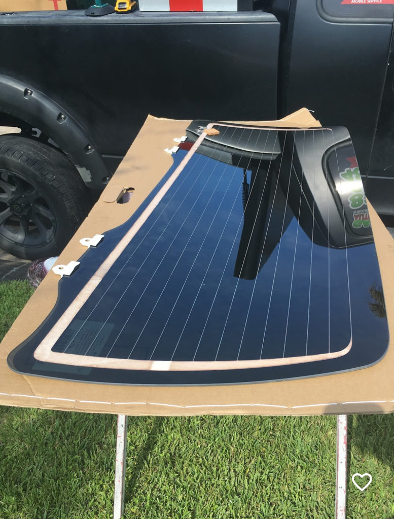

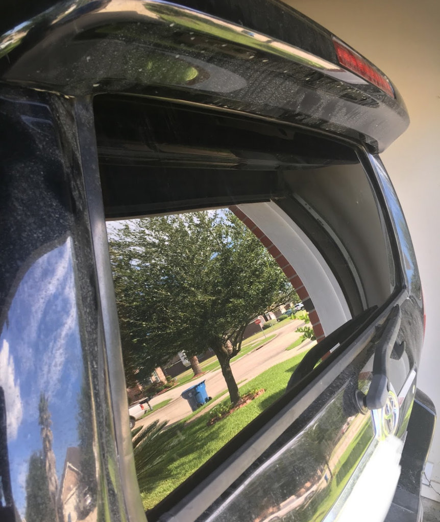

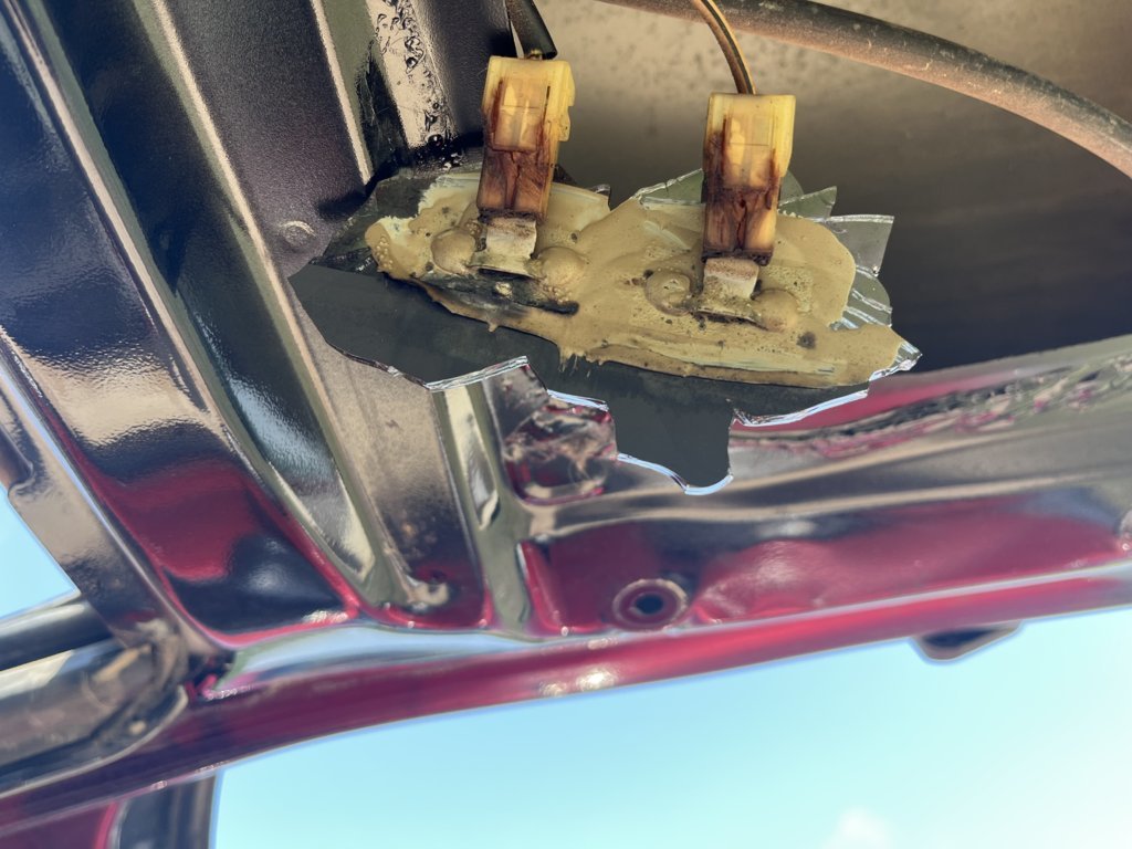

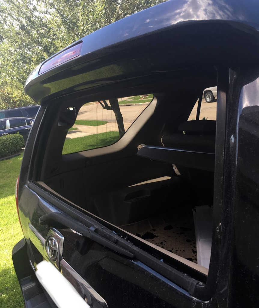

    My rear hatch glass shattered for seemingly no reason tonight. After doing some research, it sounds like it could be related to a bad connection for the defroster. Although I don’t think it was on at the time.. very strange, barely driving along and the thing went off like a gun lol

    Damn, that's terrible. I've read the same... the connections on the defroster wires... can you find glass still?

    I’m going to call the local glass place tomorrow and see what they can do for me.. i sure hope there’s something available!

    Got a rear window ordered. Going to have it installed tomorrow morning. Cost is $517 - ouch. It’s raining today though, so sign me up :anonymous:

    Me too! I am hoping this doesn’t happen again in the future. Now it has me wondering when the next one’s going to spontaneously combust :D

    Well i’d say this is likely the culprit

    Wow! I'm going to throw some tape on mine now! haha, Shiney duct-tape for a maybe save...Thanks for sharing this!
    BassAckwards likes this.

    Some dielectric grease would be good on the connections as well
