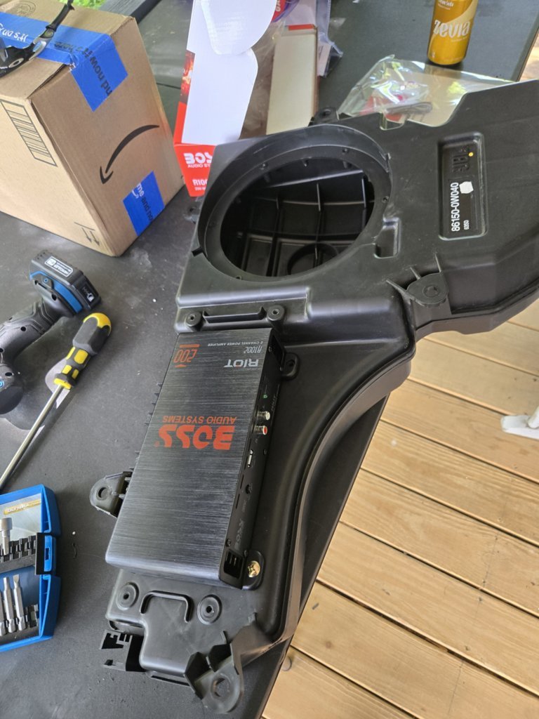

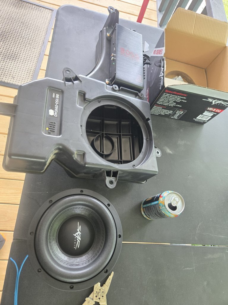

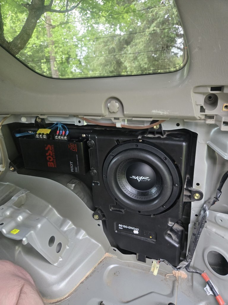

    Today I began the process of retrofitting a JBL sub-box into my 2005 SR5. Here my build link 4Ruiner's Build 2005 v6 SR5 | Toyota 4Runner Forum [4Runners.com]
    I was able to obtain a JBL box with stock amp and subwoofer from a wrecked 2007 for $50

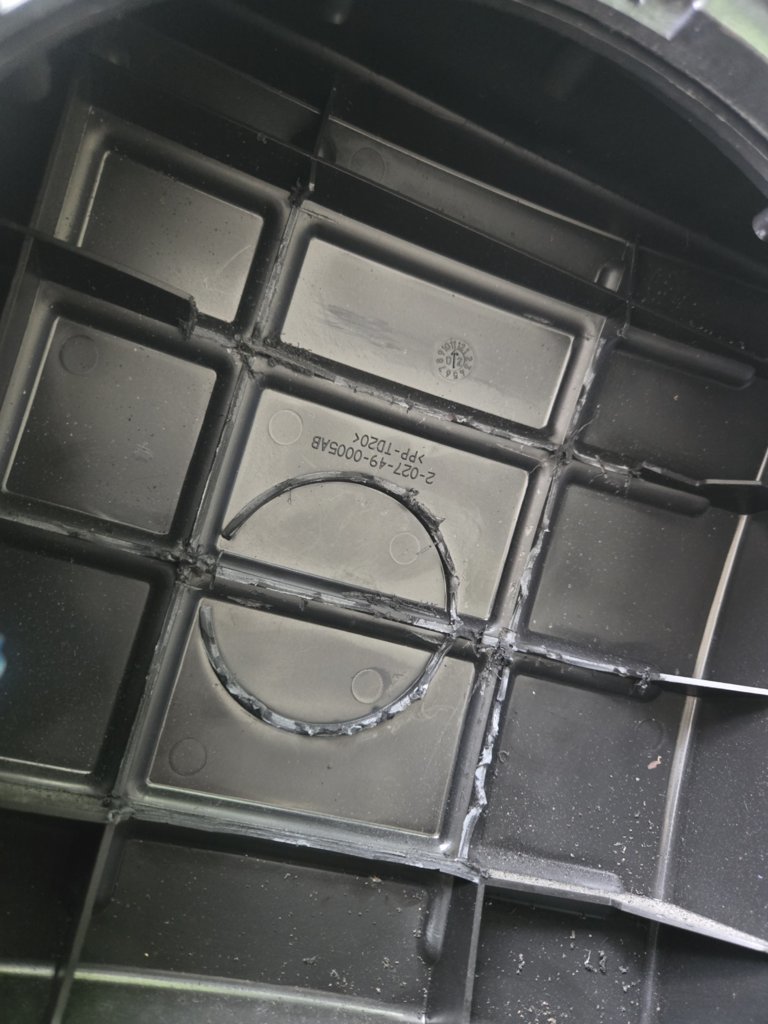

    The goal is to keep this as stock as possible and to retain as much space as possible. The amplifier is a Pioneer Riot 2 channel mini amp. The sub is a Scar 8in dual voice shallow mount subwoofer. In order to get the Scar subwoofer to fit, I had to trim down some of the plastic grid within the JBL box.
    I still have to run the wires to the aftermarket head unit.

    Is the area that the amp is screwed to hallow? Just asking cuz I think that sub can use the breathing room.

    Yeah it is hollow

    I'd be curious to figure out the air space it provides for the sub just to see if it's enough to justify a port. That would be sweet, probably not necessary if you don't push it to it's limits though. Either way, looks clean,well done sir. I had a skar vxf 12" in my interceptor, built a sealed box for it. It worked for a long time till I pushed it too hard for it's lack of breathing room and separated the voice coil. Luckily the guys at skar are awesome and replaced the sub. I had a ported box built for the new one and it sounded way more clean. I didn't have to push it as hard to receive the same volume.

    Interesting, yeah I am just going to see what I can do with it. I have seen others on here replacing the factory sub with shallow mount kickers and pioneers. I figured I would give Scar a try since the sub was literally half the cost of the kicker/pioneer subs. Its more or less just there for a little bump. I am past my days of incredibly loud systems lol.

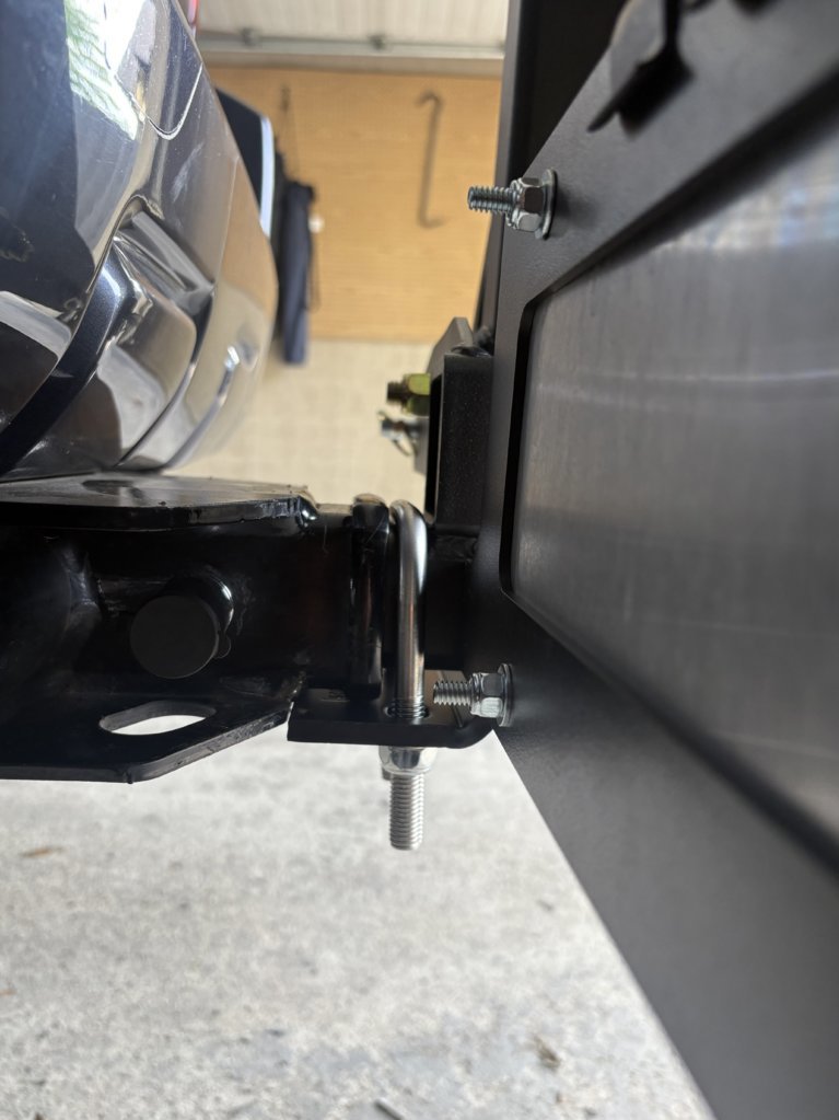

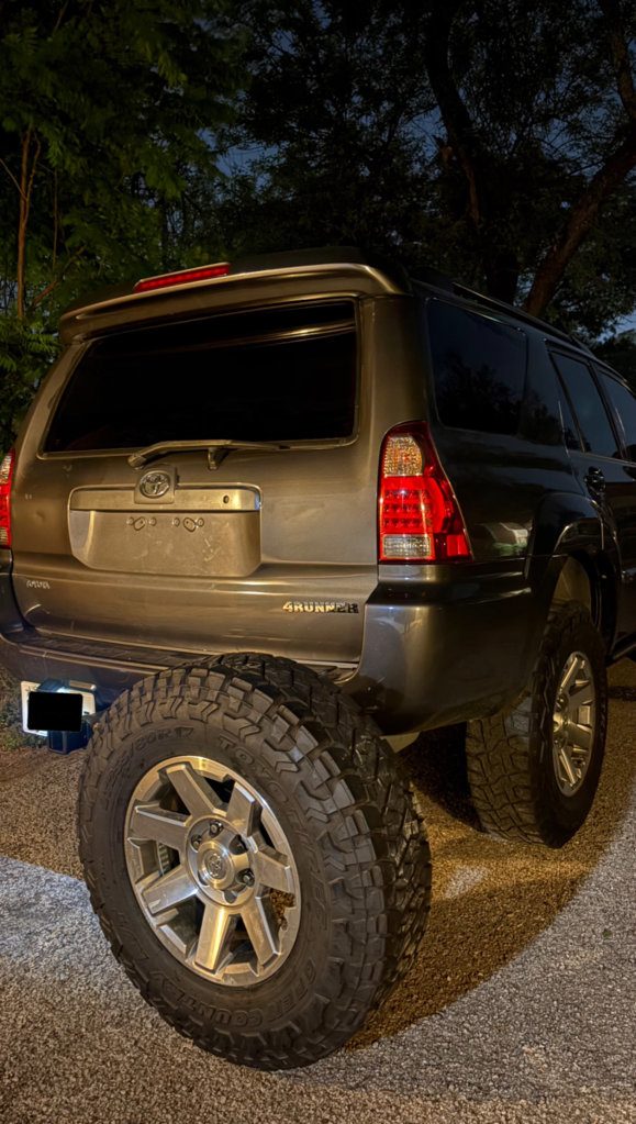

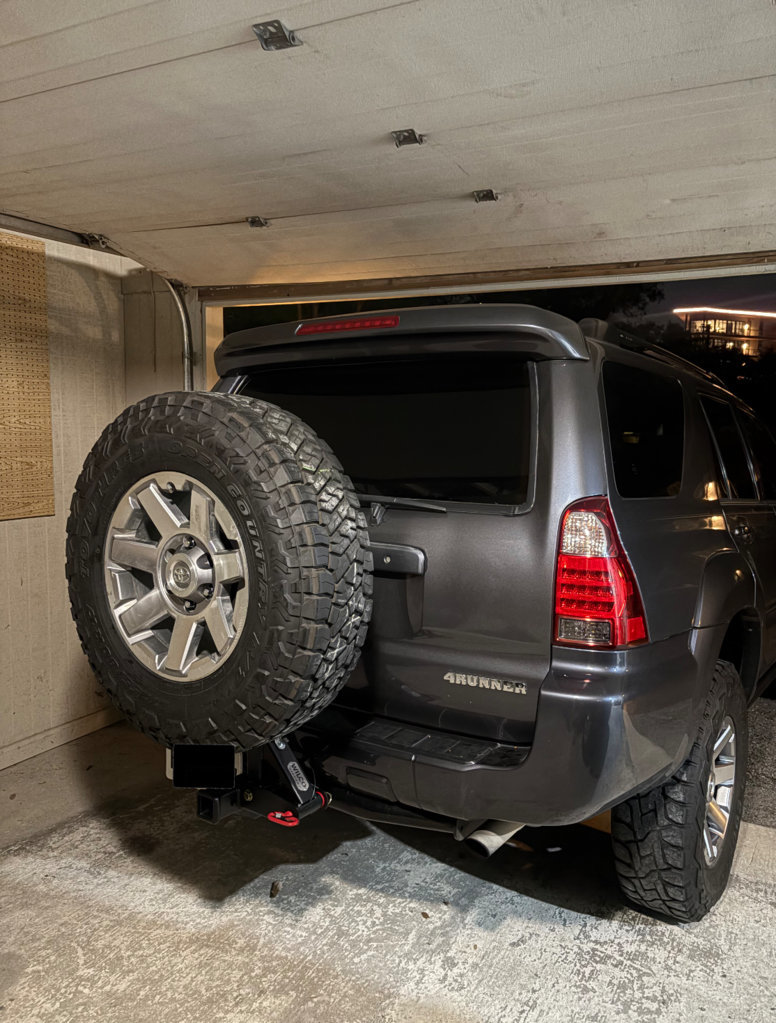

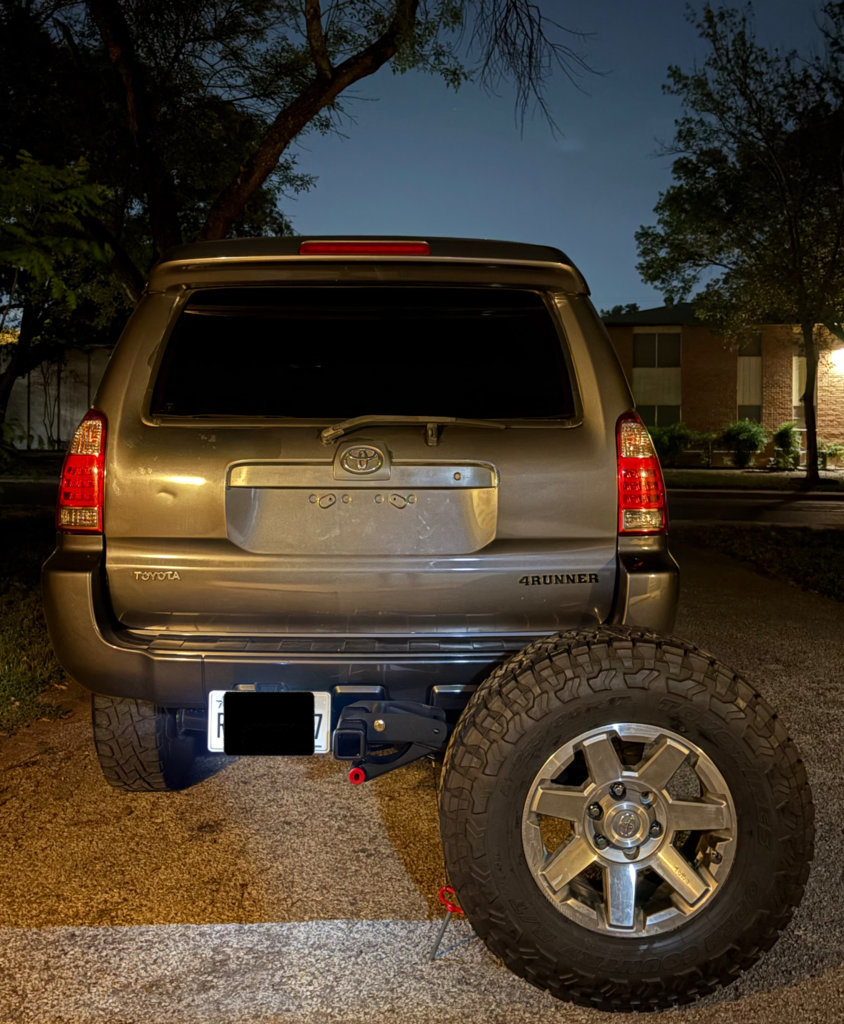

    After a long weekend of traveling, had some time last night installing the Wilco Hitchgate drop.
    My spare tire’s mechanism wire underneath frayed/ seized and I never got around to installing the updated chain version so this will do! :D

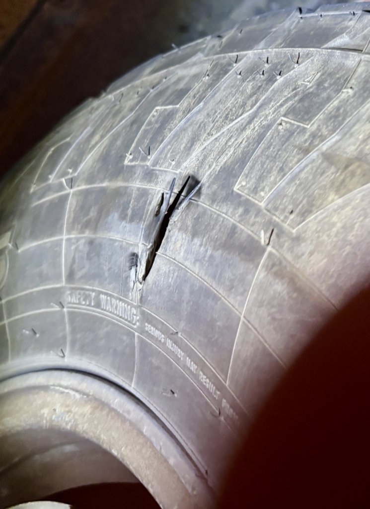

    After considerable effort, I finally broke my transmission fill plug loose so I can finally get my drain and fill done tomorrow. That was the good news. The bad news was what I noticed on the inside side wall of the front passenger tire as I was crawling out from under the truck. :mad:
