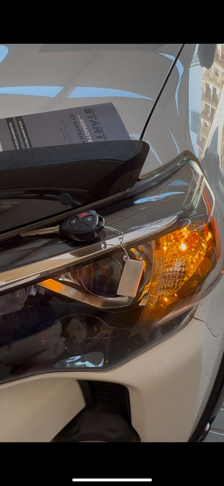

    4runnerfromdxb
    4runnerfromdxb New Member
    Oct 8, 2024
    #43274
    39
    installed startx remote start. Took me 10 minutes to get this all done... what a pleasant and problem-free mod!
    LOSTR4 likes this.
