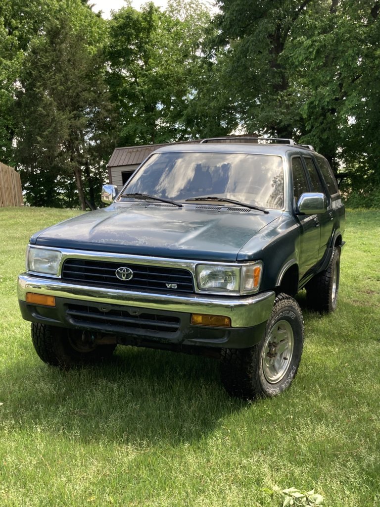

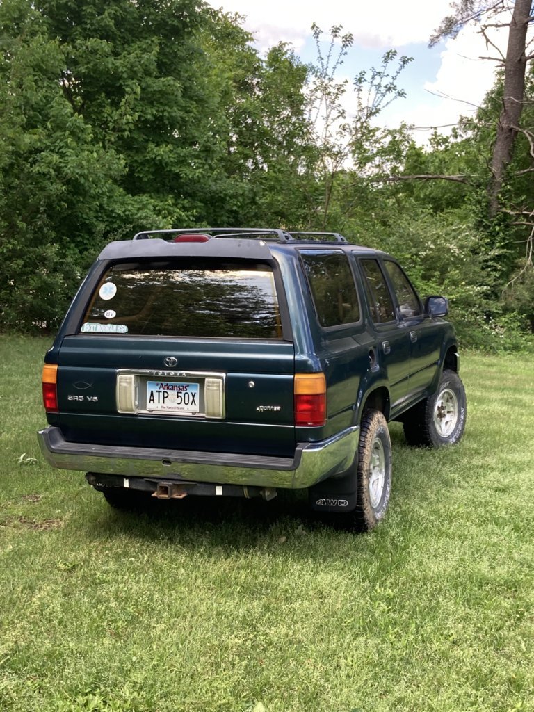

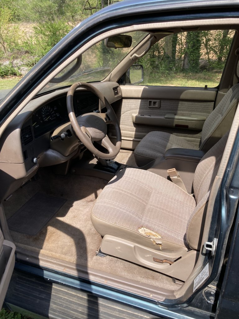

    Hello 4Runner world! I just recently purchased a 1993 4Runner SR5 with 217k on the dash. I am brand new to the community and of 4Runners. I’ve had it for about a couple days and I am just in love with it. I stumbled across this forum trying to look for some aftermarket modifications. (If there is any info on that please respond to this because I’ve heard it’s a dying market now)
    One of the big reasons why I wanted a 4Runner was because of how much you can do with the platform and how much love they get. The first exterior things I want to get done are
    -getting the clear coat re-done on the hood and roof.
    -getting badging
    -hopefully fix up a small bit of rust on the fender
    Interior wise, the guy who I bought it from loved and took care of it very well. She is very clean on the inside.
    What I know is done to it is
    -New exhaust
    -New front rotators and pads
    -New drums in the back
    -Head gasket seals replaced
    -Sub
    She is everything I need and I can’t wait to get started on modifying her. There was a couple things needed replaced soon and that was
    -Ticking Time heater
    -cover for the column
    Another than that I’m excited to have joined the community!

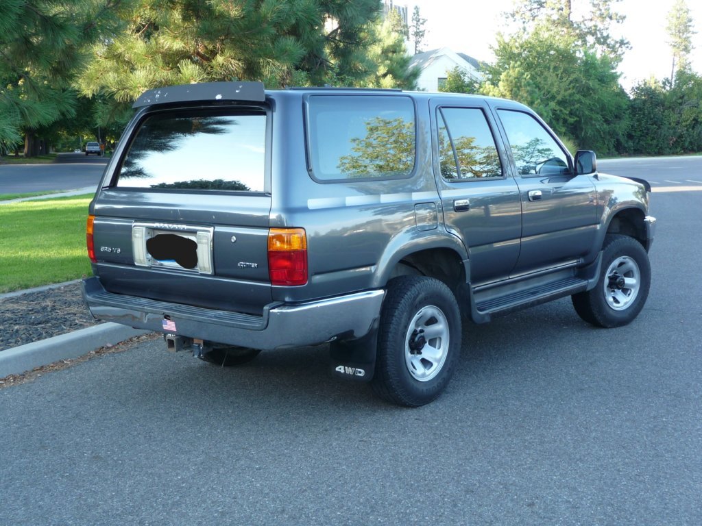

    1991 4runner SR5

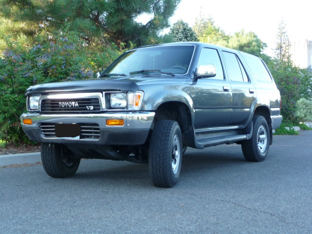

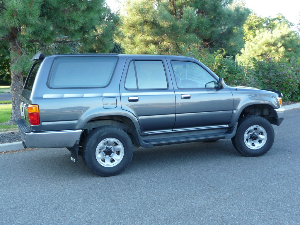

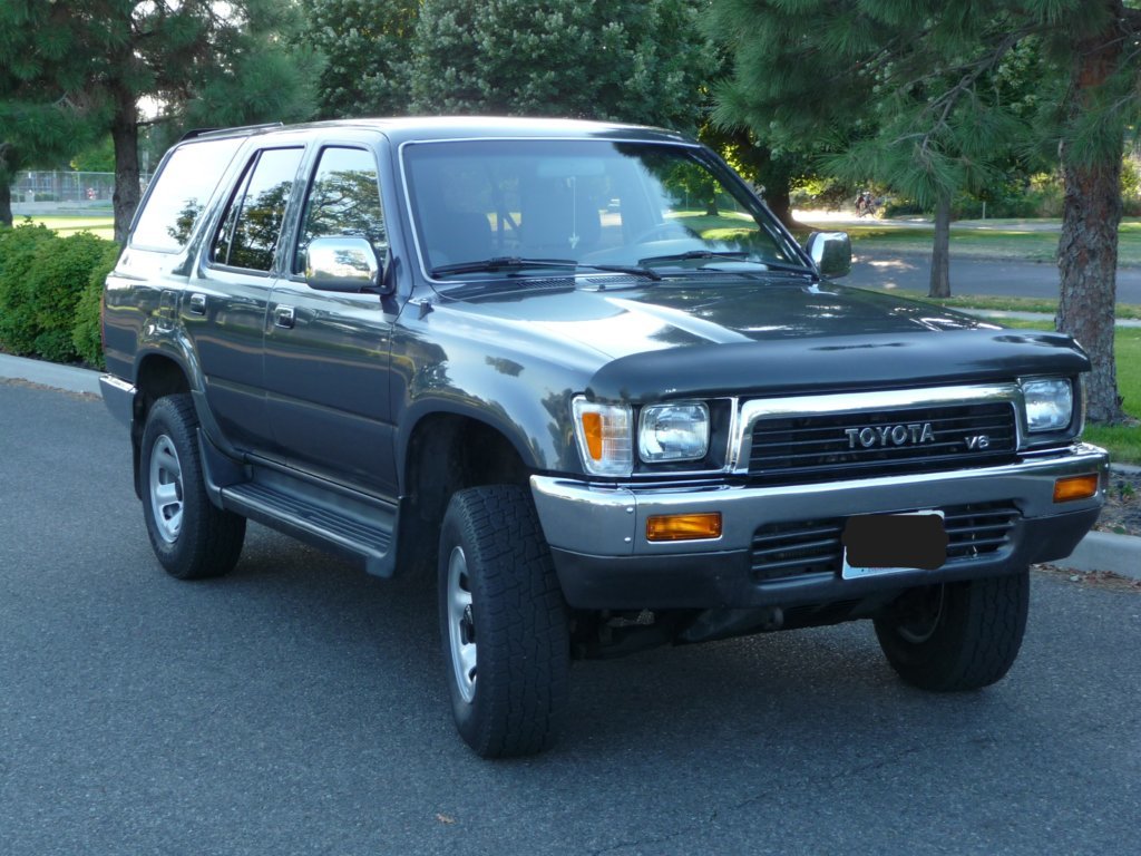

    Bone stock.
    "What have you done to your 2nd Gen 4Runner today?"
    I've owned this 1991 2nd Gen since 2004. Second owner. It had 49,000 original miles on it in 2004 and has 119,000 today. Toyota said the engine was changed at 35,000 due to a head gasket recall. Apparently it was cheaper and easier than just doing the top end. Originally purchased as a gift for my wife but she 'didn't want a stick' despite learning to drive with one. So, it became a garage queen that we only use on road trips. Haven't had to do too much to it in the 21 years I've had it. Recently had the factory wheels refurbished due to a bead leak. Had them powder coated at the same time. Cleaned and painted the front center caps and located a set of original rear center caps on ebay. The 13 year old battery gave up the spirit the same day I installed the fresh wheels so I had to change that. Except for a handful of parts it's all original.
    It runs like a top and has never left us stranded on trips to every state west of the Mississippi. Drove it down to central TX last year to watch our third total eclipse of the Sun visiting 13 states along the way. Just returned from a trip to the OR coast where I drove it on the beach for the first time. It as been an awesome rig. The wifely unit wants to upgrade to something a bit bigger but I'm not feeling it.

    This is amazing! I love to see a beautiful truck see such great use.
