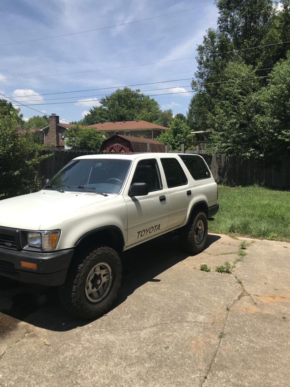

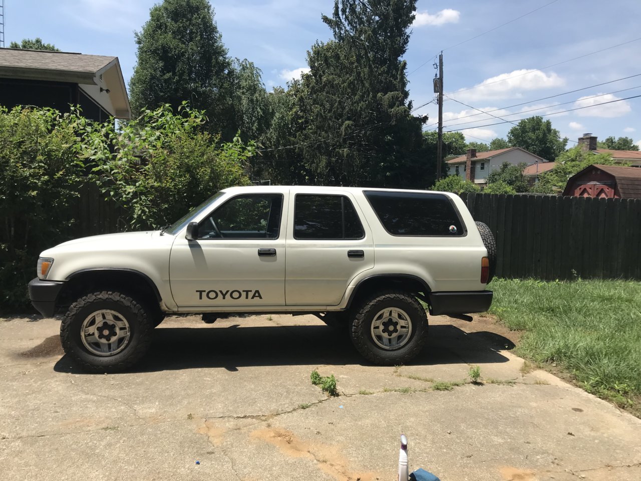

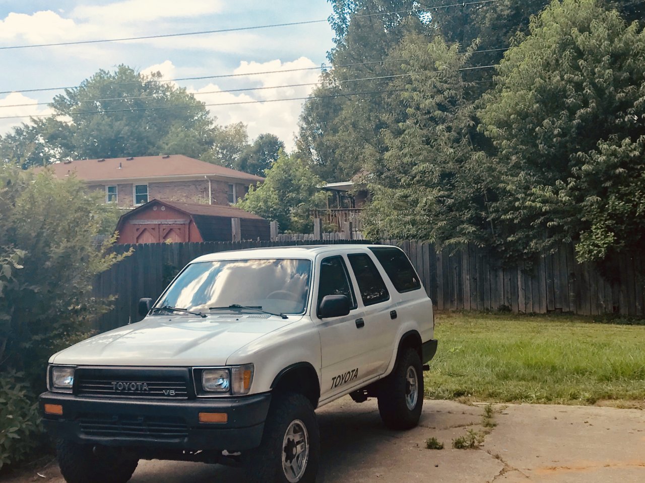

    After 4 months on jackstands, this ol girl is finally back on the road.
    Bought this 4runner in February for a song. Frame was good and rust free, but the steering components were worn, and interior was rough.
    A brief list of what I've done since March:
    New timing belt and water pump (also, learned how to install a helicoil, since the aluminum threads like to strip out when removing the tensioner bolt)
    Valve cover gaskets
    Oil pan gasket
    Upper & lower ball joints
    Pittman arm
    Idler arm
    Inner/outer tie rods
