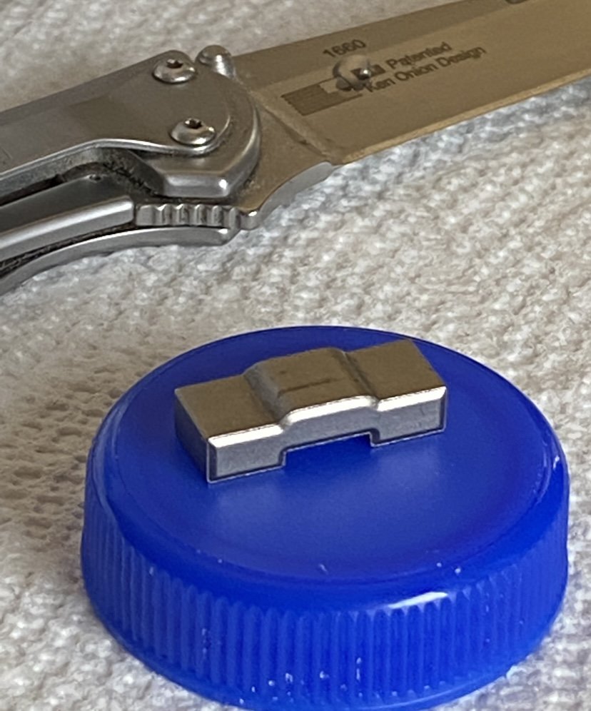

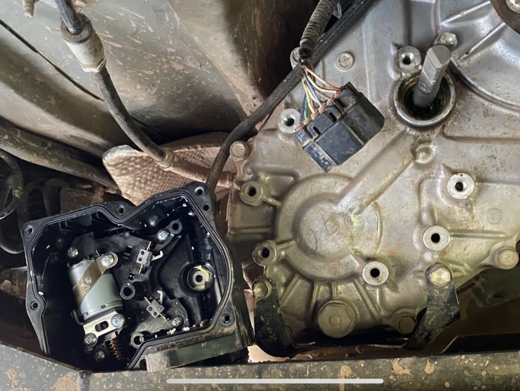

    Regarding the comment that 4wd doesn’t disengage all the away…there is something to that. Here’s a little story…
    I have an OR with the shift lever, and I find it communicates exactly what it likes and doesn’t like when being shifted. It does NOT like to be shifted out of 4wd with any tension on the system whatsoever. The lever lets you feel how bad it is because the shift feels gummy, and has way more resistance to moving. And even if you get the lever physically moved to 2wd, the 4wd light will not always turn off, usually not until the binding finds its way out of the system. Let me tell you it feels horrible to shift with any tension in the system…even if it’s just the tension from the suspension being slightly articulated.
    On SR5s with the electric shift actuator, you don’t get any of the this feedback to your hand. So you might shift it into 2wd whenever you want, thinking/hoping the system will protect itself and sort itself out. However, I’m willing to bet that the electric actuator is a just a simple dumb electric motor that just throws the shift exactly when you tell it to. It will make an effort to shift, and if can’t, maybe there is a pressure mechanism or timer that will turn off the electric motor and you are simply left with the transfer case in whatever position it was able to get into.
    Those bad shifts are not good and are to be avoided!!! My transfer case failed when I felt a gummy shift and the light didn’t go out. That happened going straight, slow, but on a very slightly uneven grass surface. The failure involved the synchro or synchro assembly judging from the part that came out transfer case drain hole, and the brassy sparkles in the oil. IMG_6415.jpg
    On a more recent trail run, I’ve also been witness to a 3rd gen tacoma wrecking the transfer case on a shift that occurred right before turning right from a trail onto a highway. It lost all drive and was dead in the water on the highway. So we towed it trailside again to do some head scratching and phone-a-friending. We determined that the actuator did not complete the shift stroke, and the shift rod that goes into the TC was physically locked somewhere between 4lo and 4hi. Presumably the actuator could not overpower the binding forces on the shift rod (in the same way I can feel it hard to shift my lever when bound). The shift rod had to be literally hammered into the 4hi position so the owner could at least continue driving it with the actuator removed. The fact it didn’t move freely was later determined to mean something broke inside. Actuator itself was taken apart during trouble shooting…it’s not much to look at besides a cheap motor, plastic gears, clock springs, and contact switches.
    Both of these transfer cases were replaced by salvage transfer cases, so unfortunately I can’t give a full post mortem on how they failed, but fail they did!
    There is one clear lesson here…avoid shifting the transfer case whenever it might be binding in any fashion. Shift only on flat and level conditions only. So if you ever find yourself turning on dry road surfaces in 4wd…don’t panic shift into 2wd just to try and save it! It’s too late at that point…, just drive straight to get the tension off the driveline, and only then, shift into 2wd. At least that’s the advice I’m following.
