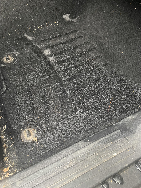

    Back with some awesome graphics. Here is what I see under my floor mat when I remove it. Sometimes the floor mat has a pool of water as well, but this time it only had a few drops of water.

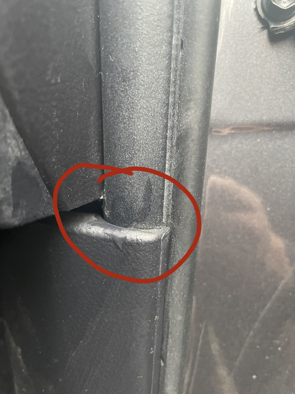

    Here is one place the water appears to be coming from, inside the door frame underneath the A pillar:

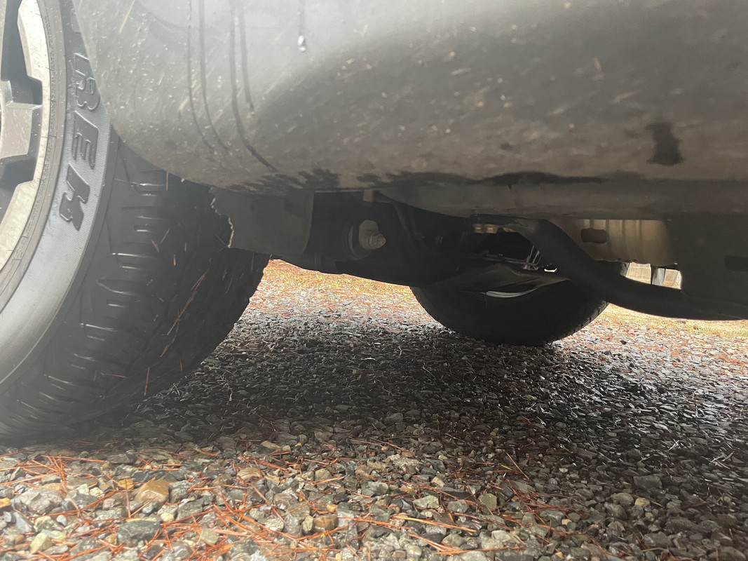

    I've never experienced this on the driver side before, but today after I started moving i heard a gurgling sound on the driver side. When I got out the water was pouring out of this location. I only got pictures of it dripping. It looks like this rocker panel is catching the water dripping off the frame above it.
    A better shot of the location, but you can't see the actually pooling/dripping. These two shots (above, below) are driver side where I heard the gurgling sound; again, have never seen water inside on the floor mat on the driver side; have never heard the gurgling sound on the pax side. Both seem to be the same issue.

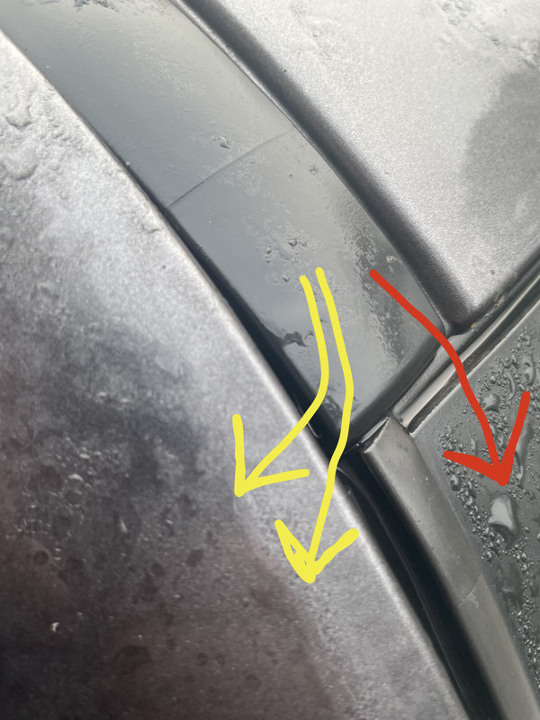

    If I'm a guessing man, I think the water is coming in these gaps. It looks like the water should be sheeting down, but for some reason when we get heavy rain and I'm not moving, it moves down frame instead of along the windshield. (Awesome arrows included for graphic effect.)
    Driver side
    Passenger side
