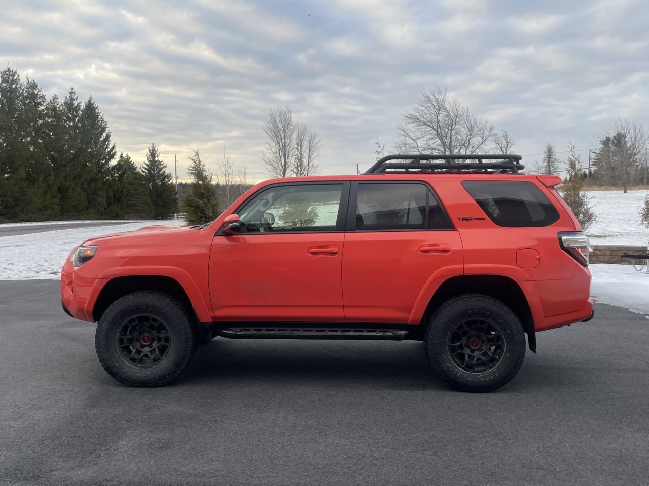

    Here’s a pic of my Wescott Designs lifted Pro on Toyo 285s - ATIII’s. 5/4/23, updated pic after BMC, SPC Control arms and SCS wheels installed. Safari Snorkel and Wescott hatch ladder on order.

    Looks great, I love the color. Enjoy!

    Looks great! I have the Wescott lift on my '21 TRD Pro. I really like the look of those tires. Certainly more "chunky" than the stock Nitto tire. Nice!

    Looks awesome. Any rubbing? Is the UCA change and BMC definitely needed?

    The UCAs and BMC are not needed. The camber and toe aligned well within factory spec. The caster came in under spec at 1.2 degrees. Per the report it should be 2.8 deg min. Cross camber, caster and toe are all well within factory specs. The vehicle drives as before the lift with no noticeable changes (straight and true) and there is no tire rub. Front mud flaps remained on. I’m replacing the UCAs to get the caster into factory spec, my choice, and I’m OCD about everything being correct. Doing the BMC just in case I decide to go bigger in the future.

    Looks great! I have the same Solar Octane and wanting to do similar mods. Did you keep the stock TRD Pro wheels on a 285 tire?

    Thanks. Yes, in the pic, they are the stock Pro Wheels with the 285’s installed. I’ll be swapping them with SCS Ray10’s in Matt Black soon. I like the stock rims but want a wider stance but don’t want to use wheel spacers.

    Correct, I haven’t done any hard off-roading yet, but I have not experienced any rubbing at full articulation, L or R, Fwd or Reverse, flat or on an incline. From what I have read, if left on, some people do experience rubbing on the mud flaps, but so far I have not had this problem. As Slopemaster stated, it will depend on the installer/alignment. Also, I did not have to trim anything from the fenders, and the BMC is just something I want to get done, not required, thanks
