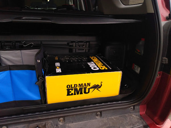

    I know the ostrich-brand leaf packs sag into a "W" shape in Tacomas within a year. Sad to hear their coil springs are equally bad, as I bought a set of 2895Es...
