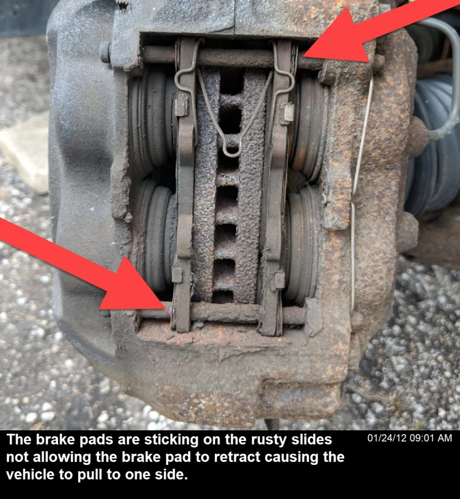

    There pins that allow the pads to move within the caliper. If these are warn out or corroded it can cause issues as well.
    As someone else mentioned it might be worth bleeding your brakes as well to rule that out. It's an easy enough thing to do.
    First ensure all the pads are in fact engaging against the rotor when you apply the brakes.
    If they all contact and seem to function properly then check your rotors and be sure that's not the problem.

    After re reading your post it sounds like maybe one of your brake pads isn't engaging the against the rotor.
    This is what I would do.
    Jack up the car, pull the wheels off and have someone sit in the car. Walk around the vehicle and have them hit the brakes while you spin each rotor individually. This will allow you to see if the pads (both sides) are engaging against the rotor.
    Bleed the brakes and do this test again.
    If the pads (both sides) don't engage against the rotor pull the pins and clean them up with a wire wheel or sand paper. Now you can do the same test to see if the pads contact the rotor when you apply the brakes.
