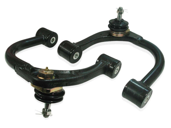

    UCAs are SPC P/N 25480 "version 1". Looks like they were severely neglected or installed with no grease in the polyurethane bushings to begin with.
    SPC changed the design to a stronger one-piece forged arm around 2018, but introduced swivel joints in lieu of the polyurethane bushings. The swivel joints would've never made it 30k.

    So, I should stick with SPC. Is the new version a direct swap into my setup?
    Never make it to 30K sounds a bit of a pain to deal with!

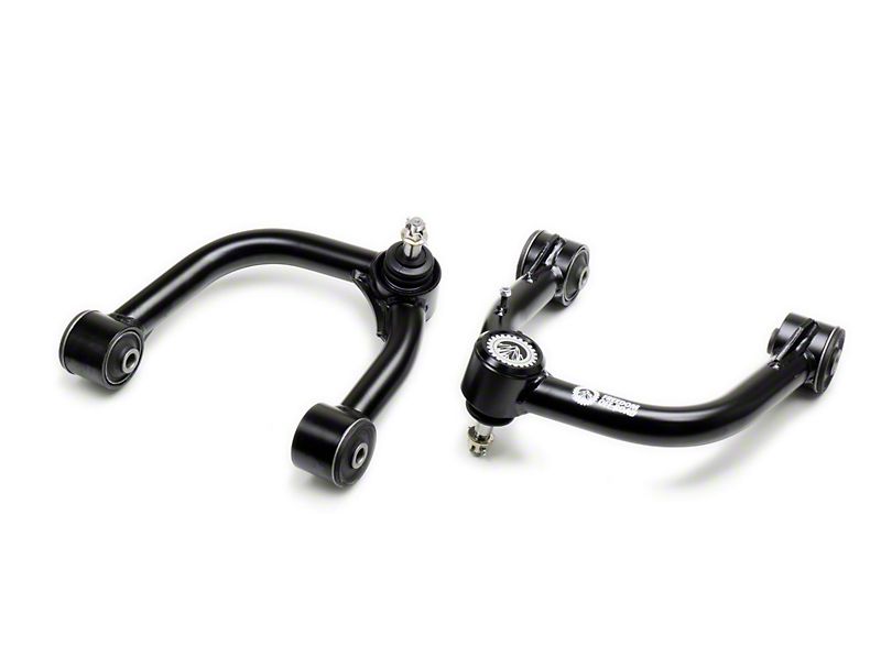

    Given the age of your 4Runner, your lower control arm cam bolts are probably seized, which means you'll need adjustable UCAs to maintain alignment. However, I would avoid SPC because their "Xaxis" inner swivel joints are known to wear out very quickly (like under two years). I suggest spending the extra $80 and going with this: https://www.extremeterrain.com/free...-front-uca-2-to-4-inch-lift-fo-t702fu-bt.html

    Looks like I may go with the JBA standard.

    The Freedom KDSS kit is $665 but out of stock. Also, the JBA has greasable bushings, which pushes me in that direction.

    I need a tetanus shot just looking at this! OP do not buy SPC, everything is a pain in the ass with them. Buy JBA UCAs :thumbsup:
