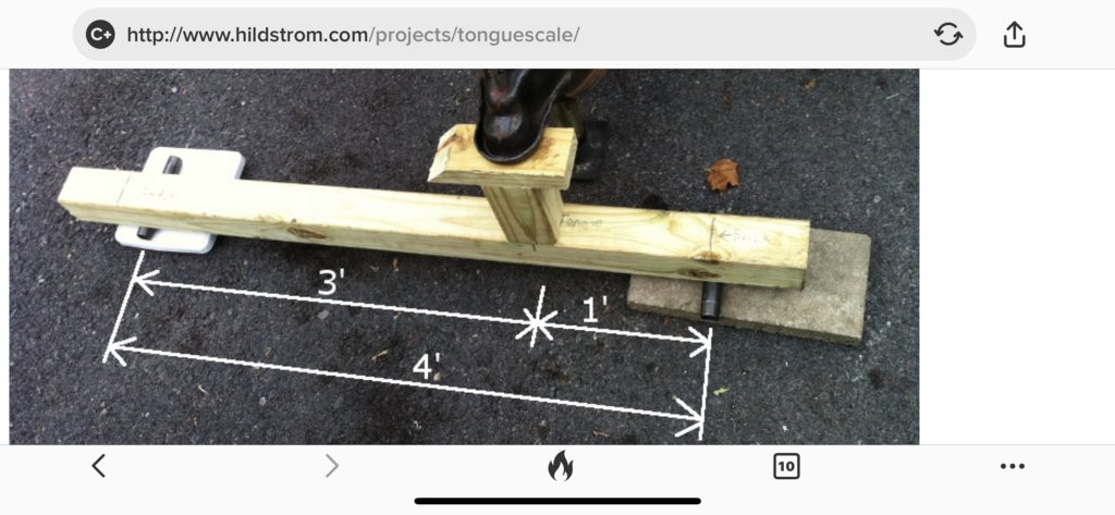

    There are easy ways to measure your trailer tongue weight with a bathroom scale and some boards. Look on the internet for specifics regarding simple home make device easy to store and carry.IMG_3923.png
