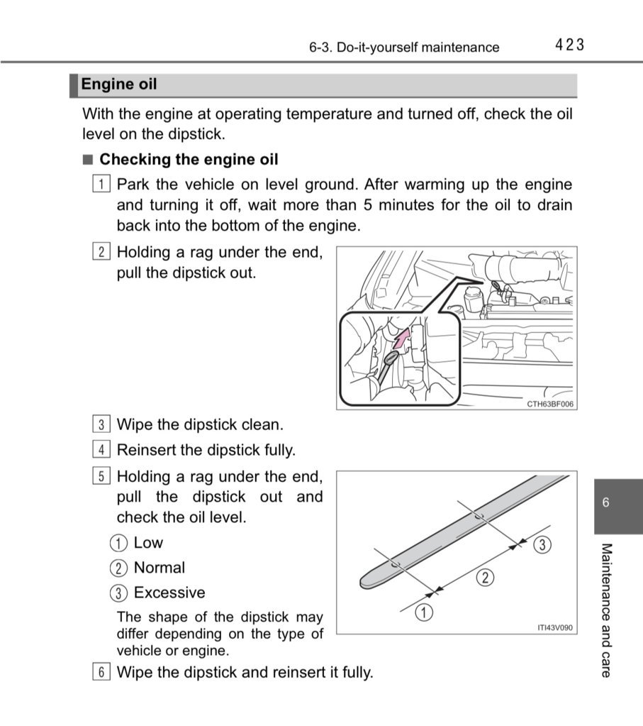

  3. Jun 12, 2025 at 4:53 PM
    2,439
    That’s where it’s supposed to be. From the manual:
    Note that if the oil is filled to the top dimple that is considered “excessive”. I’m just the messenger …

  5. Jun 12, 2025 at 5:58 PM
    4,888
    The way I read it is that 'normal' is anywhere from the bottom dimple to the top dimple. Therefore it's still considered 'normal' at the top dimple.
  6. Jun 12, 2025 at 7:09 PM
    2,439
    I think you’re right. But OP’s half inch over is firmly in the excessive range.
