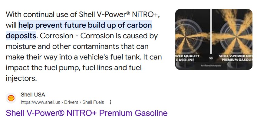

    Just pumped Shell 91OCT (I think its called VNitro). Normally pump 87 but once in a while pump 91 at Shell thinking it would clean things bit more than regular 87 at Shell. I mean I think Shell premium might have bit more detergent like chemicals. It's not too expensive here in CO. I could be wrong, just sharing what I do.

    I could have highlighted the vNitro thing. Could be some marketing BS. But using it once in a while even though we have port injection in addition to direct. Else 90% of the time its 87oct at top-ties gas station or 91 in top-tier gas stations that doesn't have 87oct (places like Costco only has 85 and 91 here in CO).

    The Shell info says "...with continual use..." but one way or the other, surely this isn't the only fuel that can make such a claim. And to be clear, I don't mean to sound snarky about this.
