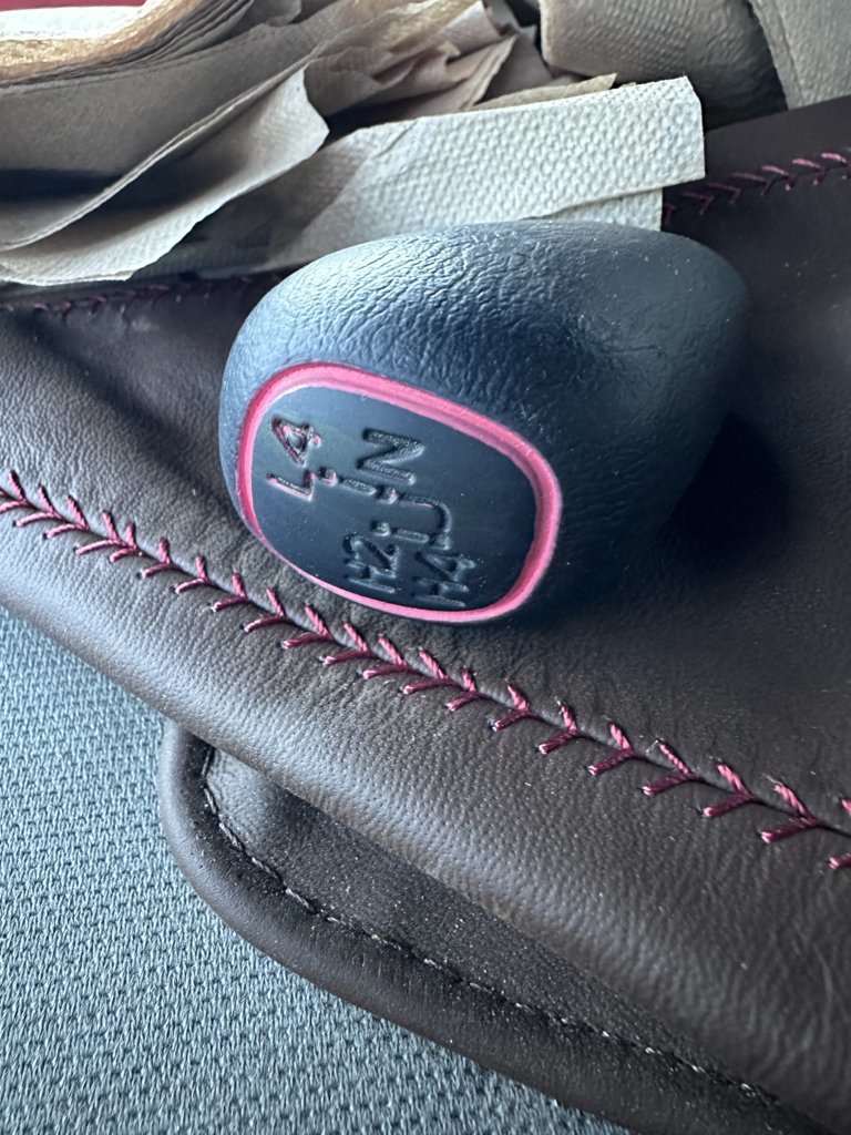

    How to make the imprinted knob more visible ?

    Rub a white crayon into the grooves?

    I’d clean it and try a fine point white paint pen or something like that.
    But personally I’d stop after cleaning.

    Paint crayon: McMaster number 2018T3, white.
    Link

    I haven't used it on my T4R, but have used it on industrial control boxes several times.
    It's like a crayon -- rub it all over the plate, filling in the recesses, then wait a few minutes and wipe off the "upper" (non-recessed) surface. If you wait too long, a bit of isopropyl alcohol will be your friend. Easy!

    Id clean the shit out of it, and leave it as is. Just me.

    I appreciate all the input - I did try something though ! Some of it worked and some didn’t !
