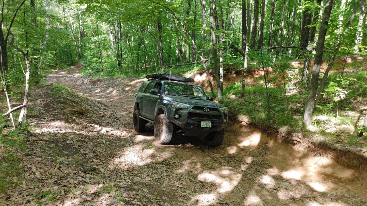

  16. Jun 6, 2020 at 7:10 PM
    #106
    14,597
    I got to test out the new toys aon some trails in northern Wisconsin this weekend. So far, it's fantastic!
    This picture is actually from the driveway to my campsite. It's pretty washed out. I had to use 4wd to get out this morning:D
