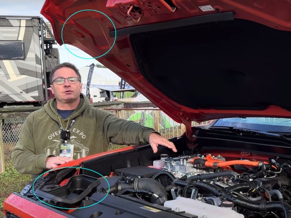

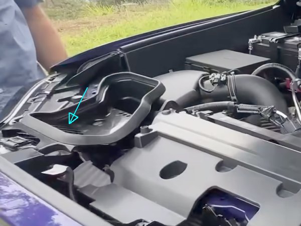

    Turbo's fine. The intake on mainstream trim levels will be over the radiator support. The intake air enters through the front grille, over the radiator support via this little scoop, then into the air filter housing behind it. The hood forms the upper lid of the scoop. You should be fine as long as you don't submerge the vehicle past the hood. Since air is no longer drawn from the fender well, the fender liners can be removed for larger tires without worry. Tacoma pictures shown:
    [​IMG] [​IMG]
    Worry about the other stuff like the electric radiator fan (which typically shatter when hitting deep water), the ADD actuator in the traditional location, rear diff breather in the traditional location, electric parking brake actuators, the ECM that now sits in the engine bay...
