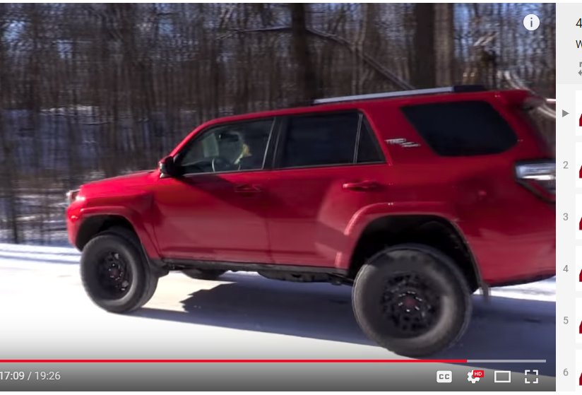

  6. Jun 1, 2018 at 3:44 PM
    PCRIDE4RUNNER
    PCRIDE4RUNNER New Member
    Mar 25, 2018
    #5722
    443
    SUPER DUPER
    2018 TRD OR
    I watched Wanderlost Overland install video and it is straight forward. Thank you @Wanderlost!
    For me I think the 3" lift is a bit too high for being my daily driver, since these are adjustable, has anyone adjusted them down to 2" ? Its just a bit tall and it seems with a 3" I'd need much larger tires so it doesn't look like small tires on a big lift.
