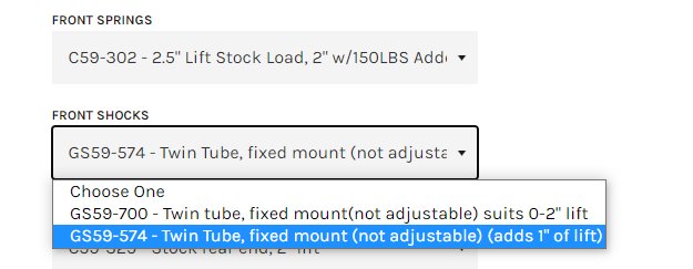

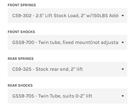

    Hello all -
    Thanks for the info on this thread - very helpful. New to the 4runner world, just installed a Dobinson lift kit, and now have questions on the lift height. I requested a 2.5" F and 1.5" R w/ UAC from Dobinson but after measuring the wheel center to fender - these are my values..
    Stock Grandtrek AT20 265/70/17 with Dobinson Lift
    F Pass 23.5"
    F Driver 23.5"
    R Driver 24.75"
    R Pass 24.5"
    Based on this thread, I am going to assume my 4R stock height is ~20" F and 22" R. I understand the stock height may vary from 4R to 4R however, I can't imagine this range to be greater than 1".
    Any other 4R owners with same lift height seeing this center wheel to fender height after installation?
    I've been seeing threads where lifts above 3" may impact ride quality, control, and suspension over time? Is this true and if I have a 3.5" lift in the front, should I be concerned?
    Does the coilover "settle" after installation? Is that why I'm seeing a more than expected?
    Thanks

    Your Dobs coils should settle over time.
    How's your alignment? Are you running larger tires? Do you rub?

    Alignment is alright, feeling a bit of sway on the rear. Not sure if that needs to ve adjusted further. Running destination at2 285s and no rub at all
  16. Jul 27, 2022 at 8:29 PM
    4,937
    I would re-measure after putting some miles on it and see if it settles.
