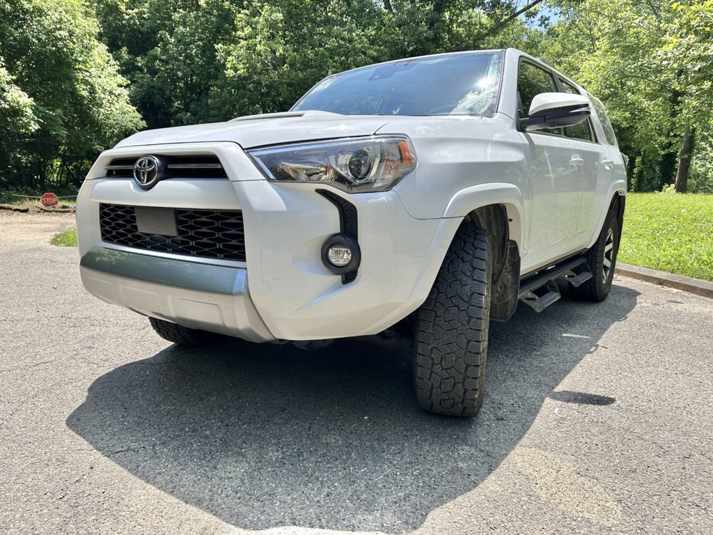

    Correct. Toyo Open Country RT in 255/80 17, 33.1".
    I drove home with them 50 miles from my buddies shop in the rain; that profile pic was in my driveway when I got home and you can see it was wet. I think other than that day though, I haven't had them in the rain. I just got them 3-ish weeks ago and haven't been driving it much since I have a take home cruiser now. Anyway, they handled fine at 40 psi. Cornering grip was strong. Braking performance felt fine. It really felt no different than on my previous 265/70 17s.
    Tinkerer's Adventures has a video where he compares sizes using a fairly scientific test of tread contact areas and the actual contact patch on the tall skinnies is as big as the wider tires, which contributes to the similar handling characteristics. I don't have the link as I straight up binged all his videos recently and I'm not sure which one it was, LOL.
    EDIT - there is one category that feels different actually: steering feels lighter now, which seems counter intuitive since these are heavier, and technically the contact patch should be the same as a wider tire, but the truck has noticeably quicker steering especially at parking lot speeds or at a stop. I consider that a bonus, personally.

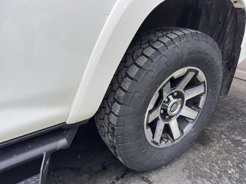

    I had P285/70 (SL) Toyo AT3s installed last month. They look great, but I’m not loving them as a daily driver tire. Very flighty on the highway compared the the LT265/70 (C load) BFG KO2s.
    I believe much of the issue is the 7” TRD wheels being too narrow. You can see the heavy crown where the center tread transitions to the shoulder blocks. Combined with less than ideal caster from the Eibach lift makes for busy steering on the freeway. Not terrible around town, but I am seeing about a 2 MPG hit on averaged fuel economy… anything over 70 on the freeway, and it’s about par with my Tundra.
    I’ll be replacing these with 265/70s or 255/75s. If anyone around upstate SC is looking for a good deal on some lightly used 285 Toyos, let me know.

    So you went up a couple of sizes, with a questionable alignment….
    That “busy” steering is not from just the tires.
    Rim width is probably contributing some.

    Correct. That is the conclusion I came up with.
    I tried it out based on numerous accolades that’s it’s a great combination. Not my thing.

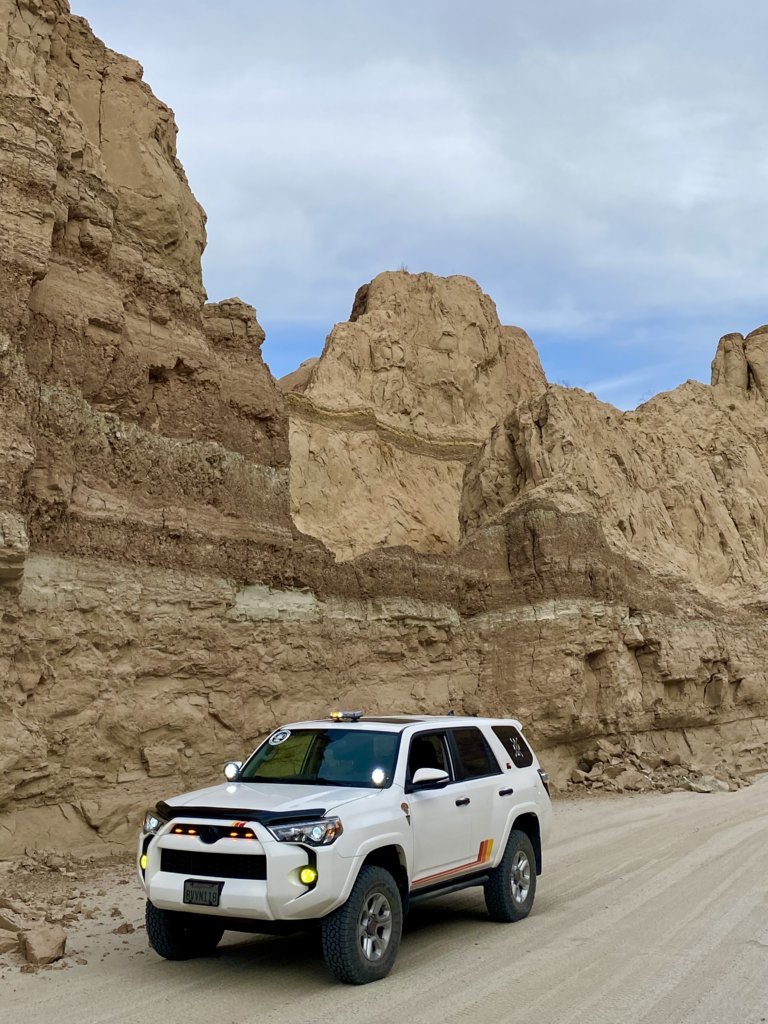

    I’m running that size. 255/80/17 Toyo open country at3 with eibach 2in lift
    They only come in E load
    i’m very happy with them on road and off-road especially off-road since I air down to 15 to 18 pounds mainly desert Trails Rocky prickly lots of solo trips. I’m glad for the thicker side walls heavier tread also on road it is a bit stiffer than stock size but I have no complaints and I don’t think they look bad at all. I did have to trim the front fender area about 1 inch and push the fender liner in all simple mods,IMG_3604.jpg

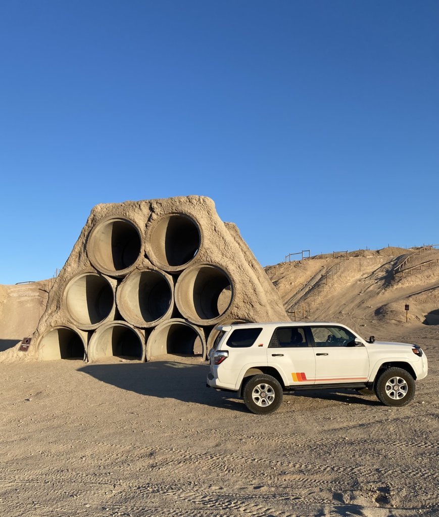

    it is funny to get out and look at the tire marks in the sand. They are really pizza cutters like old school jeeps so far so good.

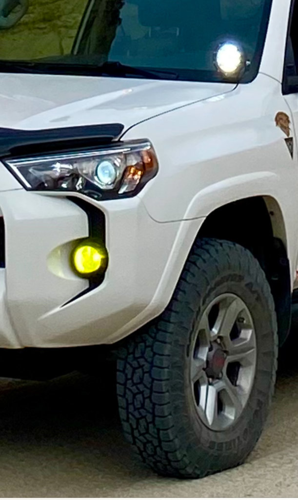

    So far I'm very happy with Toyo Open Country AT3 P285/70R17 SL. They almost feel like running stock size tires. But the con is they are not strong as some thing like BFG KO2 I used in the past. When I drive on a a trail with sharp rocks I pray that I don't get a puncture.
    As for my next set I would also conside tires like: nokian outpost nat, cooper discoverer at34s. Even mickey thompson baja boss (slightly heavy).
