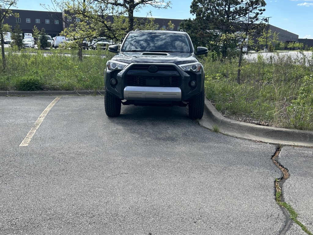

    Shanky New Member

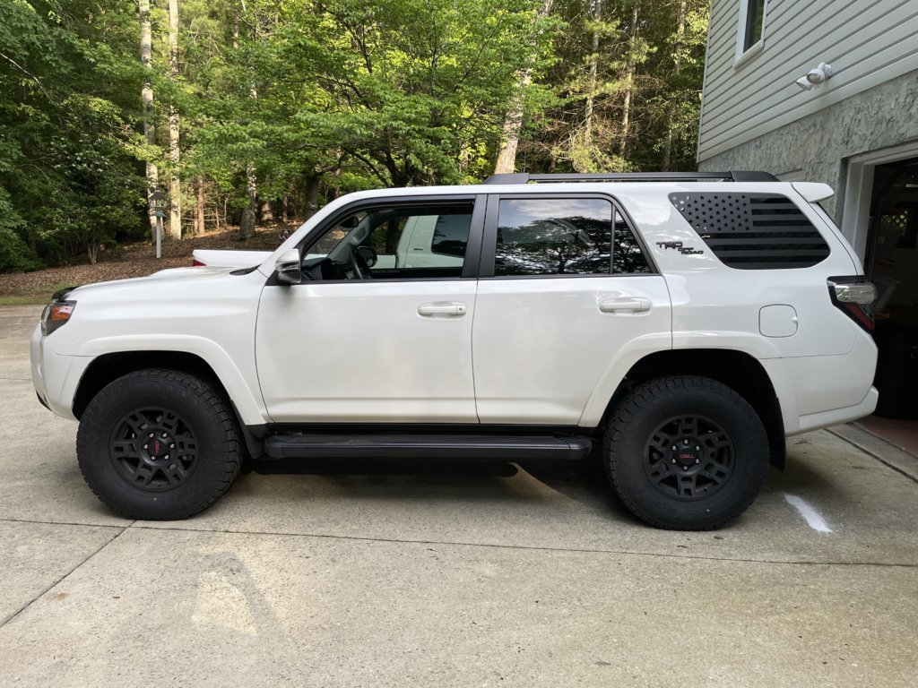

  3. May 13, 2025 at 7:28 AM
    BobbyB
    Nov 18, 2020
    #17959
    340
    Bob
    Marietta, GA
    2021 White TRD Off Road
    Depends on what you prioritize.
    My rig has 265 K02’s for a couple of reasons already mentioned but are as follows:
    - fit without any issues
    - maintains effective gearing and acceleration
    - avoids gear hunting on the interstate
    - does not decrease braking performance
    - cost less to purchase
    Only downside is I give up about 1/2” to 3/4” of additional clearance depending on the brand of tire and the “look” many desire.
    At the end of the day, it’s your rig so do what you want, just as I have….
    Cheers,
    Bob
    J.A., 2ndGen22re, TTerraMB and 11 others like this.
  4. May 13, 2025 at 10:47 AM
    14,522
    Good picture!
    Really shows how a stock size tire with a more aggressive sidewall can improve the look over the OEM granny tires.

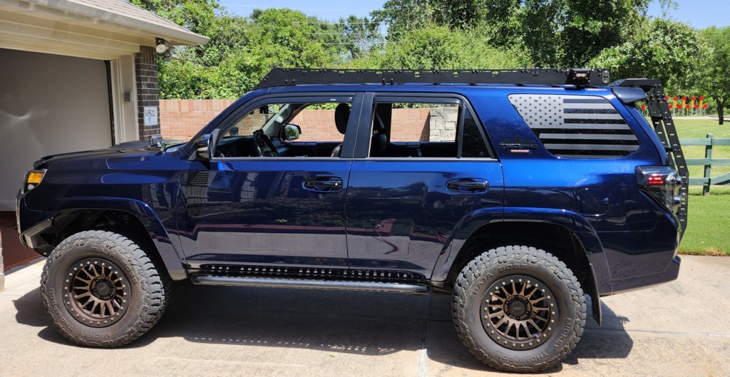

  13. May 13, 2025 at 6:44 PM
    1,192
    285s. Not going back. In fact, I am going to 34s soon. All in with the BMC etc. No regrets.
    At 20psi during an outing in AZ.
