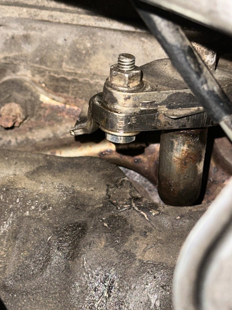

Spark plug change.. secondary Air Injection Tube stud broke

    Well, persistence prevails. Cut the stud flat with the flange, and drilled it out with a set of hex bits from Amazon (superb quality!) and using a 12” hex bit extension. Could have probably re-taped the threads but opted for just a bolt and nylon lock washer (replaced the one after taking the photo). Drilled it out to 1/4” and then installed a M6x30 bolt with washer and lock nut.

    Good job! But I don’t think you should be using a nylon locking hardware. It will probably melt due to high exhaust temperatures. I’m not sure where you would source it but, in aviation, there are stainless lock nuts available that do not rely on a nylon insert. These are used on engines and other areas that are exposed to high temperatures.

    Well done sir. I concur, nyloc is not the best on your application.

    @TheSponge if you don't have a source for an aviation grade steel self-locking nut, let me know. It won't be metric threads though, so you will need a 1/4-28 threads per inch bolt to go with the nut.

    Don’t have access to an aviation store. Googled this aviation nut to see what it looks like but the results are all over - anyone have a photo of which nut is being referred to here?
    Worst case I’ll just install the nut I had on there lol. I also had a M6 but that had a built in washer but it spun on the nut itself.. not quite sure what those are for!?

    This is what it looks like. Top of the nut is ovalized to put a squeeze on the threads. Aircraft hardware in North America is 99% in debt slavery units, not metric, so you'll need a 1/4" bolt: https://skygeek.com/mil-std-ms21042-4-nut.html Better off just using a regular hex nut and lock washer:

    I also agree nylon locknuts are going to melt. The split washer idea is better. Your local hardware store should have a decent selection of stainless bolts, nuts, and split washers. Using stainless hardware would be ideal given the fact it’s a high heat application (even if the hardware store variety is not the best stainless alloy).

    I’ll look at installing a split washer and regular nut. Worst case the nylon stuff melts, at least now if it were to snap, that bolt is not threaded into the flange and will just fall out from below. I did coat with copper antiseize. Better than using one of those clamp solutions!
    For those asking on the parts,
    These are the bits I used - https://a.co/d/cRzuraA
    12” Hex Extension. I’m returning the extension as it had issues holding the bit, so if your Canada don’t buy the one from Princess Auto. But the 12” was perfect as it put the drill near the brake fluid reservoir and the angle was also perfect to drill into the flange. https://www.princessauto.com/en/12-...020&gbraid=0AAAAADu8PlP4RX5kBoE5-vEIxkhCMbHCl
