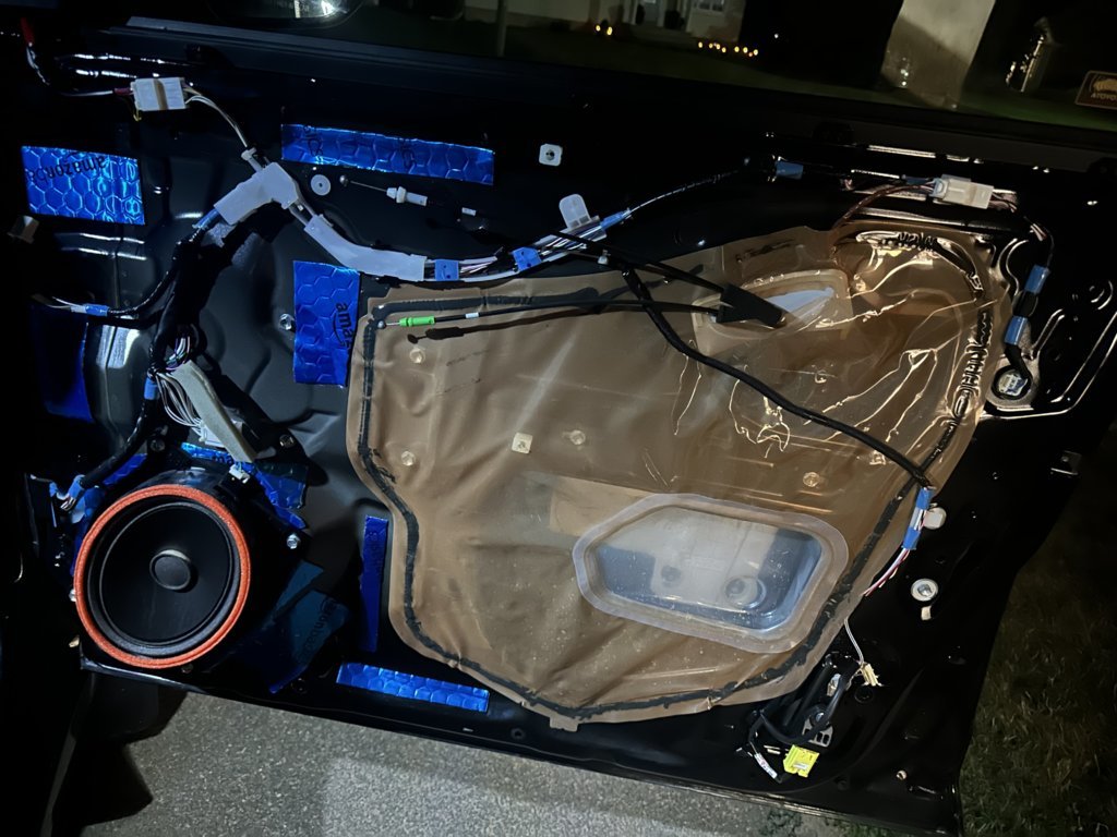

    Most say 50-60% of coverage. I got that on the inside skin, are there benefits on the exterior skin (facing the door card)? I added a few slivers (blue) but do I REALYY need more?

    #78
    5,686
    Are you rolling it out?
    TheSponge[QUOTED] likes this.

    Yes using a couple of rollers that I picked up. Hard to tell but there is 3x 9.8x15.7” sheets inside the door too - you can see a bit passed the Vapor barrier that was reinstalled at that point

    #80
    5,686
    Depends on what effect you're going for. Total isolation, then more needed. If you just want music rattle to stop you're good.

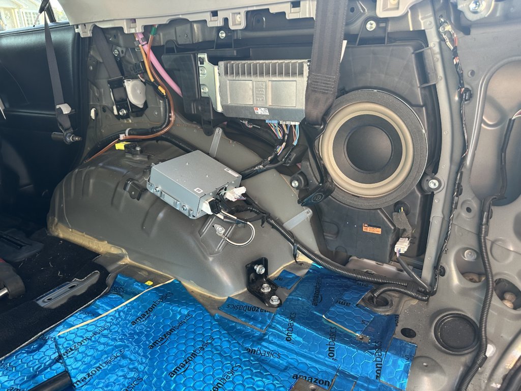

    3/8s Milwaukee ratchet makes easy work. Took about 45min to remove the rear stuff, not going to pull the side interior plastic due to the fact that the 2nd row seat belt ties into the wheel well and it appears the protective cap for it is gone so debris has been hitting the other side of the bolt - would suck if this strips. I can pry the interior plastic piece far enough to get some of the sound deadening on the wheel well area etc.
    Will need to go find torque values for all bolts removed.

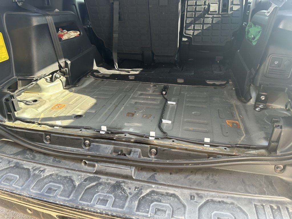

    Floor and left side is done. For the right side I pulled the plastic off, way more stuff in there so I couldn’t get to areas as easy to apply the deadening.
    What else do I upgrade while I’m in there now lol!

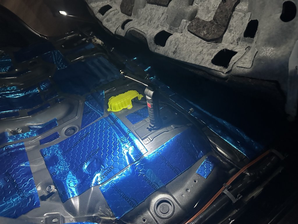

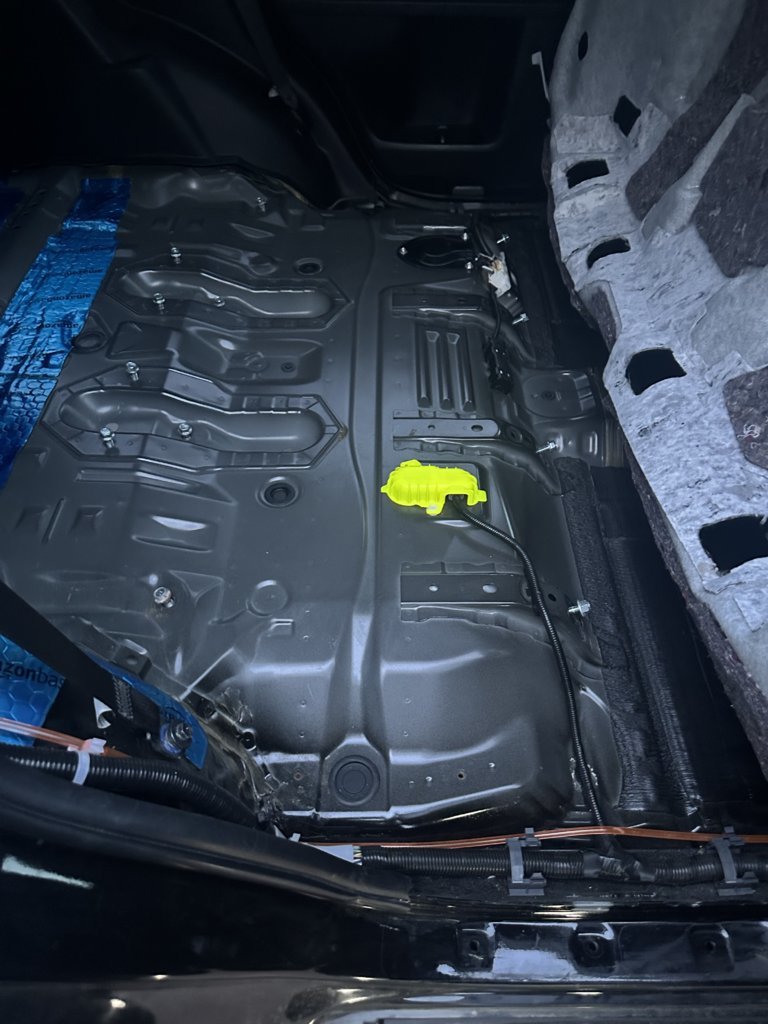

    Well, the next row was in order. Man are those 2nd row seats heavy on the limited! By pulling the carpet from under the b pillar a bit I was able to fold it high enough to basically get a sheet and a half on each 2nd row footwell.
    I will admit, I’ve been driving around with the 3rd row all done and not fully reinstalled and the 4Runner sounds way more solid and not hollow. Curious once all the carpet/seats are put back the difference.
    At this rate, I feel like I need to pull the front seats and do that area as well. If I pull the front passenger seat, and run the car is it going to throw an airbag light? And can techstream clear those or is it a more specialized tool?
