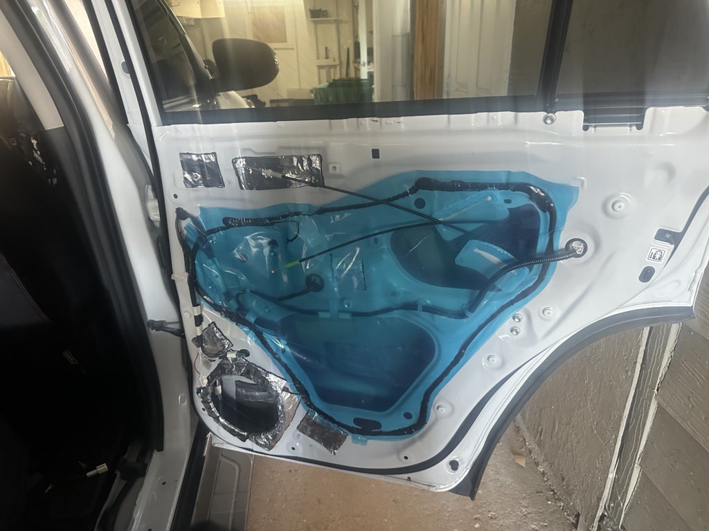

    I did this recently and didn’t go overboard… just a few sections on inside of door panel and exterior door panel. I may do more if I notice more vibration after new speakers are in. I used Resonix

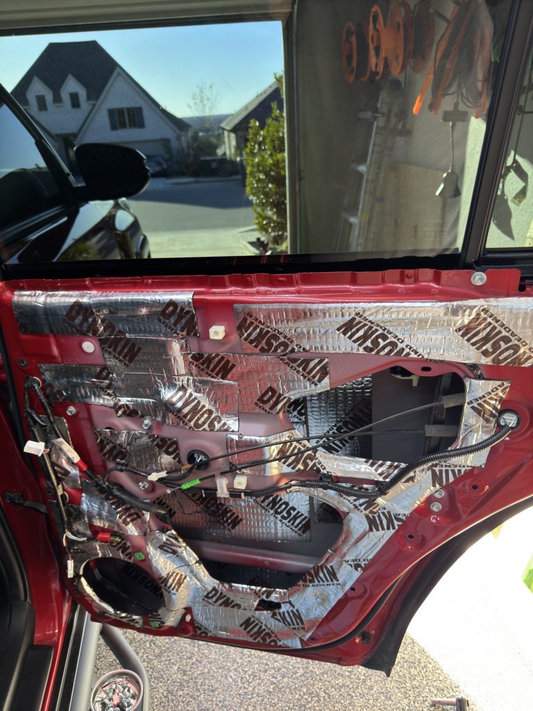

    Why did you only cover the 4-5 areas of that door? Is there some specific reason? I’m curious what the 4-5 strips you got there actually do?

    To stop speaker vibration and resonance.

    I didn't go crazy with it because I didn't want to add too much weight to the door. I will say that the door seems more solid now with what I did (2 sheets per front door, 1.75 sheets per rear door). I am going to listen to my stereo and possibly add more, if I feel they need it.
    For what it's worth, I only did this because I upgraded my doors speakers and added an amp (more power that could cause vibration). I also never sound deadened a door before, but I did do an old Honda Civic hatchback area and regretted it because I put too much down.

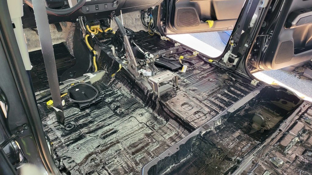

    When i did my taco, it was well worth covering every inch. But just did the doors on T4R.

    You may start rust. Make sure you wash along the bottom of your doors. Those drains for water get clogged and it rusts along the seam. They are exposed to outside elements outside the weather stripping along the rocker panel. I would probably stick it to the back of the door panels on the dry inside of the door. That's why you buy a Lexus. Everything is a price point with Toyota and they have a lot now.
  12. Aug 8, 2025 at 11:23 AM
    3,603
    Very nice application/install on that set up.
    Steely123[QUOTED] likes this.

    Gracias senor. The taco was TONS easier to pull apart in one session. The 4R will have to be done in sections. I replaced the speakers, so did the doors. I took out the 3rd row seats so did the rear floor. When i change the headliner will do the roof, etc.

    Just a lot of bolts. Easy process though. What i can suggest to make it easier is to remove the front bolts first. I personally found it a bit frustrating to put the seat up and down again after taking out the rear bolts with them flopping around unhinged.

    for the 4R I also used Amazon brand and the Siless foam. The foam makes a world of difference, just can't use it on the doors. The cards wont fit back on.

    Closed cell foam is the stuff you see from the manufacturer. The stuff that gets brittle and flakes, etc. But when used on the floor and ceiling, it's kinda a padding also. So i put that on top of the butyl sound deadening. For 2 layers of noise protection and cushion under the carpet. Overkill...... Maybe.
