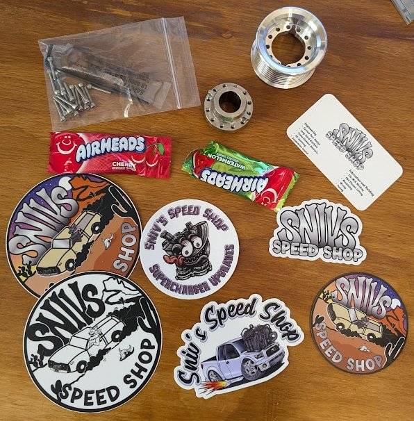

    I have an aerospace engineering background (and full time job) and decided to tackle making my own pulley--well designing and out sourcing the machining. Additionally, the issue with the Tundra (and likewise the 4Runner and some others) supercharger is the pulley is pressed on, so there's no way to quickly change the size. It's a half day ordeal to change the pulley once! More modern superchargers went away from this methodology and have a flange and bolt pattern the pulleys bolt to, and I wanted something similar for my Tundra so I came up with my modular hub design.
    There was someone else (ViktorG on the Tundras.com forum) that had run a custom 2.0" pulley on his truck, so I knew the supercharger could handle that and I wanted to be able to at least match, if not exceed how small his went, so I designed the press on hub to be able to accommodate a 2.0" pulley (and a little bit smaller....). This was a drastic departure from the stock 2.45" pulley, and the market offerings of 2.3".
    My modular hub is a bit different than other ones you might see on a factory setup, because the pulley on the Magnuson 1900 (and 1320 for the 4Runner) is so small, the hub has to be very small. Most hub/flange style mounts use an array of large bolts, but that flat out wouldn't fit with my setup, plus loading bolts in shear is generally frowned upon. To fix that, I added two shear lugs or "ears" that index into the pulley and transfer torque, allowing the bolts to be very small and just hold the pulley from sliding forward off the hub. I use 12x 4-40s so there is a lot of redundancy with the fasteners, if one or even half of them fail, the pulley and hub will function fine. The pulley hub also has a tapered front so if a really tight belt is being installed, it can be wrapped around the pulley and the pulley can be slid onto the hub easily and then bolted down instead of fighting the belt to slide over the ribs.
    The hub is made from 304 stainless and is a press fit like the factory pulley, and then the slide on pulley itself is made from 7075-T6 aluminum--again advantageous from a weight perspective compared to legacy all steel press on pulleys (but lets be real, we're talking maybe 100 grams).

    I ended up selling a lot more 4Runner pullies than I expected, so placed another order with the machine shop and it showed up today!
    The 2.0" pulleys were also successful in testing, and I decided there should be enough material to move them from 304 stainless to 7075 aluminum like the other pulleys. So this batch of parts included the first 2.0" aluminum pulleys!
    I now have a pretty big assortment stocked up, including a bunch of 2.2" pulleys which I had failed to order the first time around and quite a few people wanted since the 2.2" is the natural first step down from a stock pulley (2.35").
